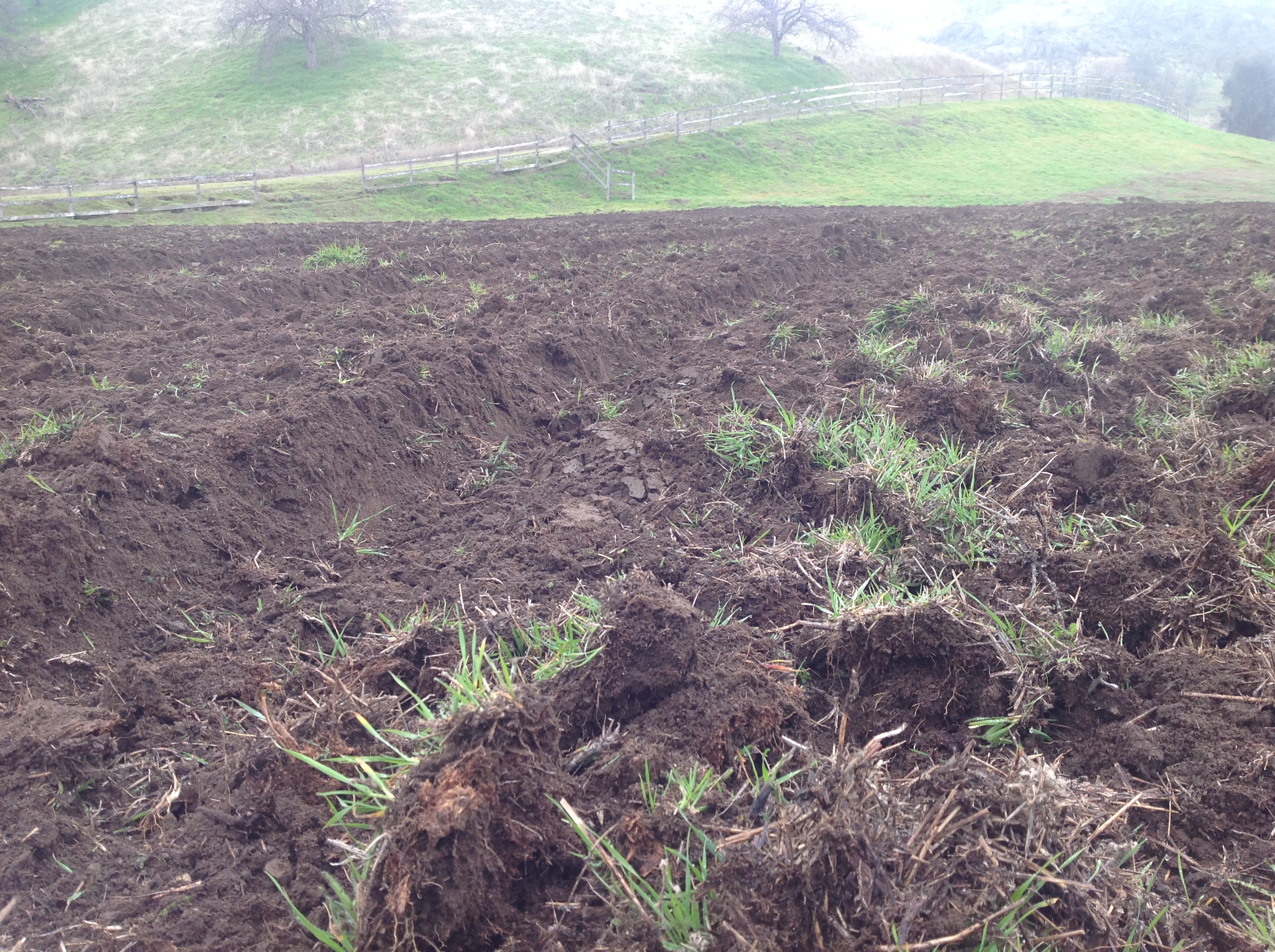

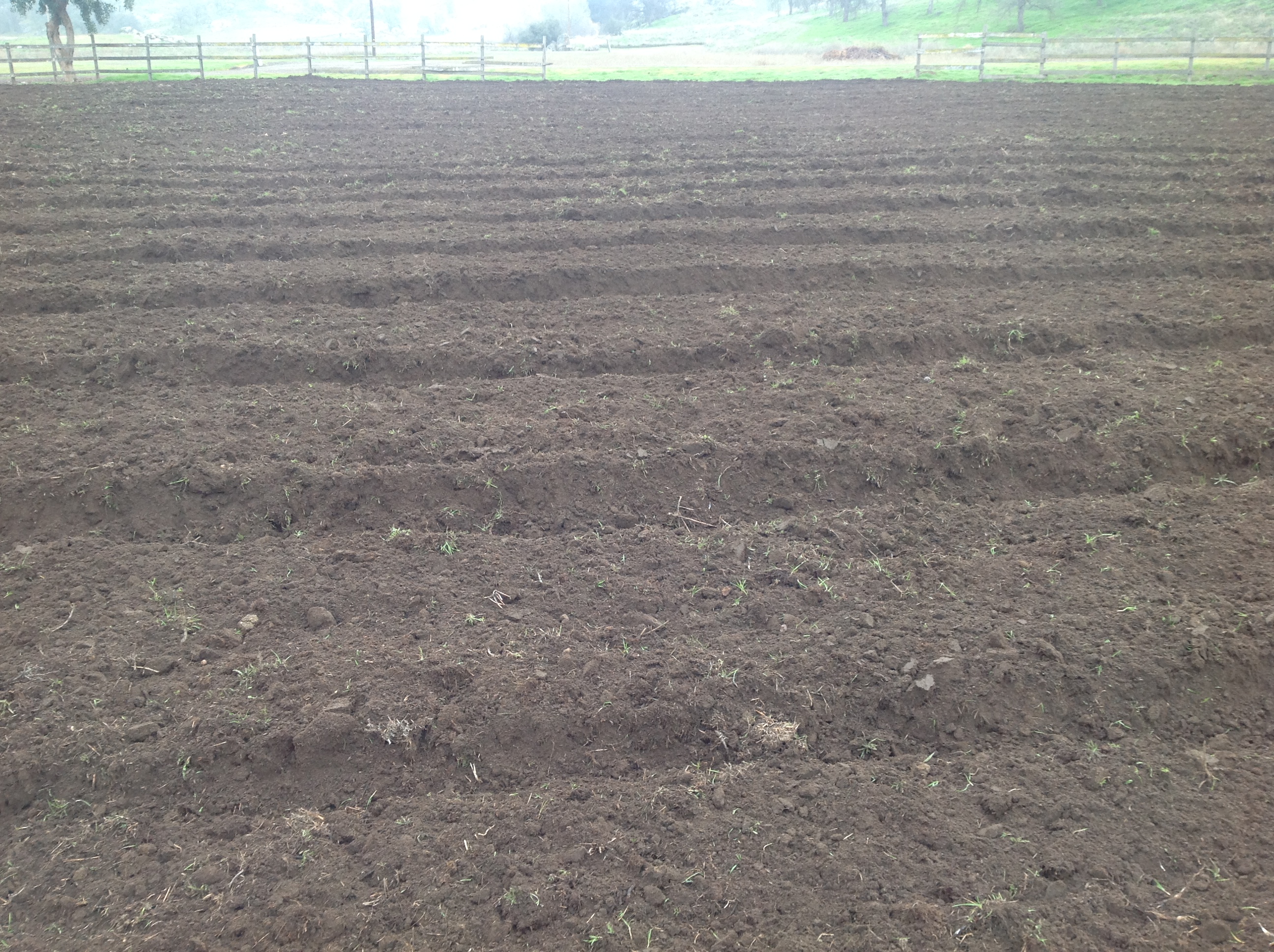

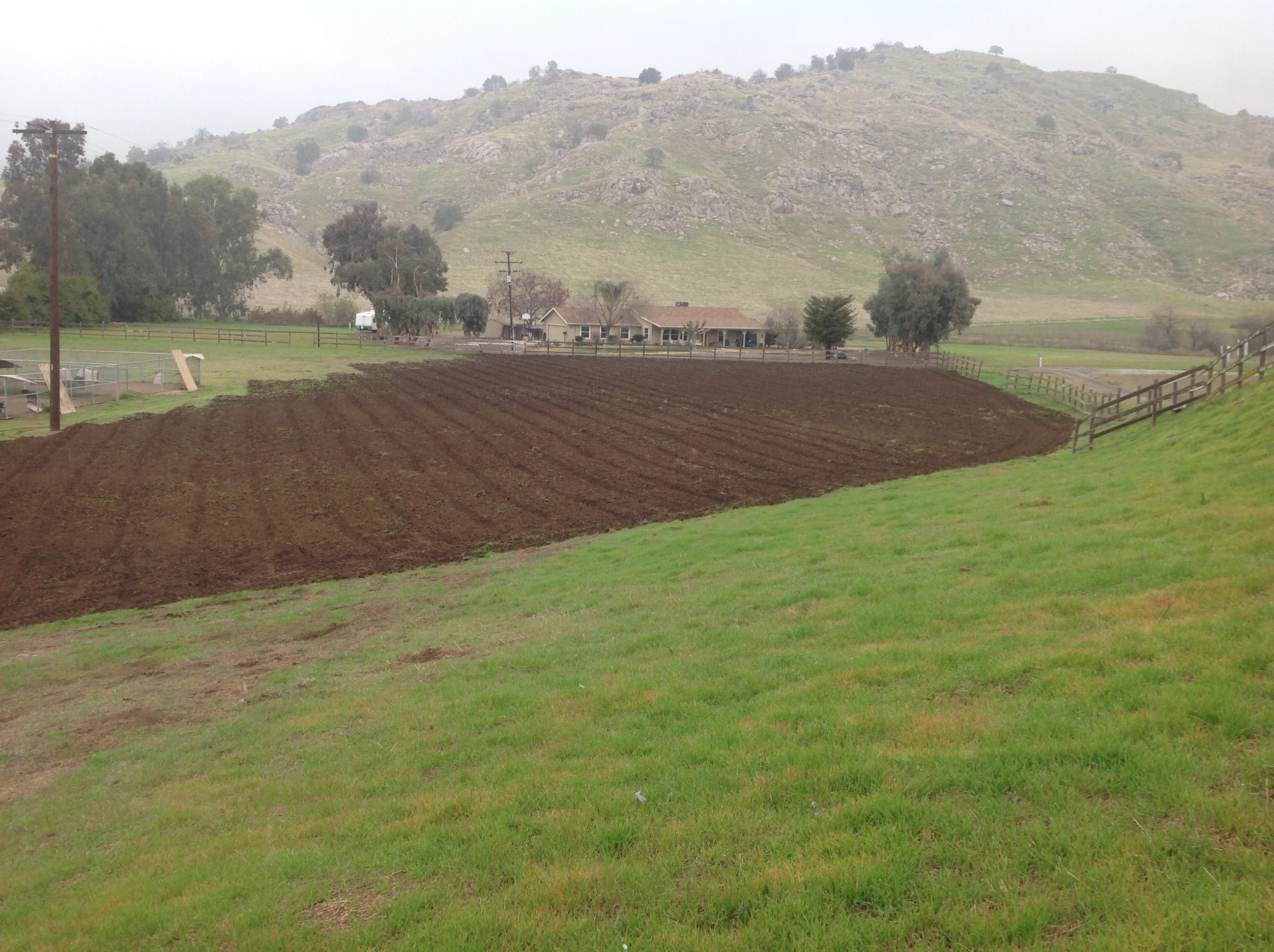

Hello, it is January 8th here in central California and the grass and weeds are starting to grow, this in my first time using a disc, I disced the field length wise and then a second pass vertical, I'm wondering why there is such deep grooves 12" deep and then shallow groves, is this normal for a disc or is there an adjustment to make the dirt more even. The dirt is damp from the winter.
/ Using a Disc for the first time #2
It will pulverize better after it dries out more. I usually make a few passes at slow speed, then a few more at higher speed to really break it up nicely.
/ Using a Disc for the first time #3
It looks fairly level but you could shorten up the top link a bit to take the back gangs out of the ground a bit. This will leave less of a furrow. When using a disc, make your first pass then straddle the furrows to make the next pass.
If the ground is humped a bit in the middle, the rear gangs are too deep-shorten the top link. If you have a bit of a depression in the center, lengthen the top link in order for the rear gangs to pull more dirt. You will always have a bit of a furrow. Sometimes disks will have a smaller blade on the outer gang on the back so it doesn't pull in as much dirt thus making a deep furrow.
I think you can minimize the furrow by just shortening the top link a bit.

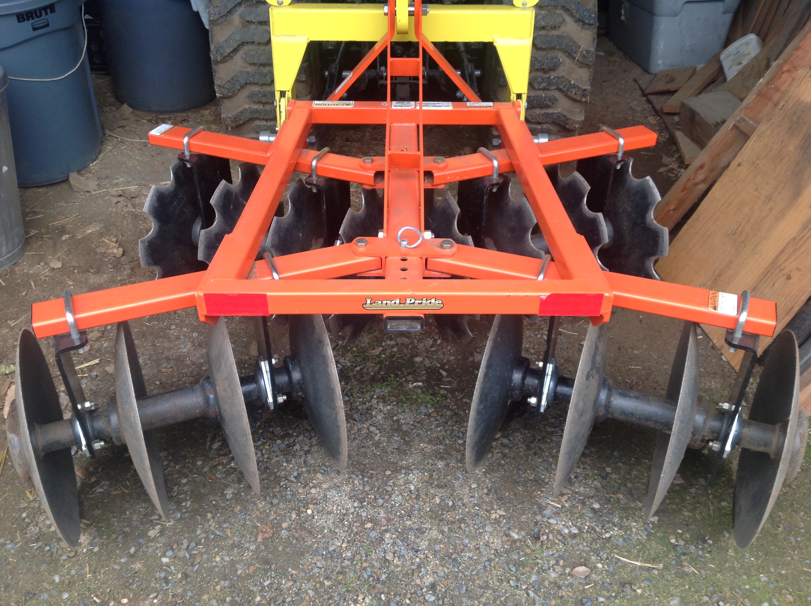

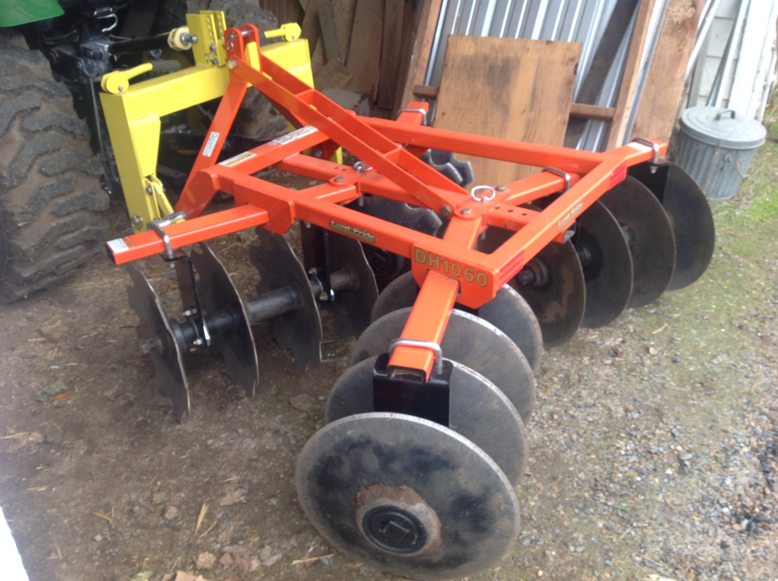

You can also pull the pin on the back gang and move it back one hole so the back gangs aren't as aggressive of a cut.
/ Using a Disc for the first time #5
The front gangs are the cutting gangs and should be set to cut the depth you want, usually one or two pin settings more aggressively than the rear gangs. (In PHOTO #1 "flat" set front gangs are rolling over the ground, not cutting.)
The rear gangs smooth. The rear gangs should be set two pin settings "flatter" than front gangs for the first pass, then flatter yet as you make successive passes.
Make secondary passes at a forty-five degree angle, not at ninety degree angle. This because of gang angles.
(Basically, you have the Disc Harrow in PHOTO #1 adjusted backwards so there is no smoothing.)
(Notched, rather than smooth pans on the rear gang would chop the clods a little finer during the first pass.)
LOVELY DIRT.
YES.
The furrow is from outer pan on each side, where there is no adjacent pan to form a gate for dirt. A small pan on the outside moves less dirt, therefore furrow is reduced when a small outer pan is fitted. Small outer pans are mostly fitted to WIDE Disc Harrows. Your 60" wide Disc Harrow is correctly outfitted with all identical diameter pans.

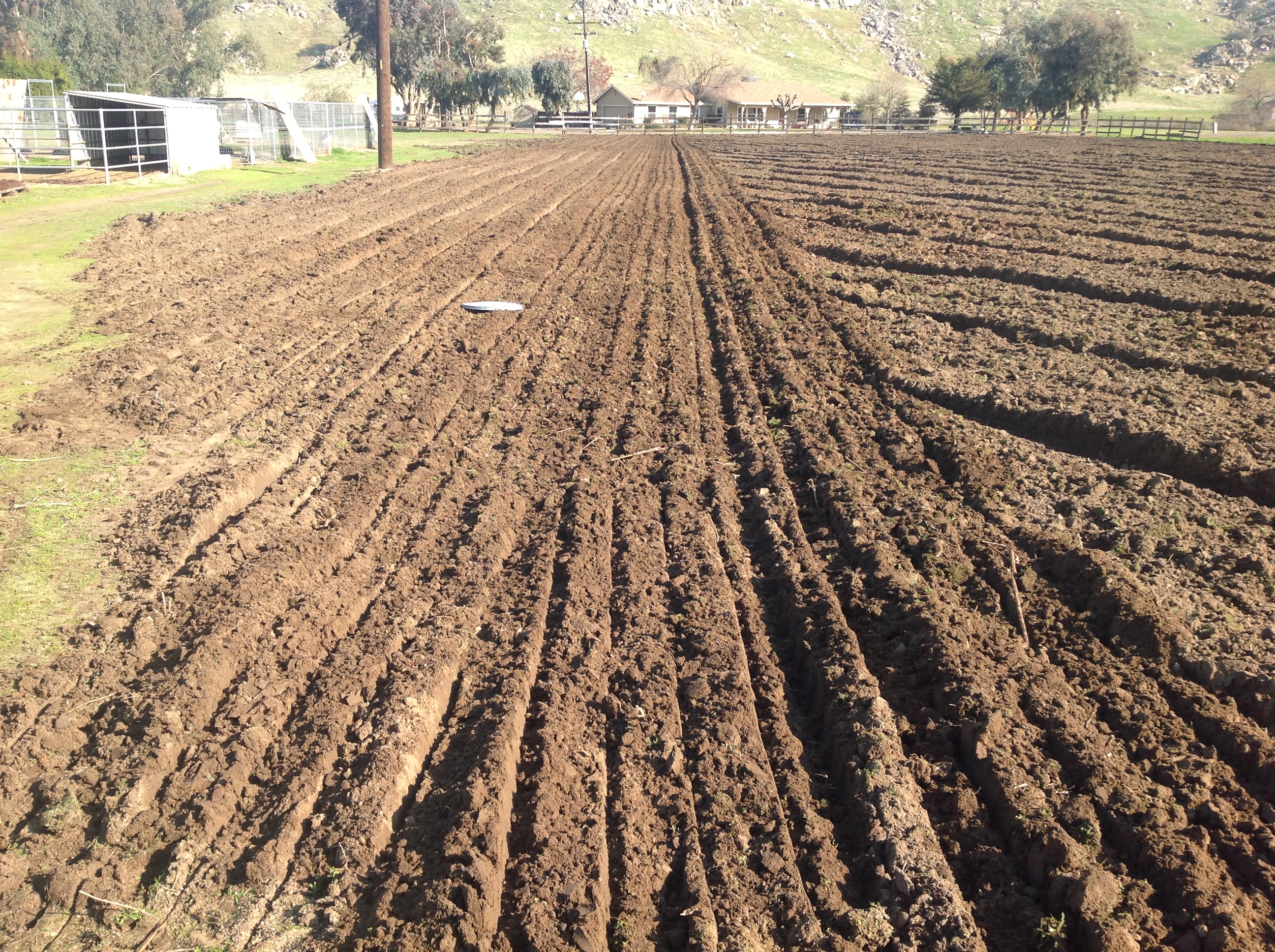

I read all your guys info and took the info out to the Tractor today to see what I could do, the first three passes are with the front disc touching the ground and the rear about 2" above the ground, I changed the back angle of the disc two holes difference from the front, and I'm letting the disc float through all the test passes, and I am straddling each furrow as instructed.

Second two passes I only moved the rear discs one hole opposite from the front instead of two, the trash can lid marks the new passes to the right of the lid.

The third set of passes I adjusted the top link so the rear disc was 1" off the ground and you can see the adjustment to the gangs in the photo. It seems to be getting smoother.

I then put the rear disc straight and that got worse

So I went back to this gang set up and did a bunch of passes, the set up is still 1" rear disc off the ground. Is this as good as it gets or do you have other suggestions.
