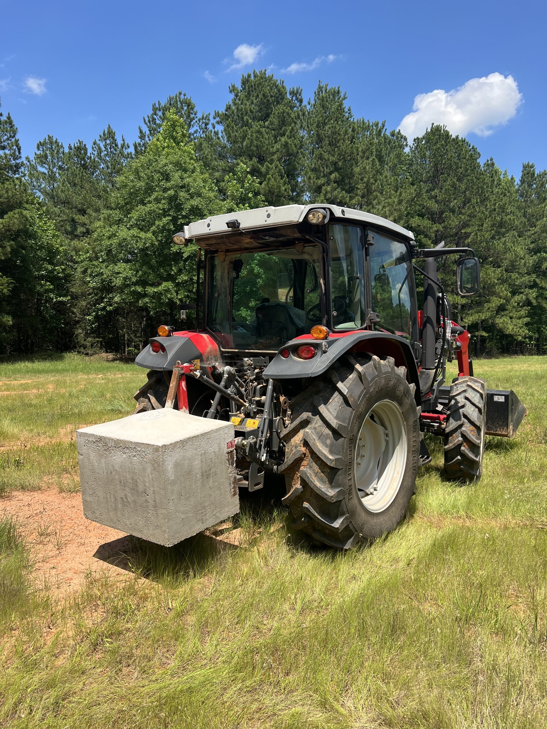

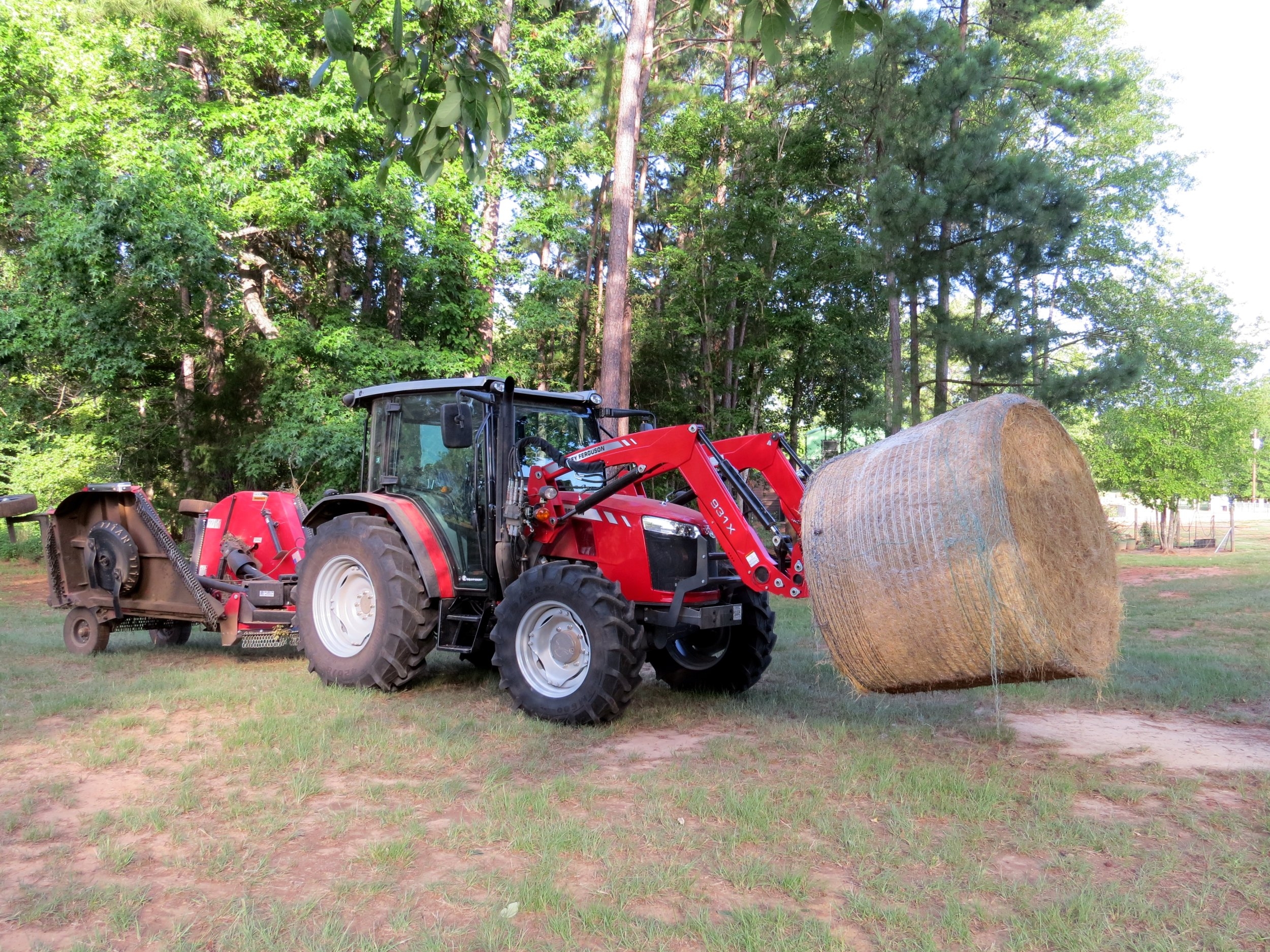

I've had my cabbed tractor almost two years now. Next month will be exactly two years. I ordered it in November when they had a deal that was too good to pass up, and it took that long to get it. I financed $55,600 for it over 7 years at zero percent interest through AGCO. Just five more years of $662 a month until it's paid for.
It's a Massey Ferguson 4707 4x4 with the Deluxe Cab. It has a six speed transmission with a high and low range for total of 12 gearing choices. It has a shuttle shift for going forward and reverse. Air seat, buddy seat, and a very good AC system. They came out with a brand new AC System in 2022 that solved all the issues with the older tractors. On mine, it can be extremely humid and hot out here in East Texas in the Summer, and I never have any trouble with keeping the cab cool. In the Spring, when temps are only 80 degrees out and the humidity is low, it can get too cold in there with the AC on the lowest setting. I just close all the vents except two of them and that seems to work for me. This is very rare, but it has happened.
One of the main reasons for the 4707 is that it doesn't use any Exhaust Fluid, and it does not Regen. My goal was to find the biggest tractor that I could that didn't use DEF. NH and Case don't either, and I think a few other brands don't.
Comparing Massey to the other brands, I felt that I got a heavier, more industrial tractor with more features and less money.
So far my only issue has been the electric clutch. It works, but it's not smooth. Their are a lot of YouTube videos out there on how to calibrate it, and they say it makes it a lot better when you do that, but so far, I haven't bothered to try. The clutch works, but it's not smooth. Instead of using the clutch, I use the shuttle shift. It also works the clutch and is a lot smoother then the foot pedal.
For moving dirt, I felt it was kind of tippy when going downhill. I built a 1,600 pound concrete rear ballast for it and now I'm very comfortable going downhill with a bucket full of dirt. My traction and overall ride has improved to. I probably should of added wheel weights when I bought it, that was a mistake on my part.
I also think it's one of the nicest looking tractors out there!!

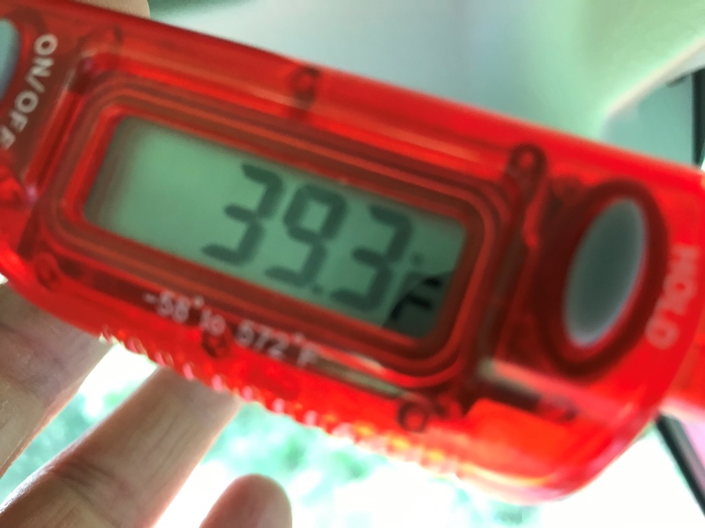

I'm the same vintage as you. On my 5th tractor now. It's the first one with factory cab that has factory heat and A/C. Had a few open stations and built a nice heated cab for an L3200 around 2012. It was wonderful to have heat and with the the doors off / fan on in hot weather it was OK. Then in 2018 I bought a used L4240HSTC. Absolutely thrilled with it. It's a real treat to be able to hop on the tractor to push snow or mow the yard without needing to change clothes either before or after. On a hot and dusty day I can step out of the tractor just as fresh as I was before starting to mow. To address some of your questions:
Trim low branches for clearance if you must.
I bought a clean used tractor to avoid the most recent DPF, DEF etc. Tier-whatever it is by now. It was a little more money than an open station would have been. Haven't priced new, but I'd spring for the extra regardless.
Swapping implements is about the same for me, and I am a loner with the tractor.. The telescoping lift arms on the cabbed tractor help. The rear window swings up so I can still get a good view of the lift arms and implement.
I haven't been frozen out of the cab on the hottest days, but it's always been cool enough So far I haven't taken a reading of the temp inside the cab. There's a picture below of my thermometer showing a 39.3°F reading on the A/C discharge vent.
There's more than enough heat in Winter. It's not hard to make it too hot even when I do plowing at night. The cab is like a solar panel in daytime to the extent I often run the A/C in Winter with the sun shining.
Not sure how old mine is, but I did replace an expansion valve on the A/C a couple years ago. It wasn't too difficult or expensive (borrowed a vacuum pump). I'm thinking the valve and fix was under $50 (DIY).

I added 1,600 pound rear ballast to mine so I could move dirt with the loader. It was too tippy without it. Now it’s rock solid
