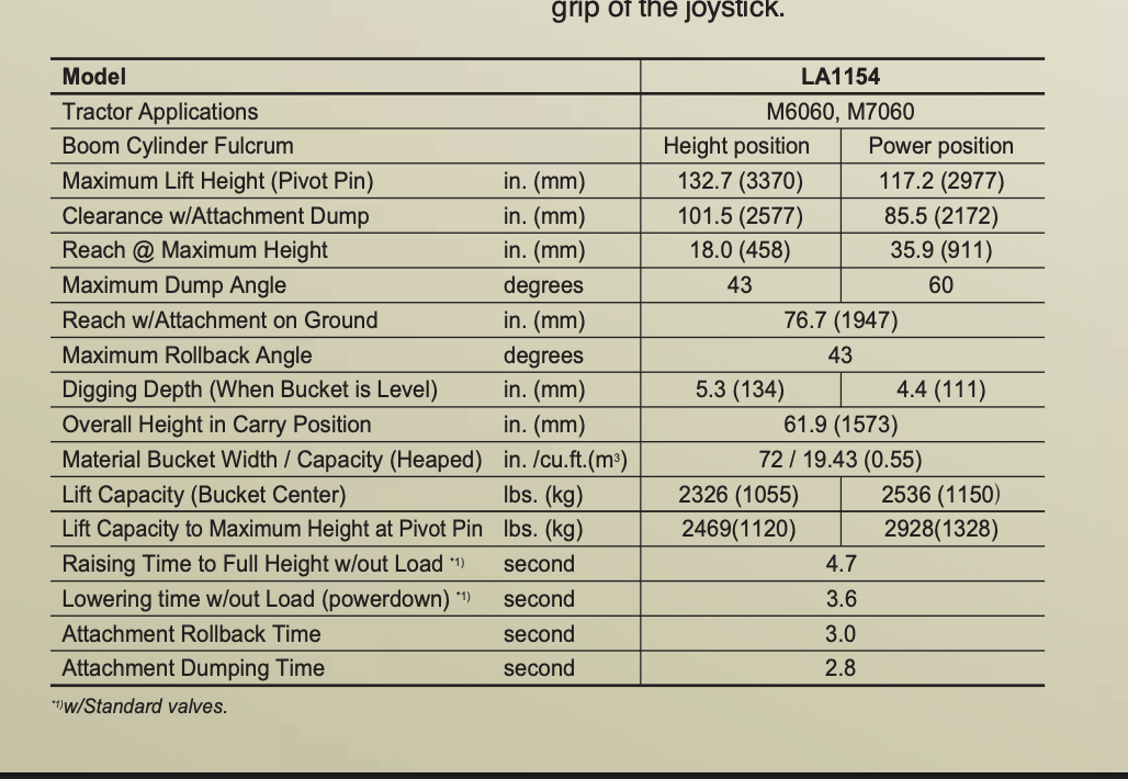

I just built a retaining wall with concrete v-blocks that weigh 3600 pounds each with my M7060, the wall is 28 full size blocks and is stacked one layer. It struggled, and surely pushed the tractor to its limits but was totally doable. I was surprised that it was able to do it.. I used no counterweight and I have cast centers and radials.
I'm not saying I don't believe this. But I'd love to see a photo for proof. Your 3pt isn't even rated to lift that much and it's about 1000 lbs more than the loader is rated for. My neighbor has one of these, and he sure can't lift anything close to 3600lbs with it. He tops out about 2-2200.

I can take a pic of the wall, or buy a block to bring home and show you. I had to have the curl fully retracted, and I hung a chain on the backside of my hay spear frame. It was barely able to do but it I was able to set all 28 blocks.
The Kubota M7060 tractor has a breakout force of 5355 lbs, I imagine this is what allowed me to do it.

I've never messed with it like that, and I've also never lifted anything with his while having a good counter weight, which I know makes a difference! Impressive, and I'll have to keep it in mind if he runs into something heavy in the future!

I wasn't able to find a spec showing a breakout force of over 5000lbs for an 1154 loader. I did find a spec showing it was just over 4000. But in having that loader I don't believe that to be accurate unless it's at the pins. It is able to lift a lot at the pin as I've lifted heavy things tied to the bale fork frame.
