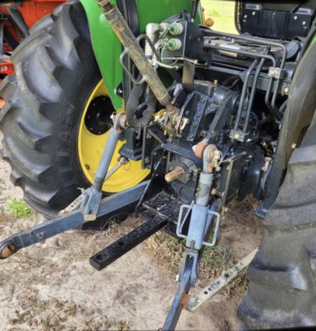

Here’s a few pics.
I know anything can happen to any equipment regardless as to how it’s been treated, or maintained.
But this unit if appearance says anything should have a leg up on “not being abused”
If you look closely at pic #3,. the 3pt hitch area, the inner rim and wheel hub looks like new.
Don't think it's ever seen mud.
