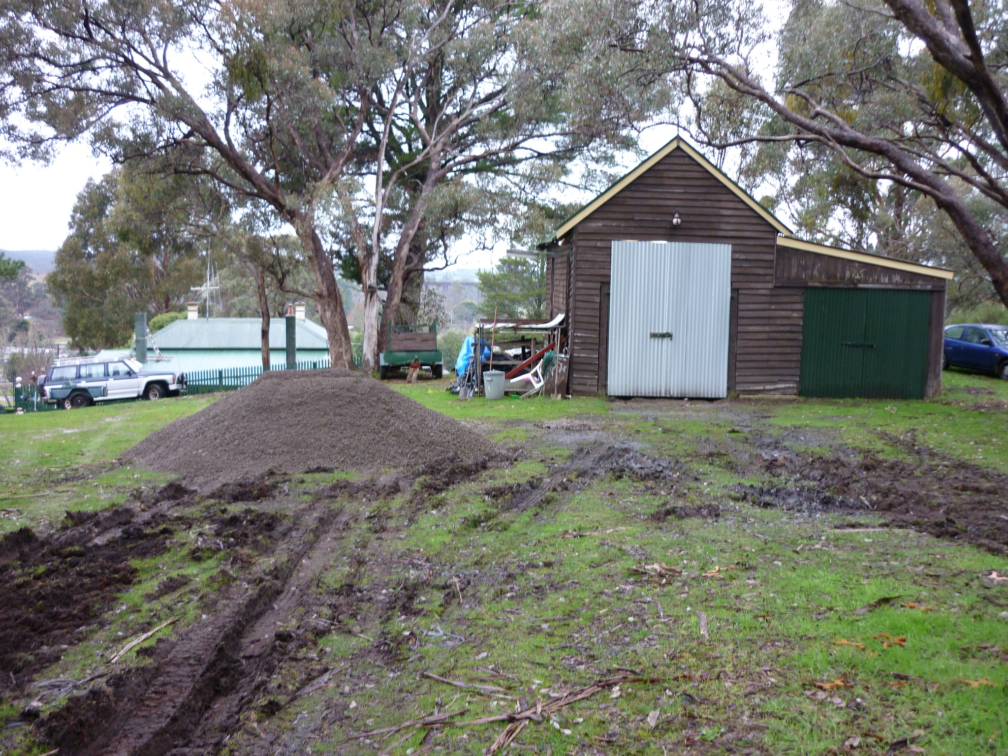

Hi guys great to find this web site .
I apologies in advance over this box blade question as I am sure this has been asked previously.
I can find alots of utubes and examples of the use of a box blade on nice smooth level land or a driveway but what about the more difficult uneven, ditched and or sloping land.
My project was to open up a areas directly in front on my barn so during the wet session the water which ran towards the front of the barn would flow to the left and the right sides away from the barn to each side where the land sloped down hill.
By angling the box and dropping the rakers I found digging a slope to the left and right quite easy but when I tried to fill this area with scoria (20 mm gravel ) I found it quite difficult.
The main issue was that the area which the Tractor drives over in the early stages of the fill are lower and in even, running down hill.
So the question is how to do this sort of job effectively?
Should I drop loads of gravel move it around with my front bucket the use the box .
I thought the box blade would make it easy work .
Obviously I am quite inexperienced and appreciate all advise.
Thks. Marcus

3AAD444C-AEC8-44D9-B424-BA8F50D0EC9B.jpegThanks guys yes I’m finding that using any attachment on my tractor is a challenge due to sloping land when the tractor goes into a dip the attachment rises and of course it’s the opposite with an incline.
Almost every utube I watch is always using equipment on level land which is easy.
I think with regards the box blade on a slop I’ve dug the left and right sides in front of the barn then if I drag the fill down slope as the tractor is tracking the lower ground and the box is behind with fill it levels very unevenly.
I think the best way is to overfill the area with scoria then try and level the lot it’s seem easier to reduce the fill than to build up the levels.
Anyway I do thank you all for your suggestion. I will just practice more .

It would help if you post a pic of your actual box blade, specifically of the rear-facing blade - need to know if it's hinged or fixed, and if hinged does it have a way to LOCK it down.
Hitch - do you have hydraulic toplink and tilt? another close pic of the box blade on tractor, as close as you can get and still show the box AND hitch components.
All the above will make it easier for us to offer USEFUL suggestions (in addition to some already good ones :=) ...Steve

In looking at your picture you need to get rid of the grass/sod first and I would recommend some sort of filter fabric before placing the rock. Hope this helps.
