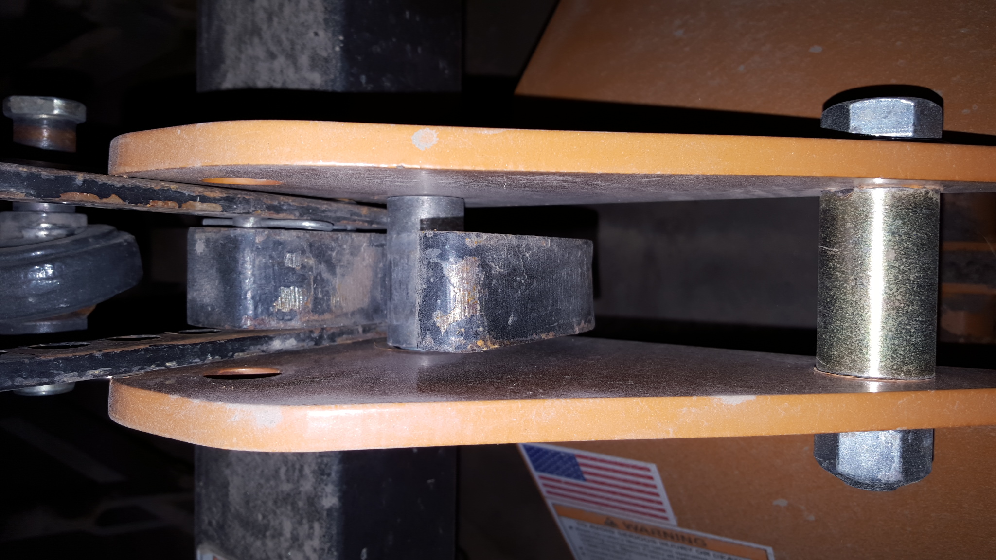

To me. looking at pivot top attachment point look like it going to hit the bolts that holds the hooks when top bar drops on to hook....
Not only does top mount look to high (cat 3) as you see it, it also looks like space between bottom of hook and bolts that hold hook to mount is two small to accept top attachment point of implement...
Dale

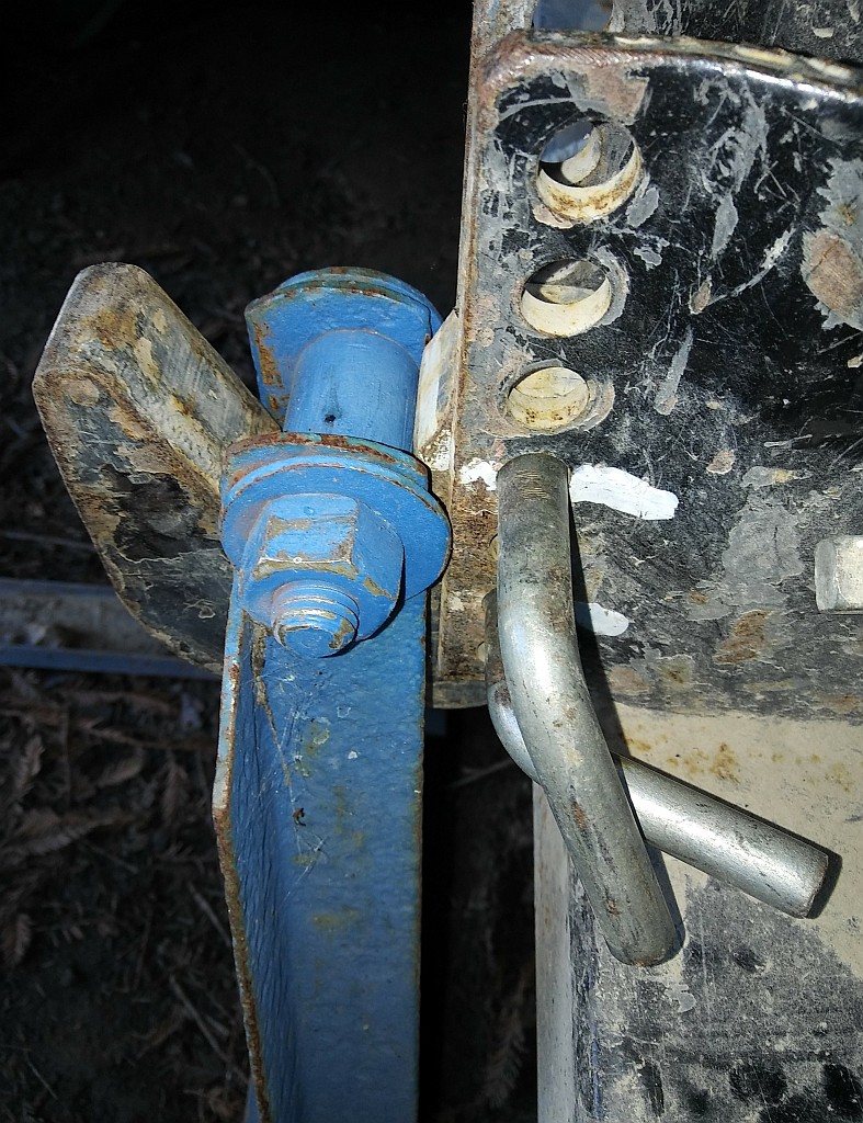

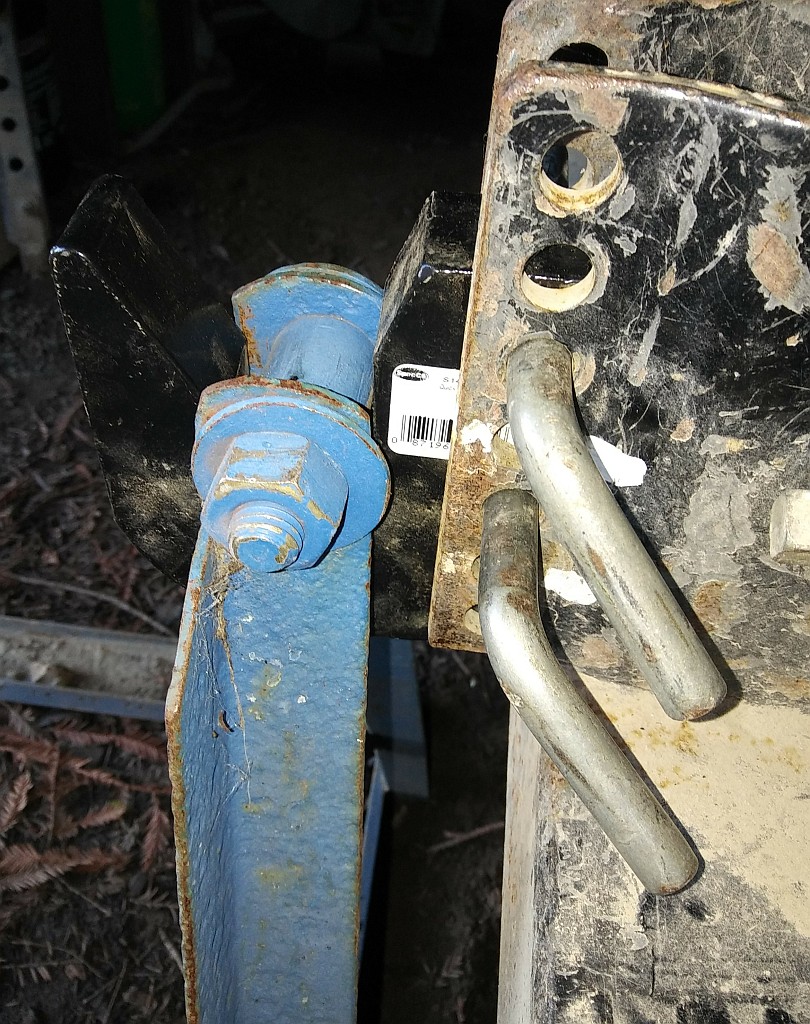

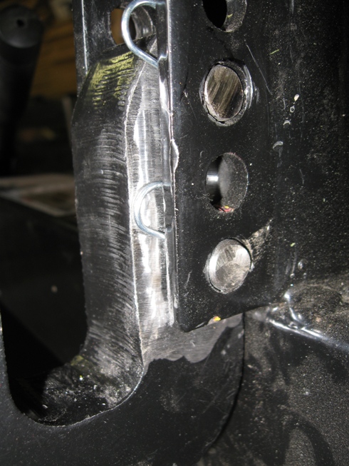

Dale's pic is a good one to show the clearance problem with the bolts that the after-market extended top hook is intended to address. However, even without switching to an aftermarket top hook, or welding an extension onto the back of the OEM top hook, there is an easy mod that solves the problem. And no welding required. With a hacksaw, cut the hex heads off the two bolts, then trim the bolts' shanks to length so that the ends are flush with the outer walls of the hitch's bracket.
Next drill a small hole through each bolt near one end so that a small hairpin clip can be inserted through it between the inside wall of the bracket and the top hook itself. Now there are not protruding parts of the bolts to interfere with the implement's top bracket if it needs to slide over them. See pics below of my mod of my original HF top hooks. In fact, the mod works so well that I use the same modified "pins" to secure my new extended top hooks, even though it isn't necessary so far with my current implements.
The conversion of the bolts to flush pins was an idea originally posted by Kennyd, another TBN member, several years ago. Ken now sells an extended aftermarket top hook of his own on his website.

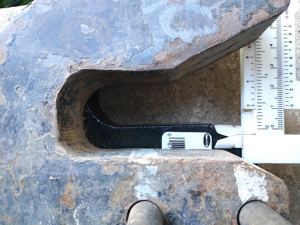

OK, I measured the bolts on the QH, they are 2 7/8. The gap in the mower upper attachment is 3 3/8 so ASSUMING they have and send a Cat 1 compliant "lifting arch" with the same "cheek" spacing, I don't need to modify anything. Who knows, WoodMaxx's 2 largest flails are Cat 2 which has the same spacing as Cat 1 so I don't know why they would even have an arch with a Cat 3 F1 dimension.
