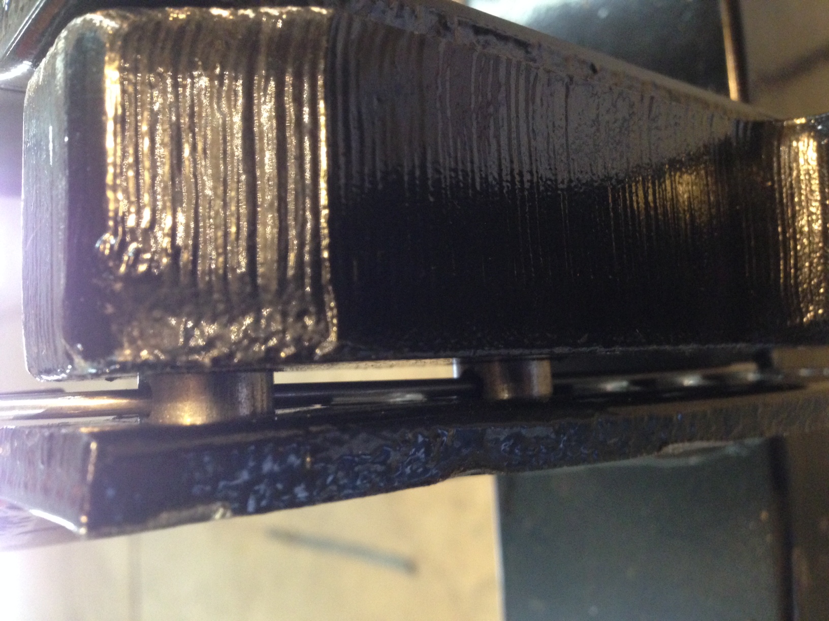

This is pretty minor mod but it solved a big problem for me. I found my Harbor Freight quick hitch wouldn't work with my Frontier box blade. The BB has the QH pin recessed between braces that are 2 inches apart. The bolts on the QH hook hit the frame and keep the hook from engaging the pin. It must work OK with the iHitch hook because it sticks out farther and isn't adjustable.
Another TBN member cut the bolts down and staked them into the QH. That wouldn't work for me because my wood splitter doesn't have a QH upper pin so I have to be able to reposition the hook.
I bought a pair of 1/2" hitch pins and cut them down just long enough to span the hook bracket. I also cut a screwdriver slot in one end. I picked up a couple of smaller spring pins and ground down the edge of the hook a little to add some gap between the hook and the bracket. After I put the hitch pins in and insert the spring pins, I use the screwdriver slot to rotate the hitch pins so the spring pins are fully in the gap and out of the way. This way, I can use the QH on the BB and still easily move the hook to a higher position.

Very cool solution.
I did something simular but used a short pin with an external snap ring, but once in it is a pain to remove.....

Looks like a good idea, solves your problem.
I'm the guy who staked them in place, cause I don't have a need to move the top hook, but if I ever need to move it I'll remember this mod.

Exactly. The lack of adjustability in the imatch bothered me. Maybe I should have bought a Speeco or something, but I probably would have had the same problem. A lot of work to save $150? I spent about $5 and 10 or 15 minutes on this fix. I'm expensive, but not that expensive. :thumbsup:

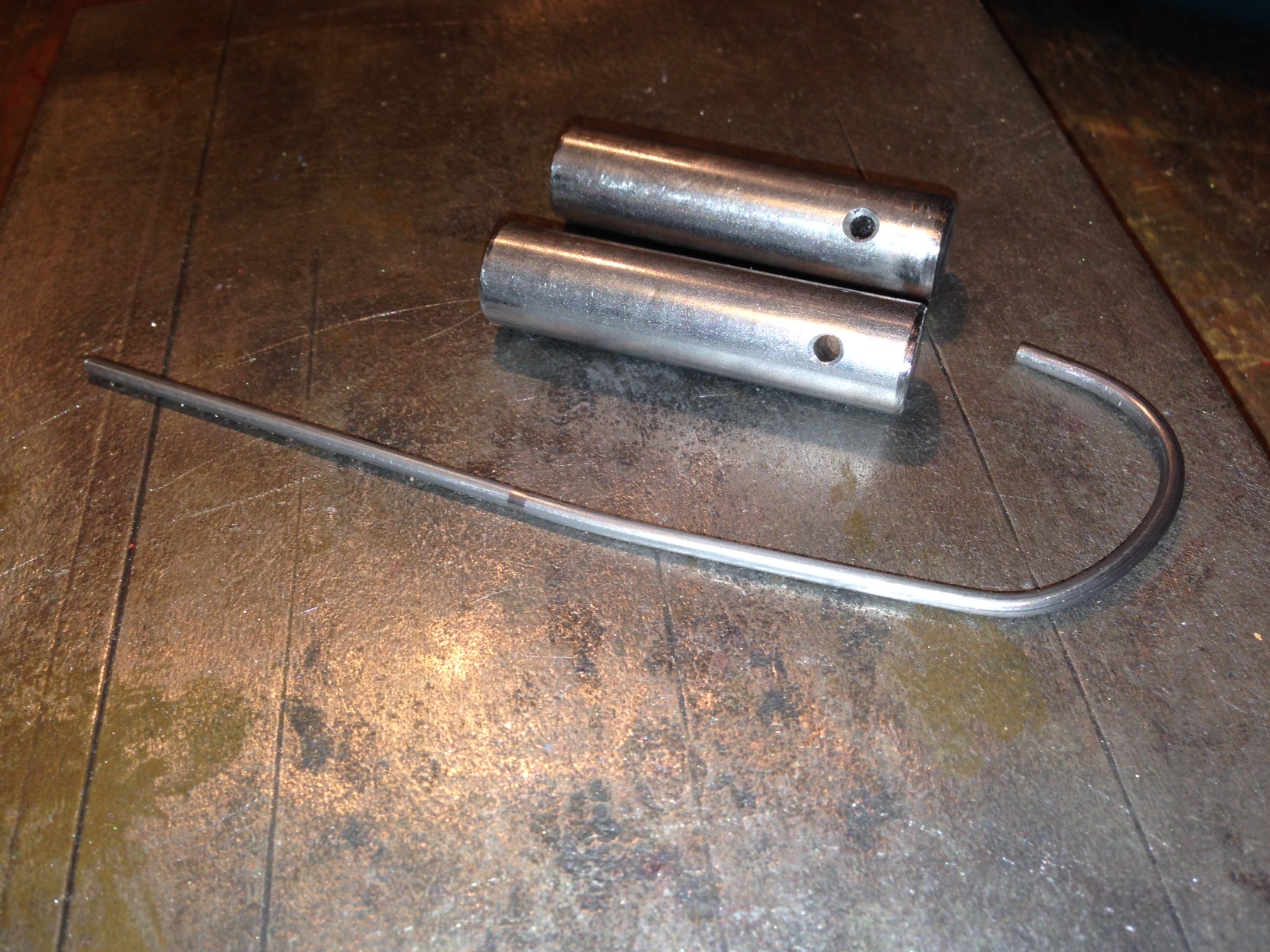

This is an old thread but big hat tip to KennyG.
Gave me the idea for a similar mod to my HF hitch.
I finally broke down and got one. It isn't real pretty but the price is right and it does the job. Except the bolts for the hook are in the way.
I replaced the bolts with two 1/2" pins made from mild steel bar. There is just enough room between the ears and the hook for 7/64" holes and a piece of 3/32 music wire. It has a handle bent on the end and a slight bend in the middle to maintain tension.

Correct, any type of external fastener wouldn't have worked with my Frontier box blade. It takes a bit more precision to line up with the top hook than any of my other implements. As discussed above, my wood splitter couldn't be modified to work with a fixed hook QH. The standard hook position interferes with the splitter beam - and you can imagine what kind of a mod that would take. A fixed hook may work for most people but I think a adjustable hook will allow easy adaptation of almost any attachment.
