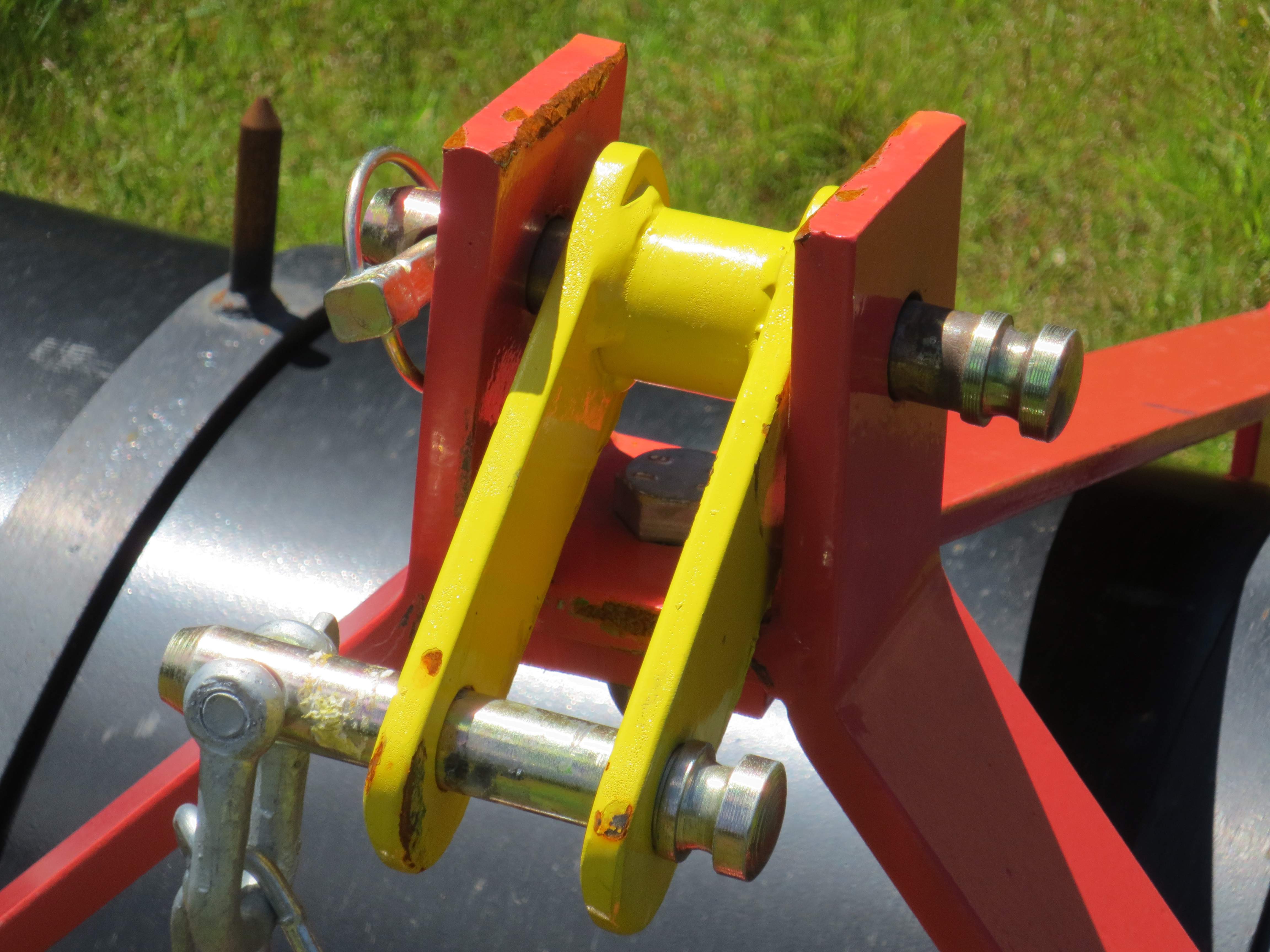

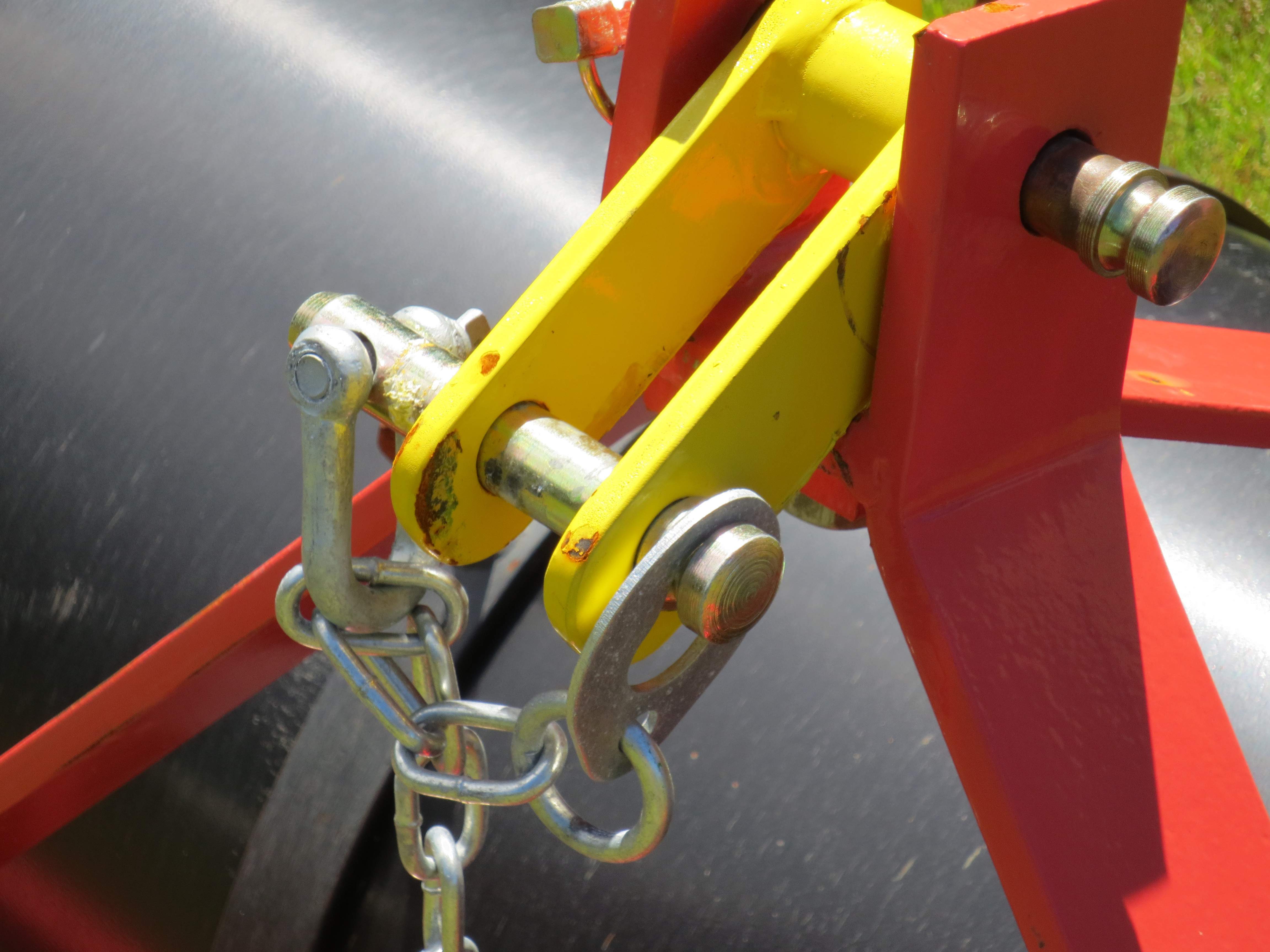

Sadly I have no ability to weld anything. No education in welding, no welder. As a newbie to tractors and tractor "things", I'm quite amazed at the lack of standardization in "standardized" NEW attachments including NEW quick hitches.
My JD iMatch is from 6 years ago, before the adjustable height top hook became the norm... anyway, I have a few Cat 1 implements that don't quite fit so I use an 'extender' to reach. I simply swap the extender between the infrequently used implements as required (ballast roller and landscape rake = both inexpensive Chinese manufactured)
To prevent the hook end from possibly coming out, I employ a gate chain as a 'curb chain' underneath.
