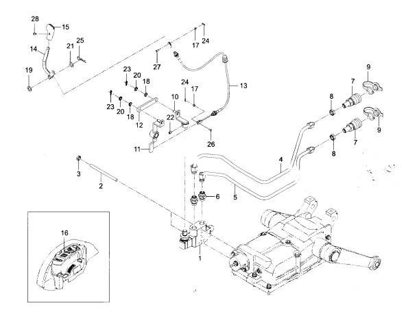

I bought the OEM kit from Kioti which basically allows to install an extra double acting valve assembly. My tractor came with one set of valves in the back. The installation involved taking off the valve cover from the OEM valve assembly, install longer bolts, and add a second double acting assembly (#1 in the schematic below) next to it. It is positioned just under the driver's seat, to the right. I attached the installation instructions that came with the manual as a pdf file. Slide 1 provides a quick overview of the system. Here's a screenshot, further details attached :
I can't see how just installing the remotes would affect the 3 pt hitch. It's pretty much a "fool" proof system, unless some trash got in and got stuck in the 3 pt valve (MLS valve) and it's causing the issues.
I can see the end round cap, could go two ways. Is it installed the right way? I think if installed the wrong way, you would have other issues.

If the hydraulics didn't drop before you fitted the additional slice(extra outlet) the problem could be in the additional slice. Some additional slices have a grub screw in them that either has to be either removed or shifted to another hole, this controls the oil flow, power beyond or return to tank.

Need some help getting to the root cause of my 3 point hitch dropping slowly and unintended.
Tractor : Kioti NS6010 Hydrostatic transmission, 60HP
Symptoms : 3 point hitch drops slowly when it is loaded with the weight of e.g. my flail mower. Over about a quarter mile of riding it will go from top position all way to dragging. This never happened during my first year of ownership.
Additional important data points :
  • As said, it happens slowly. When I engage the locking knob on the hitch control lever (when set in the highest position), I can prevent the hitch from dropping at all. This leads me to assume that not a lot of force/leakage is involved.
  • I installed a third function up-front. No leaks and no such spontaneous dropping on the FL.
  • I also installed a set of extra valves in the back. Upon activating them the first time I blew a small rubber gasket where the additional valve unit was clamped to the OEM one. This resulted in hydraulic fluid spraying all over the place. Most probably the rubber gasket between the 2 valve units got pinched, causing a leak. Anyhow, I was able to fix the issue by installing a new gasket. No more leaks. Having said that, the dropping started somewhere around the time-frame where i added the extra set of valves.
  • Both primary and secondary valve set in the back work fine, as tested with a flail mower which needs both sets. No leaks.
  • Hydraulic fluid is at the appropriate level
I investigated these symptoms through an on-line search and in most cases there is some kind of a hydraulic leak involved. To the best of my knowledge, I have zero leaks. This has been confirmed both through visual inspection and checking the level of my hydraulic tank.
Can anybody throw me a bone ?
