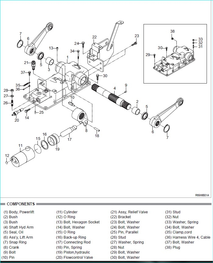

I'll suggest to begin your hyd repair procedure by replacing 3 pt rockshaft piston seals.
Jim, are you referring to item 5 in this illustration attached?
   / 3 Point Hitch slow and unintended dropping #27
Items #15 and #16. Those are the piston seals with the piston being part #19.
