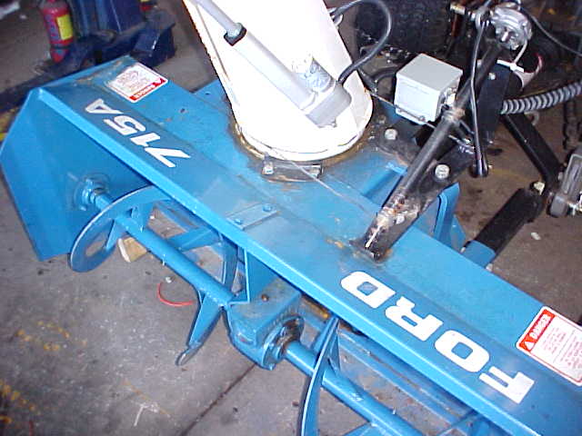

Well a week later then expected but Saturday I picked up the snow blower I was asking questions about. It is a ford mode 715 ~ 50 inches wide. I got home about 7:00 pm Saturday and got it up and running by 9:00 no major problems. Sunday morning we had high winds and about 14" of snow. The blower worked great all day. I moved drifts that were easily 3 times higher then the blower. The comments about the 2 speed pto also worked great. When turning at ~540 it will move very large volumes of snow ~12 to 15 feet. at the 750 (I think) speed the I don't have the power to move as much snow but it easily throws it 30 feet (more if its down wind). Overall my neighbors and I were extremely impressed with it's performance. my little old 16 horse tractor & blower was clearing roads faster then my neighbors L series using the bucket and rear blade.
Unfortunately, Sunday may have proven too much for it. After about 12 hours of blowing the connection between the drive shaft and the impeller broke. It appears the previous owner had welded the impeller bracket to the drive shaft and the weld let go. The forecast is calling for more snow all week and more next week, so I think I'm going to weld it back together and keep going. Long term however, I'd like to fix it right. Does anyone know where I might be able to find parts for an old 715 ford snow blower.
