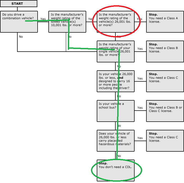

Sure looks to me like they are giving you the wiggle room to be 36k? Follow the flow chart you posted for a 26k truck and a 10k trailer and see where it puts you.
BINGO

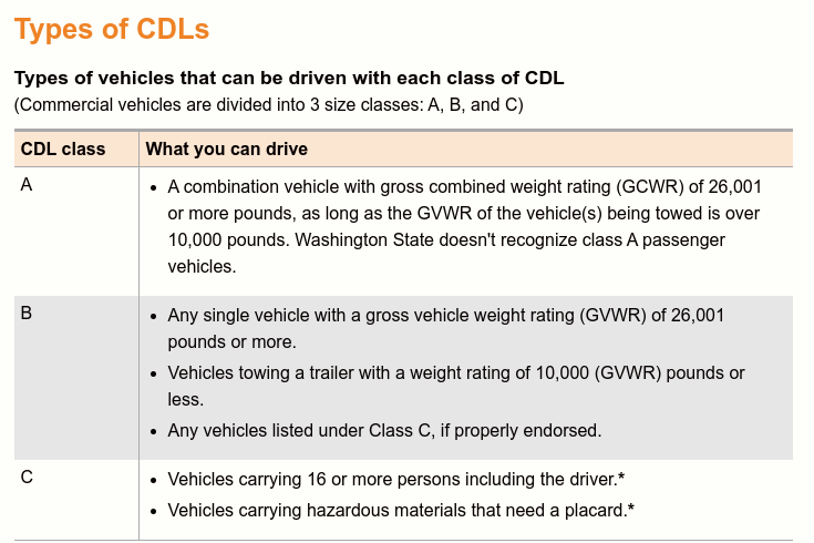

This Washington state link: WA State Licensing (DOL) Official Site: Types of CDLs
seems to provoke more questions than it answers :rolleyes:
Class A doesn't cover GCWR > 26k if the trailer is 10k or under.
But, "Washington State doesn't recognize class A passenger vehicles", so what's a passenger vehicle? A bus? Is my crew cab with kids in the back seat a passenger vehicle even if it's towing a GVWR 16k trailer with an excavator on it? I'm guessing a truck is not a passenger vehicle; when it's towing the primary function is towing and not hauling passengers.
Class B is for a truck over 26k. Easy enough to understand. But, it makes it look like towing any trailer 10k or under requires a class B??? I have to think that this is for "a truck over 26k towing a trailer under 10k" (if it's over 10k, you're class A).
The (s) in "vehicle(s)" under the class A is for towing two trailers at once (requires a CDL endorsement, same linked page).
The (s) is in vehicles without any adjective to designate it means only trailers, therefore it means all vehicles in combination. If you get inspected in Washington, the ticket only has unit 1, unit 2 and unit 3 boxes meaning vehicles in combination.
"All single vehicles with a manufacturer's weight rating of 26,001 pounds or more.
All trailers with a manufacturer's weight rating of 10,001 pounds or more, and " a combined vehicles' gross weight rating of 26,001 pounds or more."
It's clear enough to me, 26,000 is the highest GVWR in solo or combination that can be operated without a CDL.
If you have a class B license, you can pull a 10K trailer behind your 26K or heavier truck, you don't need a class A license. If the trailer is a 14K trailer and the GVWR of the towing vehicle exceeds 12K, you need a Class A. To legally exceed 26K in any combination you need a CDL. Full stop.

You must have missed the box that says "Are the manufacturers weight rating of the vehicle(s)s 26,001 or more" That bracketed "s" indicates both vehicles in combination.
Stated more clearly in another place:
"All trailers with a manufacturer's weight rating of 10,001 pounds or more, and a combined vehicles' gross weight rating of 26,001 pounds or more."
This tells me that any combination of 26,000 requires a CDL. It looks like I could haul a 14k or larger trailer behind a pickup provided I don't exceed 26k, but the language is a bit ambiguous. I wasn't planning on moving anything heavy and with the language being less than crystal clear, I bought a 10K trailer. There has to be a reason that trailer manufacturers list the GVWR of their 10K trailers at #9900 on the data plate.
Didnt miss that box...
Never made it to that box. FOLLOW THE FLOW CHART
