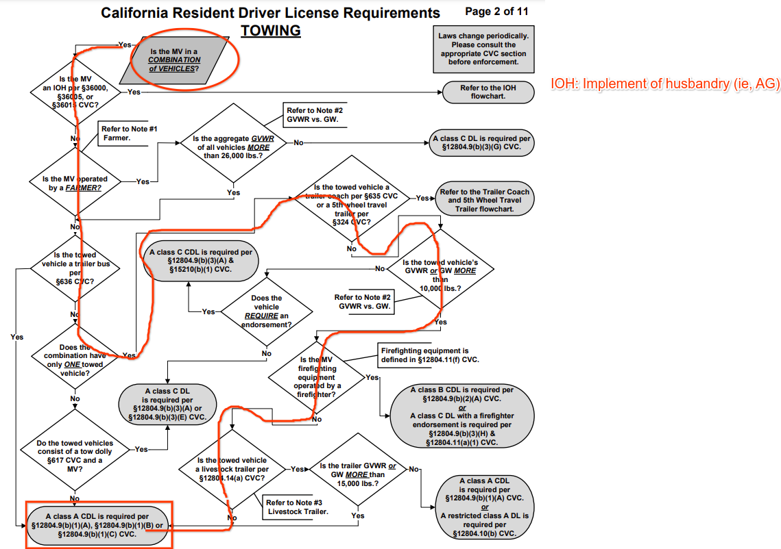

Go to www.fmcsa.dot.gov. Go to the regulations section. You can look at the license class groups. Also, I believe just about every state DMV has a CDL flow chart. If not I am sure, you can google one. If you follow the flow chart and don't skip a step, you can't go wrong. And no the police and courts don't make it up.
California: https://www.chp.ca.gov/CommercialVehicleSectionSite/Documents/Driver License Flowcharts.pdf
Here's the path taken for towing a trailer >10k:

Some states exempt farmers. The feds exempt them only within 150 air miles of their farm but only for CDL,HOS, and medical card. The weight under federal law to make you a commercial vehicle is 10,001 or more single vehicle or combination. States can raise those weights but only for Intra-state operation. You have to look at your states transportation law (Not your states DMV). The moment you cross any state line you have to be in compliance with the federal transportation law regardless what your home state exempts you from. Yes this includes farmers.
   / Understanding Curb Weight, GVWR, Towing and CDL requirements #195
Wow that is complicated. But for CA not surprising. Here is the federal license class definition
Pursuant to Federal standards, States issue CDLs and CLPs to drivers according to the following license classifications:
Class A*: Any combination of vehicles which has a gross combination weight rating or gross combination weight of 11,794 kilograms or more (26,001 pounds or more) whichever is greater, inclusive of a towed unit(s) with a gross vehicle weight rating or gross vehicle weight of more than 4,536 kilograms (10,000 pounds) whichever is greater.
Class B*: Any single vehicle which has a gross vehicle weight rating or gross vehicle weight of 11,794 or more kilograms (26,001 pounds or more), or any such vehicle towing a vehicle with a gross vehicle weight rating or gross vehicle weight that does not exceed 4,536 kilograms (10,000 pounds).
