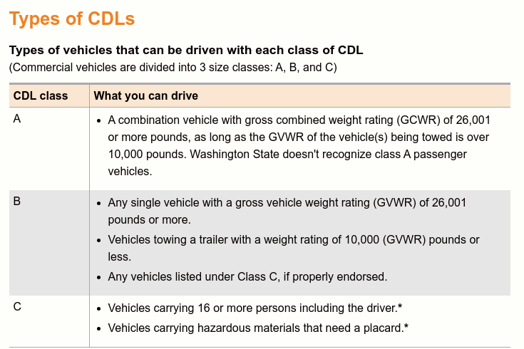

This Washington state link: WA State Licensing (DOL) Official Site: Types of CDLs
seems to provoke more questions than it answers :rolleyes:
Class A doesn't cover GCWR > 26k if the trailer is 10k or under.
But, "Washington State doesn't recognize class A passenger vehicles", so what's a passenger vehicle? A bus? Is my crew cab with kids in the back seat a passenger vehicle even if it's towing a GVWR 16k trailer with an excavator on it? I'm guessing a truck is not a passenger vehicle; when it's towing the primary function is towing and not hauling passengers.
Class B is for a truck over 26k. Easy enough to understand. But, it makes it look like towing any trailer 10k or under requires a class B??? I have to think that this is for "a truck over 26k towing a trailer under 10k" (if it's over 10k, you're class A).
The (s) in "vehicle(s)" under the class A is for towing two trailers at once (requires a CDL endorsement, same linked page).

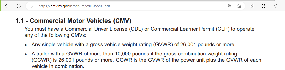

I just got my cdl last week in NY state. Here 26001 gvw combined or alone requires a cdl.
INCORRECT....
you can be 36k combined in new york without a CDL. 26k truck alone and 10k trailer.
Not sure why this is difficult to grasp.
IF THE TRAILER IS UNDER 10K.....THEN ONLY THE TRUCK NEEDS TO BE UNDER 26k.
Its as if a trailer does NOT exist in the eyes of CDL classifications as long as the trailer is under 10k
@screamin400 that seems like a big mistake for someone who just studied and tested on this topic.
LD1 is correct, and NYS law appears to be consistent with most other states cited in this thread.
From New York's website:

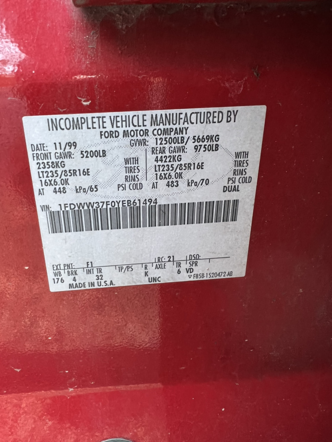

Pretty much if you hook a dually 1 ton pickup to a 14k rated trailer, If the pickup was made in the last 10 years, you need a CDL, even empty…
Even older than that apparently. This is my 2000 F-350.

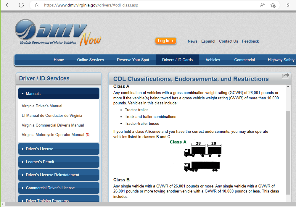

Vdot officer also told him he needed a cdl B license. That is not how I understood the regulations but I called a few trucking class places and they all told me a cdl B would work as long as I didn't go over 56k lbs combined weight!
Just when I thought I understood the regulations, a class B license for a combination comes along!
   / Understanding Curb Weight, GVWR, Towing and CDL requirements #220
Virginia regulations look exactly like other states we've reviewed in this thread. I wonder why they claimed a Class B CDL would suffice for a combination over 26k including a trailer at 14k?
