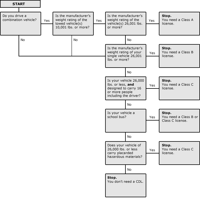

Let’s all post links!
It's the same in Washington. Above a certain weight it is considered a commercial motor vehicle, but in Washington, that doesn't mean the CDL requirement kicks in until it is being used commercially. We are limited to a maximum of 26.000 lbs., either as a single unit or in combination. No wiggle room to 36K.
