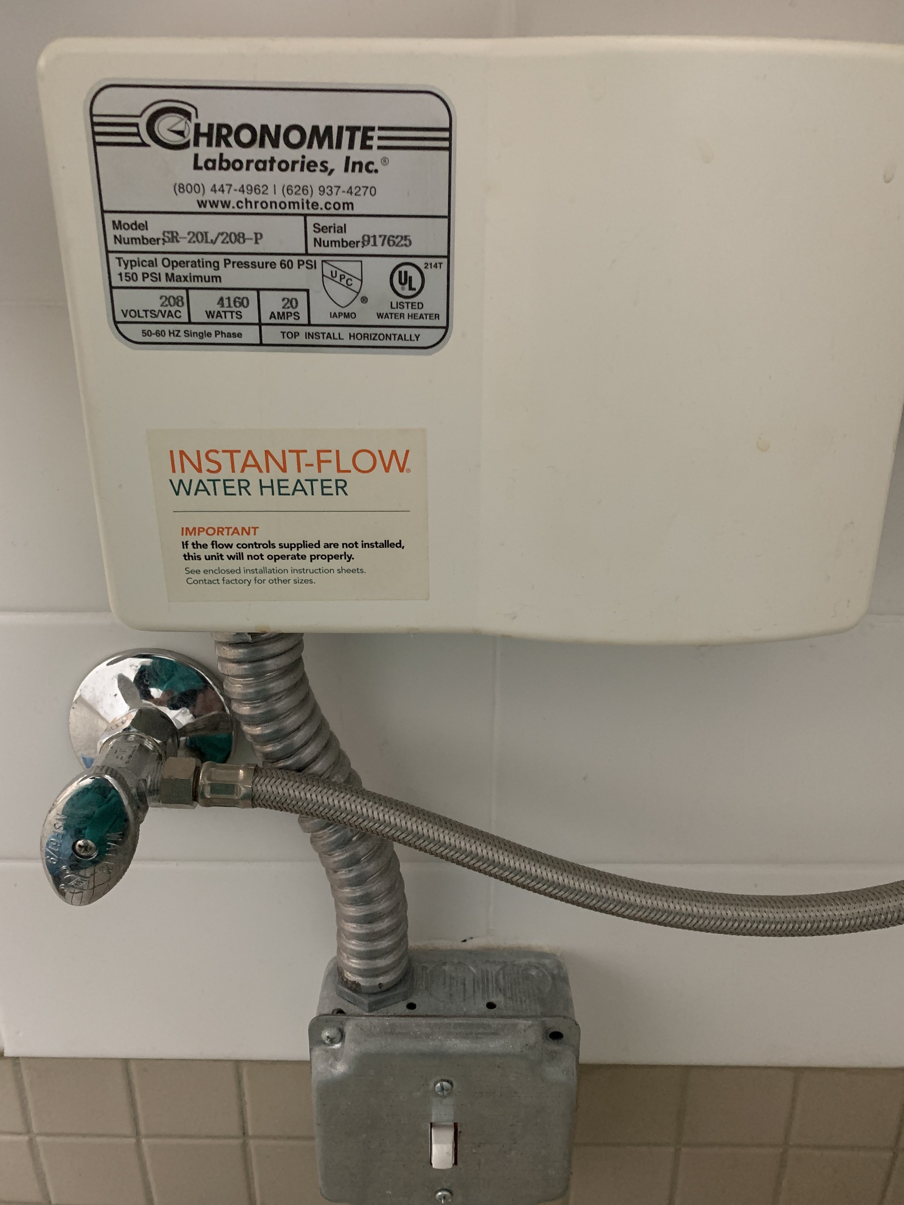

I will take a picture tomorrow if a small under counter unit installed 11 years ago.
I was skeptical but so far so good.
I also have same at the cabin but twice in 45 years freeze damage got it…
Might be a consideration if freezing temps occur in the shop?
Yes please do that. I have been seeing less than stelar reviews saying about the same as everyone above has been saying on the tankless being a bit underpowered.
