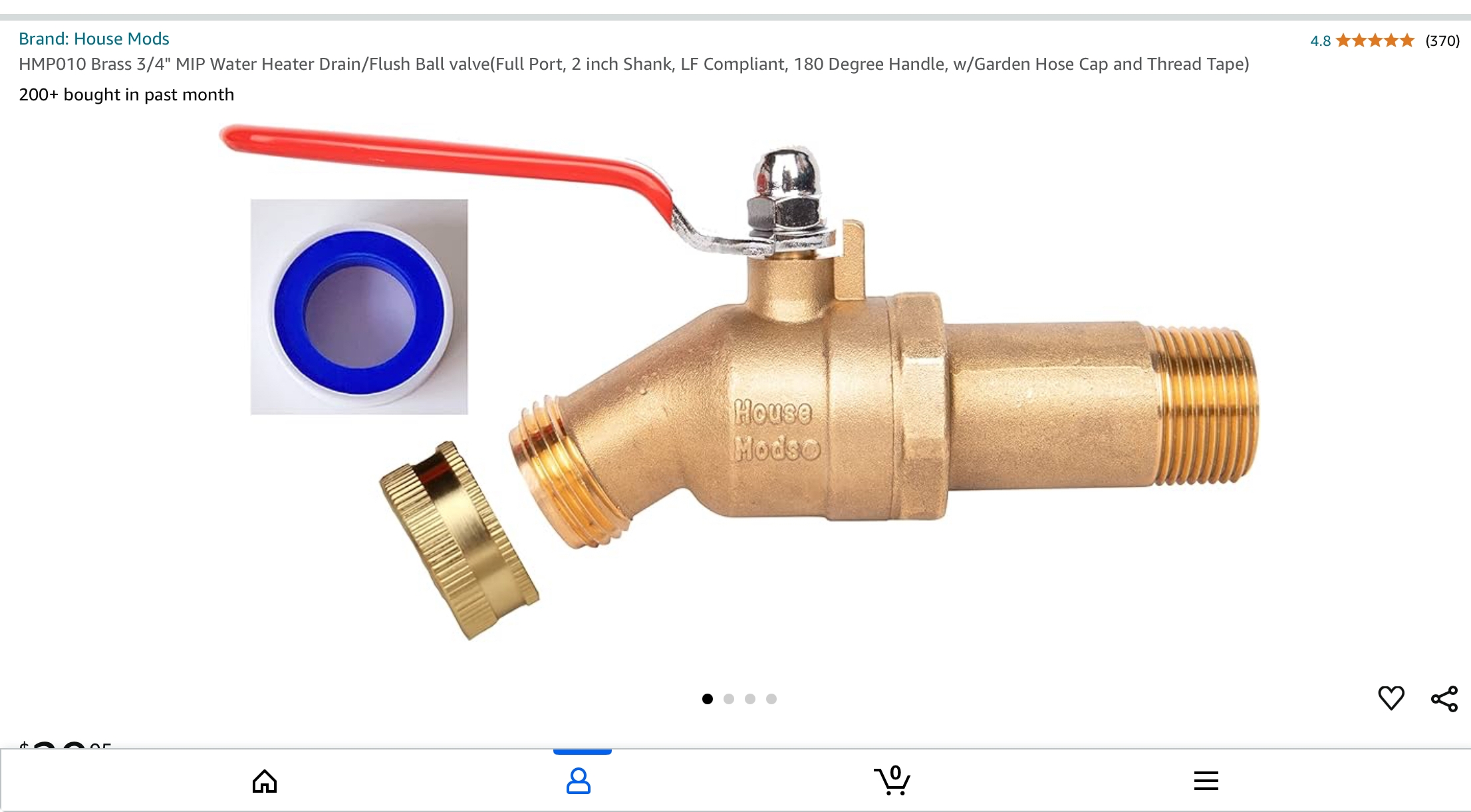

Ive always needed to use an impact wrench to remove an anode rod. On my 2 new units, i installed a corroprotect electronic anode on each one. Wont have to worry about replacing the anode every 3-4 years.
I also installed full port drain valves to drain them 2x per year.
Always drained the old water heater a couple times per year and it always drained pretty well but after it started leaking the drain didn’t work very well even with the faucet completely removed.
   / Rheem lifetime electric water heater tanks ? #19
I got these drains off of amazon. They allow full port drainage under pressure. Really empties crap on bottom of WH tank
