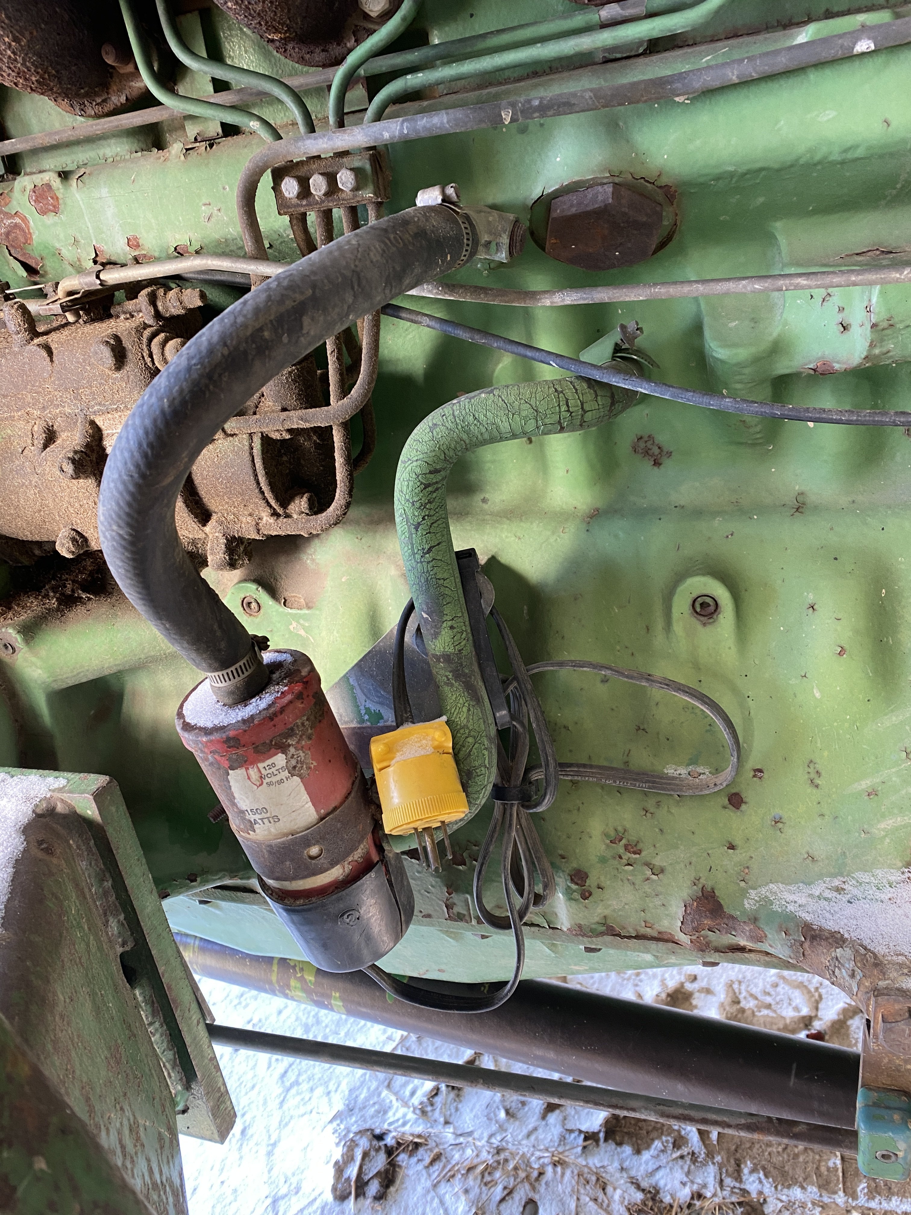

Why not an external style block heater.

I ended up getting an inline one similar to LHF's above, 350W if I remember right. Seems that 3 hours is the ideal time in cold weather. Tractors in an uninsulated shed on the back of my garage with a tarp over the opening. I put it on a remote Christmas light controller so I don't have to go out to turn it on during the storm.
I have an external heater on an older tractor just like the one LHF pictured. Works great. The Deutz engine compartment is quite cluttered compared to the older tractors I am used to. Think of looking under the hood of new automobiles for a comparison. These magnetic block heaters of 300 watts seem to be quite small heat-wise. Just wondering if "too good to be true" apply to these heaters in the real world. I'm sure they would add some heat but would it be enough to actually help with diesel starting and warm up?
