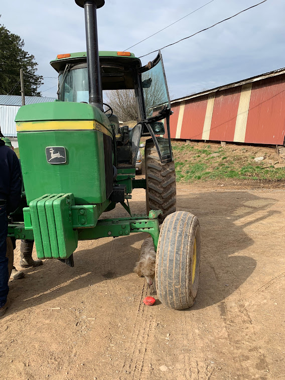

We got to the farm yesterday morning. Got everything ready to pump of the tires. 4 pages of checklist of tools to take and I didn't try running my compressor with the borrowed generator. 3300 watt Honda inverter generator didn't do the job. The inverter light would pop on on startup and the compressor never got to full rpm before shutting off. So I lubed the front end and tried to turn the steering wheel, only to have the wheel spin like a roulette wheel. So, I gather steering is not direct linkages and only hydraulic powered. My Mahindra has power steering, but I can turn the wheels with no steering pressure. Am I correct about all hyd. steering? How can you turn the tires without the engine running besides kicking the tires?

It hasn't ran in 13 years and I wasn't planning on trying to get it running. Just get air in the tires and winch it onto the trailer. I am only trying to clarify how the steering works, so I can figure out a work around it not running.

Is this 4230 below or above serial # 019,559? If above that serial # it has metering pump steering that doesn't function very well unless engine is operating. Your statement that wheel spins similar to roulette wheel indicates this 4230 has metering pump steering. All 4230's have only hydraulically controlled steering with no mechanical linkage. Before moving tractor very far be sure to put transmission gear selector in "tow position".

Saw a Youtube video on metering valve rebuild last night and it fits (in my mind) what we have. I always thought she was non power steering, as no cylinder was behind the front axle. But the steering arm hanging down in from of the hyd. pump keyed my thoughts to all hyd. steering.

A long bar between the front tire and the spindle will give you enough leverage to turn the steering to where you want ir. Especially if your winching at the same time.

4230 will have a hyd steering motor under fuel tank similar to the following link no matter what the serial # is. https://partscatalog.deere.com/jdrc/sidebyside/equipment/8899/referrer/navigation/pgId/111377

DITTO I used a long bar to guide front tires when loading a non operating tractor on a trailer several times while employed at JD dealership.
