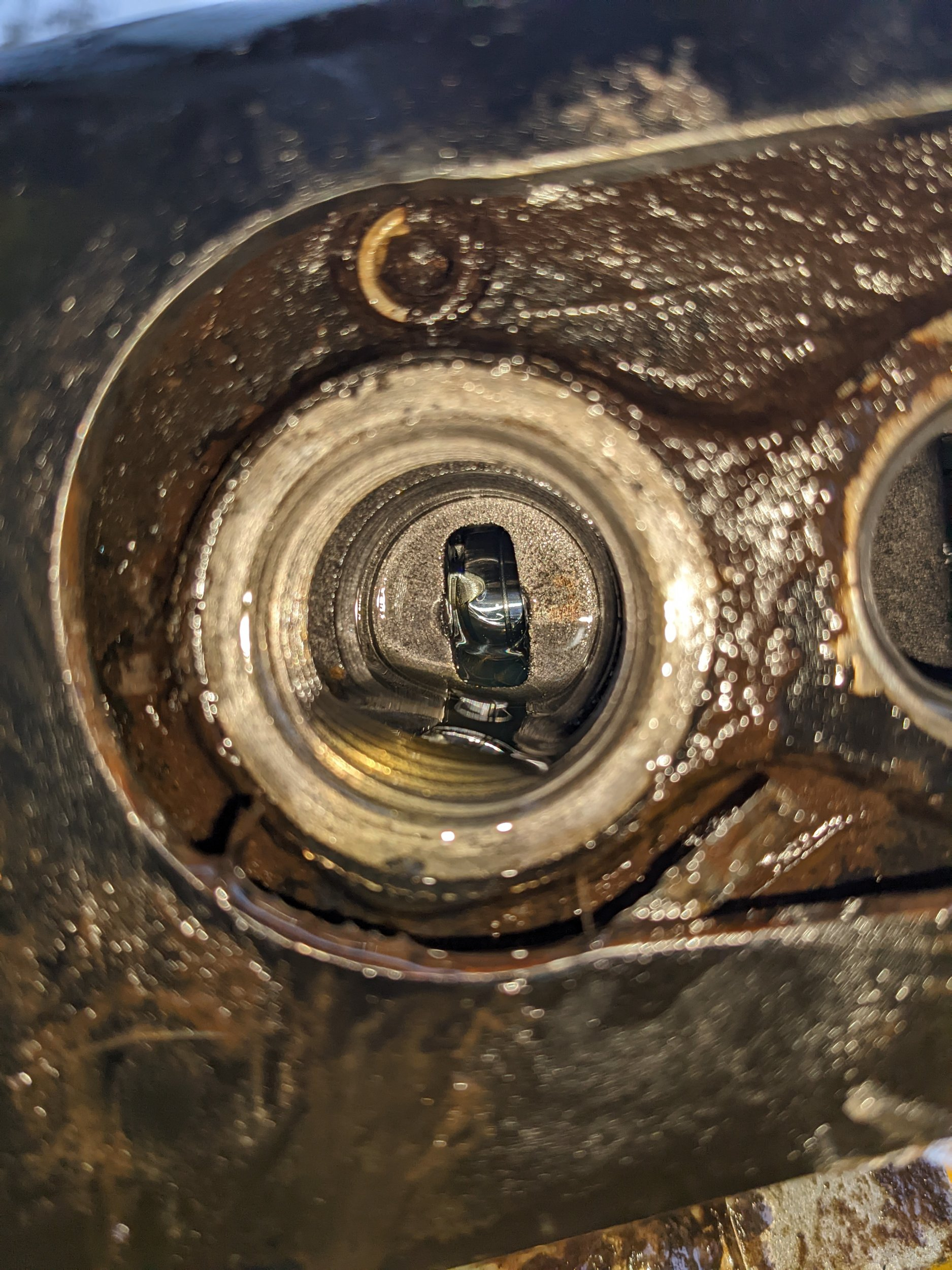

Your memory is sharp. I have a request in to Nimco for a sleeve. Here's what the port looks like:

I could be wrong but that port does not look like it would accept a power beyond sleeve either. Are there any other plugs on that end of the valve?
If I think about looking tomorrow I might still have the original nimco valve from my Branson. This might provide some insight on where the power port was on that valve.
In looking at Nimco loader valve on there website port P1 was the one that the PB sleeve went into.

You can see the machined bore to accept the PB sleeve on that picture.

Classic example of conflicting opinions. To me the bore looks right. To someone else, it doesn't. Which to believe?

100% agree on conflicting opinions. What concerns me in that picture is what looks like machined groove in the side of the cavity bore. In studying further is this a reflection or optical illusion caused by the oil? If they groove is actually there the PB sleeve would not seal
I see I typoed on previous post should say port T1 is where PB sleeve goes per Nimco website today not P1.

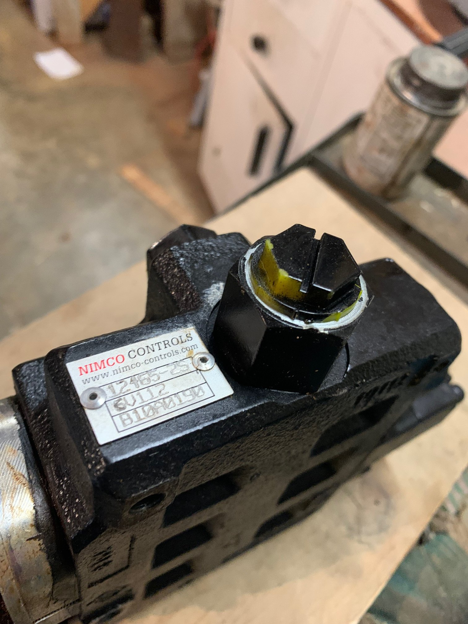

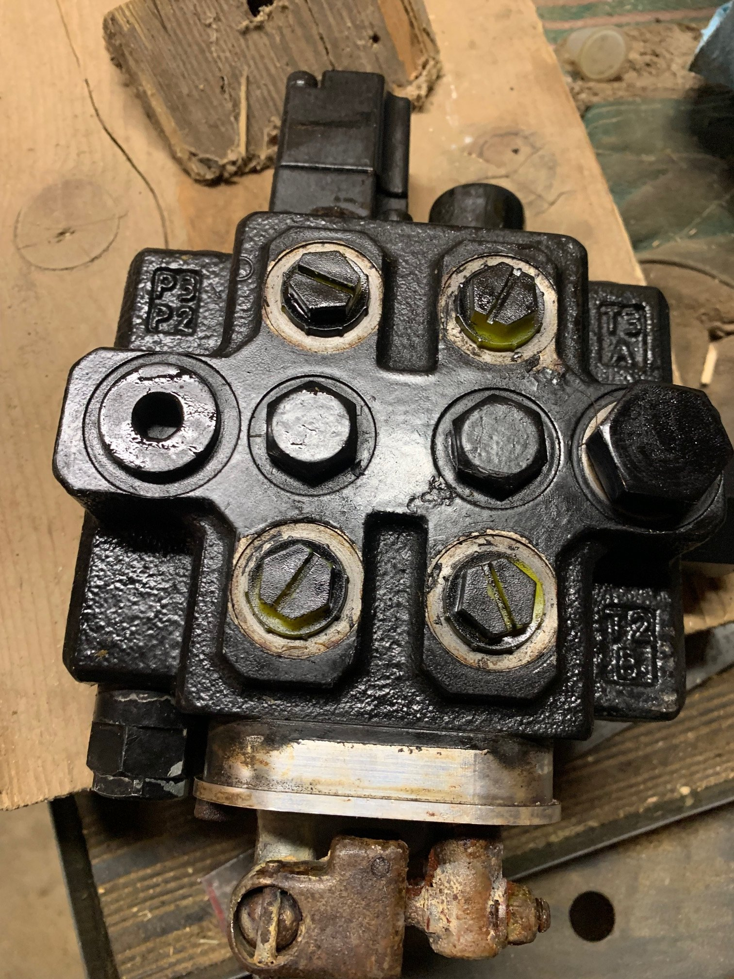

Here are some pictures of my CV122 Nimco loader valve. I am not a photographer but these will hopefully provide a little guidance.

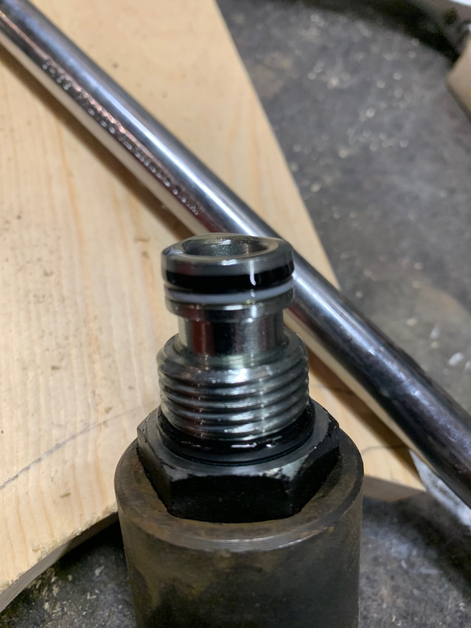

Side view of the PB sleeve removed
PB sleeve installed in valve
Top view of valve. PB is cut off but would be on right side of valve

I'm not a hydraulics expert like all the other responders are but in post 33 something inside the valve sure looks like it's cracked/broken to me. I don't believe there should be any fragmented edges inside of a valve! Just my .02 cents.
