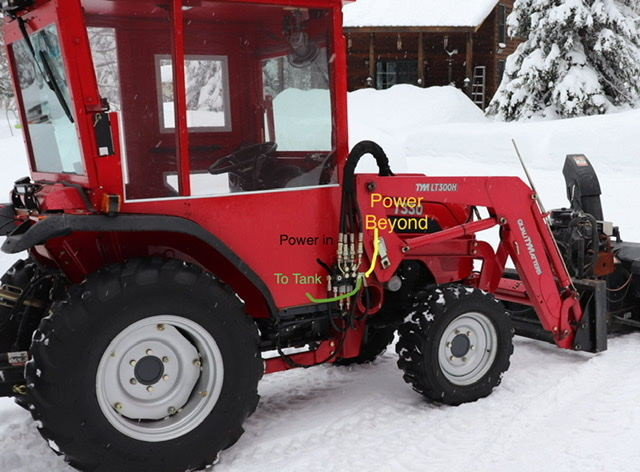

Great pictures! I edited one to mark the the lines.
   / TYM T330 HST Joystick Control Leak #22
Harry I read that page - so this would go on the inlet side of the loader control valve, and would require a new hose that would go from the power return sleeve back to the reservoir? Is that correct?
Edit: It's starting to make sense I think. So when I raised the 3PH with the heavy snowblower, there was a large demand on the system, so the pump increased flow. This increased flow also went to the loader valve since it's connected to the same system. Hence the fluid gushing out when the 3PH was raised.
A Power return sleeve would be a gatekeeper for that extra flow and send it back to the reservoir. Correct?

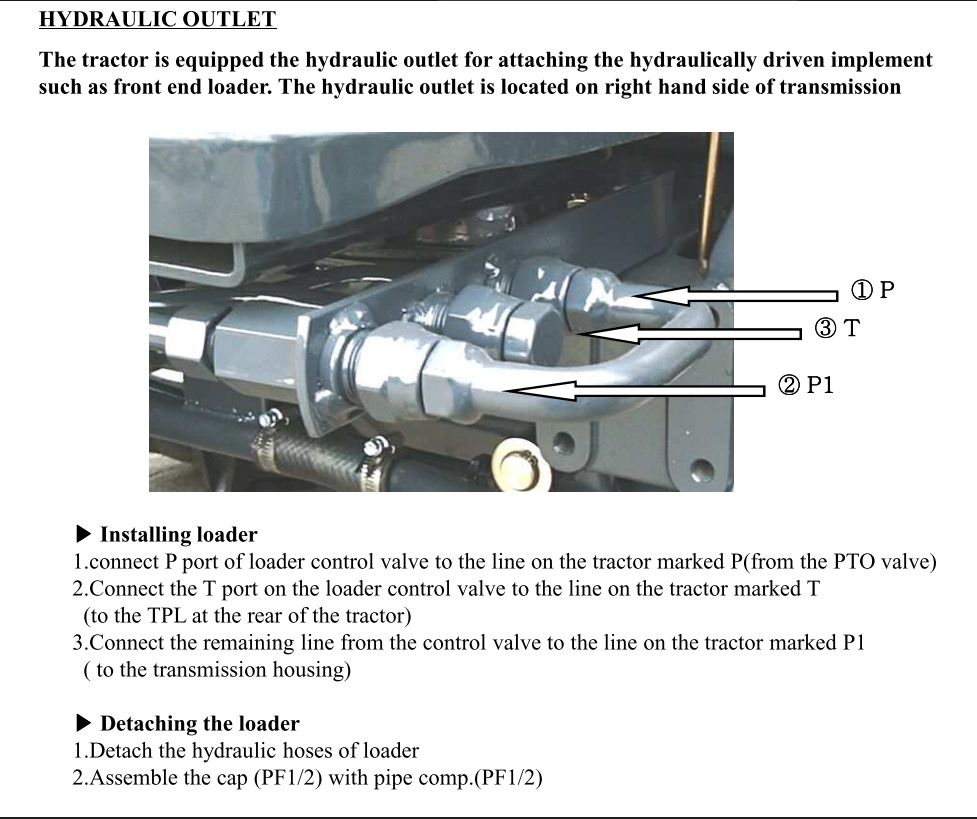

I had the thought to check the owner's manual, this should be helpful:
Look closely around the ports. You should see P for power in, T for tank and C or Y for power beyond. The C would be where the power beyond sleeve would go so this one likely has a plug now.
I'm going to spell it out for my benefit because I'm slow.
  • P is from the PTO valve (in series I presume) - "power in" meaning the pressure side / supply
  • T is the tank return (after it goes through the loader valve). From the picture, what is the TPL?
  • P1 goes to the transmission housing (???) I'm looking at the service manual schematic Fig. 9-1 and it doesn't include the transmission in the schematic - is this the equivalent of C or Y
Edit: Looking at my picture of the stainless lines, there's a line hooked up to P and a line hooked up to P1. T is capped. This is a hydrostatic transmission - does the flow go:
Tank - PTO Valve - Loader - Transmission - Tank?
Markings on the loader valve may be confusing. USUALLY the pressure "in" port will be labeled P, and will be closest to the relief valve. The exit ports will be on the opposite side. Depending on the design of the valve casting there may be as many as three ports. This gives more options for mounting and plumbing the valve in close quarters. The unused ports will have plugs screwed in. The sump return port will probably be labeled T. There may be more than one of those, but there will be only one power beyond port. Lately I've seen that one labeled N on Eastern European valves. With that port open, looking inside you will see an open space then a machined bore slightly beyond that. The power beyond sleeve will fit through the open space and seal around the inner machined bore. similar to drawing in the link I posted. That port, with sleeve installed, connects to the tractor's existing hydraulics, assuming the pressure line to the loader valve comes directly from the pump. If you can't figure out which line is which by tracing the lines, you can determine that with compressed air and a rubber tipped air nozzle if it comes down to it. I've done that many times.
P1 will go back to the valve for the 3pt hitch. This is where the power beyond line from the valve will go. Just need to find the sleeve and correct port. Different valve manufacturers mark the valve different. C stands for Carry Over, Y stands for Power Beyond, and N stands for Next. Thank you Harry for pointing that out.

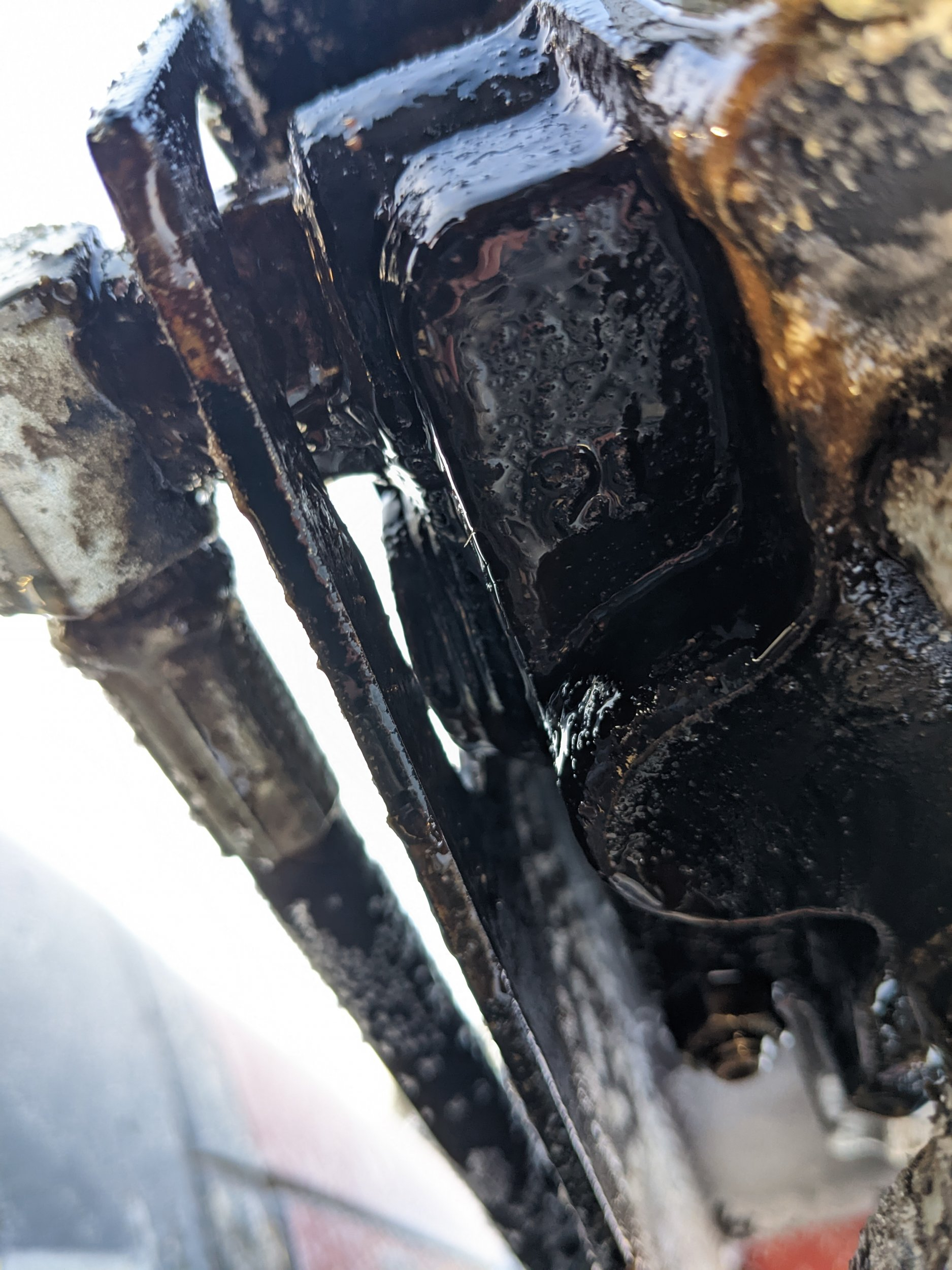

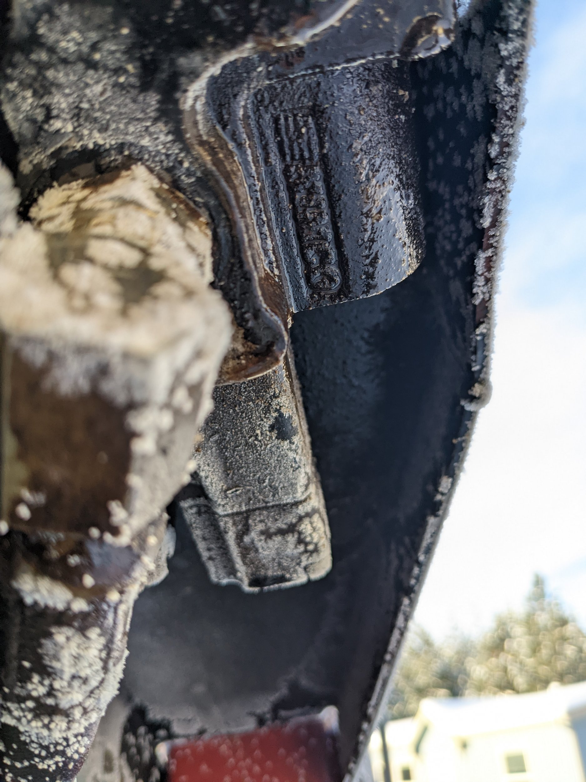

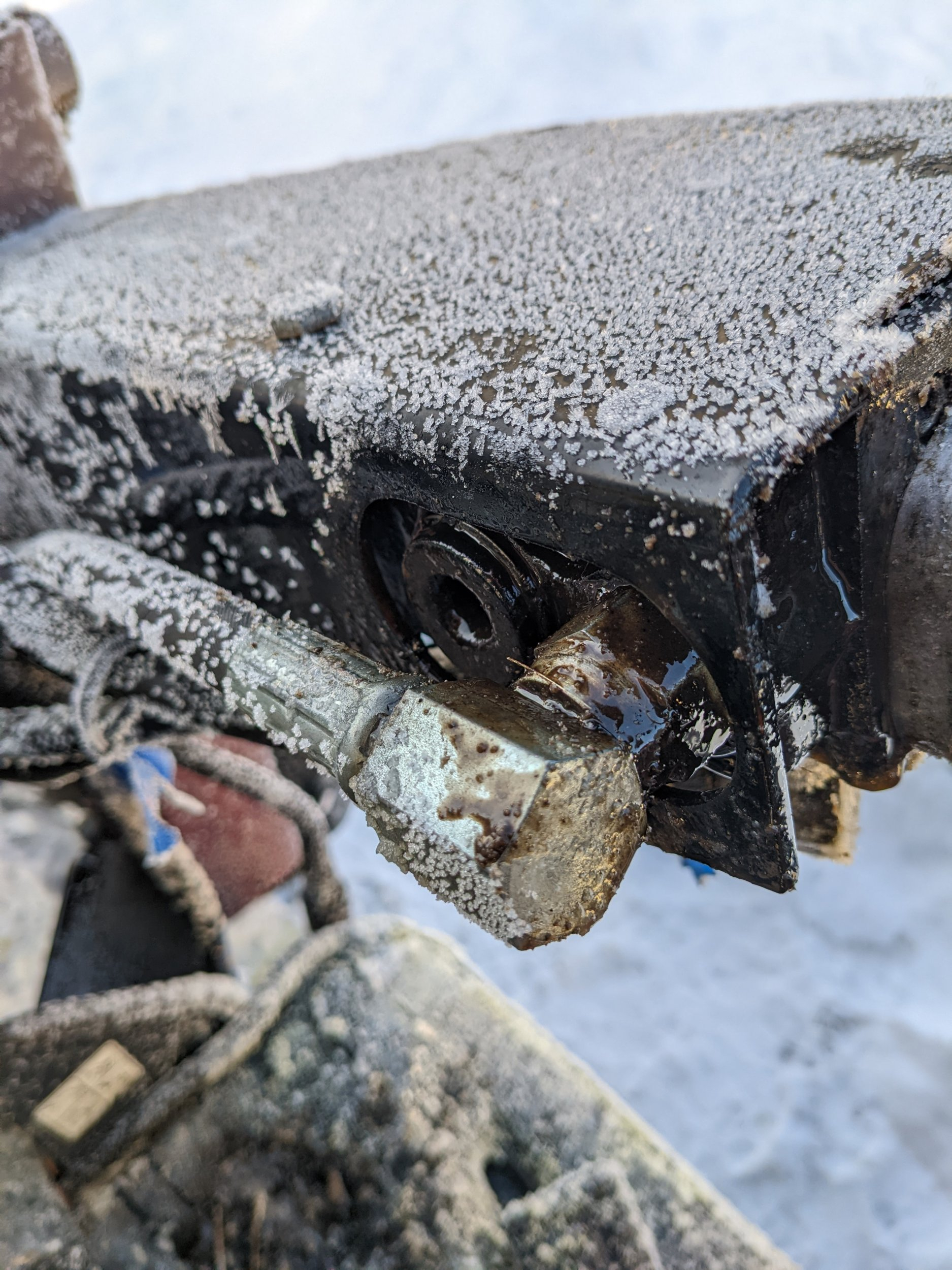

I've got a couple more pictures and a video to try to see the markings on the valve - they didn't come out as well as I'd hoped. It's cold and the valve is dirty.
Here's a video that may make it easier to read:
As best I can tell, the brand ends in ...MCO and there are 4 horizontal lines at the front of the logo.
On the left (from the seat) of the loader valve there is a plugged port behind a port marked T2 (hose connected). On the right, there is just one port with a hose connected marked P2.
I couldn't make out any marks on the plugged port.
