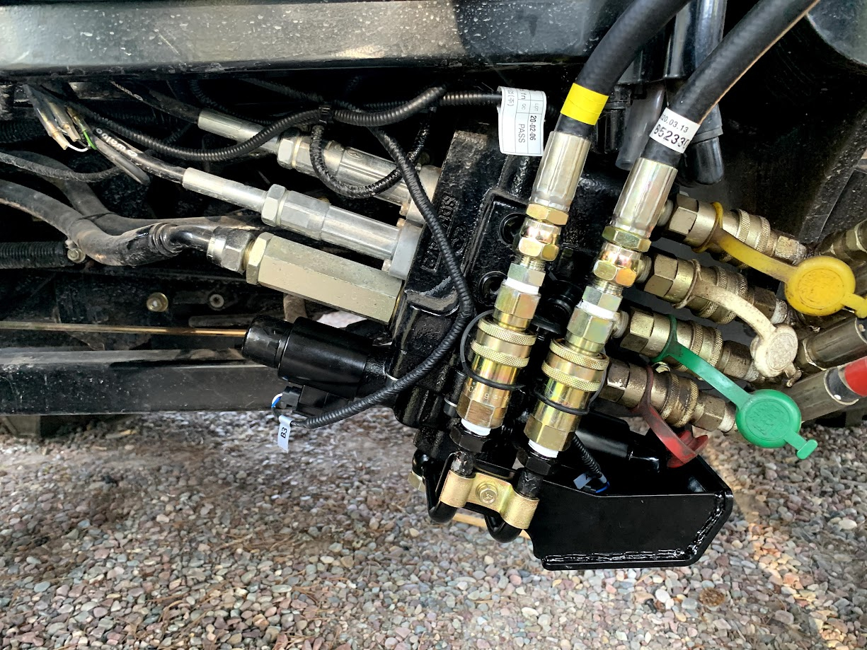

I just purchased a TYM 474 cab and I was sold on the 3rd function ready capability. I however found out after the purchase that it is ONLY a 3rd function attachable loader valve and you will still need the parts and hoses to make it function. That's an additional cost of $850-900 + tax depending on dealer.

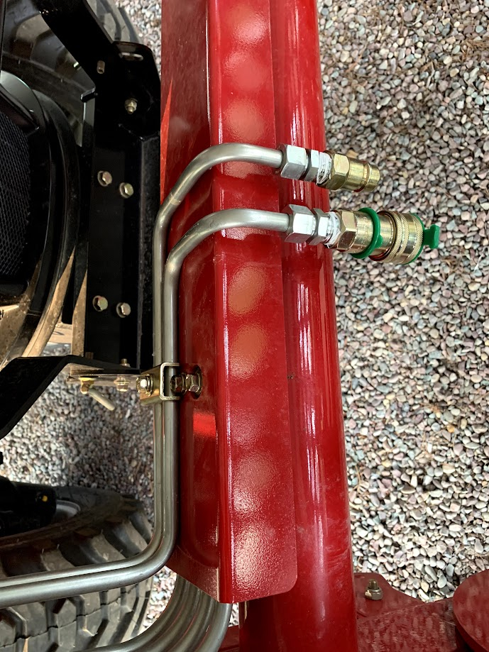

The TYM factory kit is WAAAYY nicer than the WR Long kits, it comes with steel tubes going down the loader. And it is a true 3rd function, just not a diverter valve. This is on my T474
/ TYM 494 3rd function remote #7

I had the 3rd added to mine on purchase and yeah the 3rd function ready thing is marketing speak. $900 was what I paid for mine. Haven't used it yet but wanted it just in case. Buy once cry once as they say
