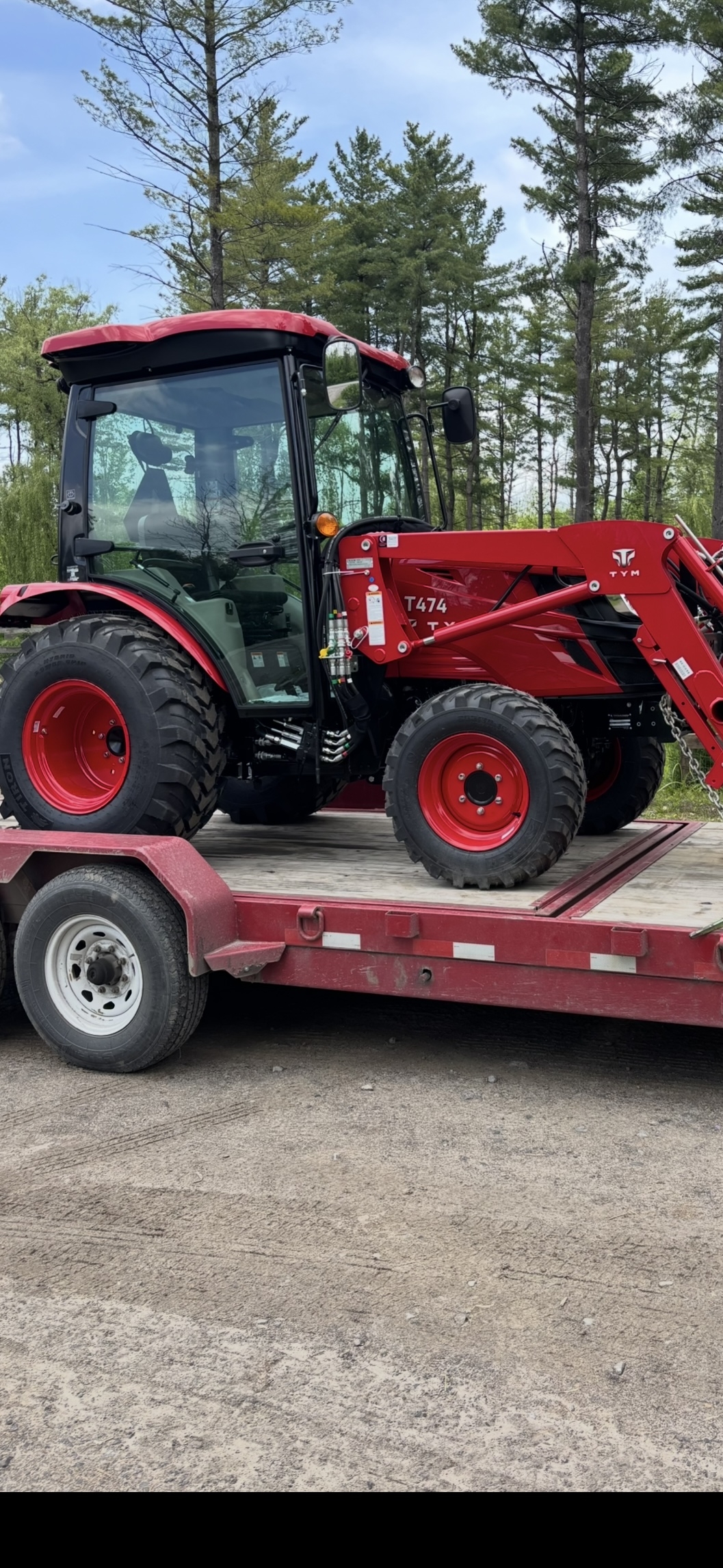

Decided I wanted to get back into a HST transmission Tractor. Went with a new TYM T474 HC…..View attachment 3539959
Had the dealer load the rear tires, add a plug-in block heater, and the 3rd function kit down the loader. Should make for a comfortable, year round work horse.
Who else has one of these or the 494/574?

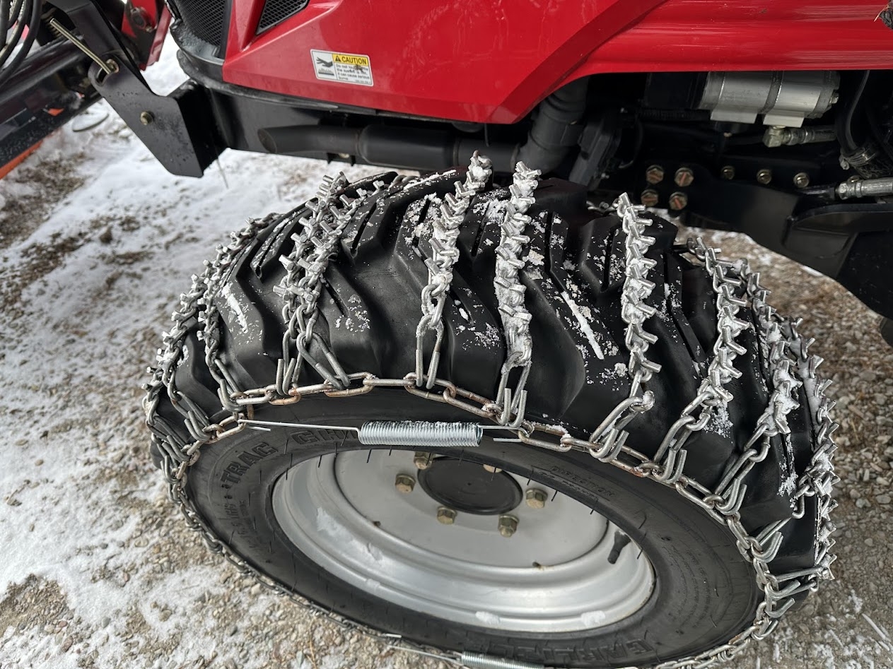

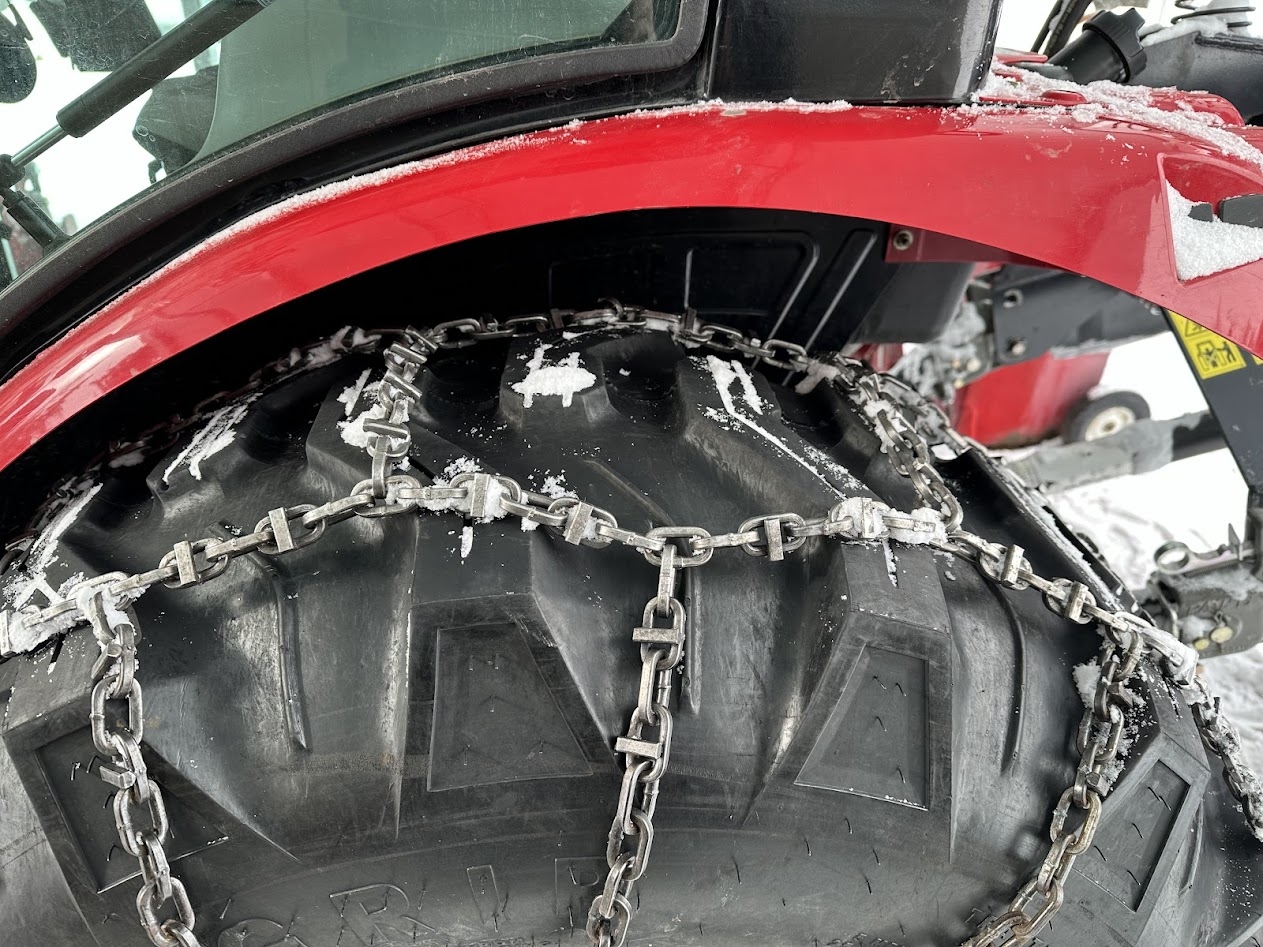

I have a 2024 474 w/ cab. 138 hours. No regen thus far. Only issue I've had was a the valve that opens for heat/AC failed and the dealer replaced it. It was dripping red fluid from above the cab onto the floor steering wheel and floor .Said very unusual repair. The heat works well and so does the AC. I'm considering wheel spacers to widen the rear stance 3" on each wheel for more stability. Otherwise a lot of tractor for $$$$.
   / TYM - T474HC My next work partner. #26
Get Brotek spacers, they are the best bang for the $$$, I put 1.5 spacers mostly to make room for chains in the winter. But added 3'' overall.

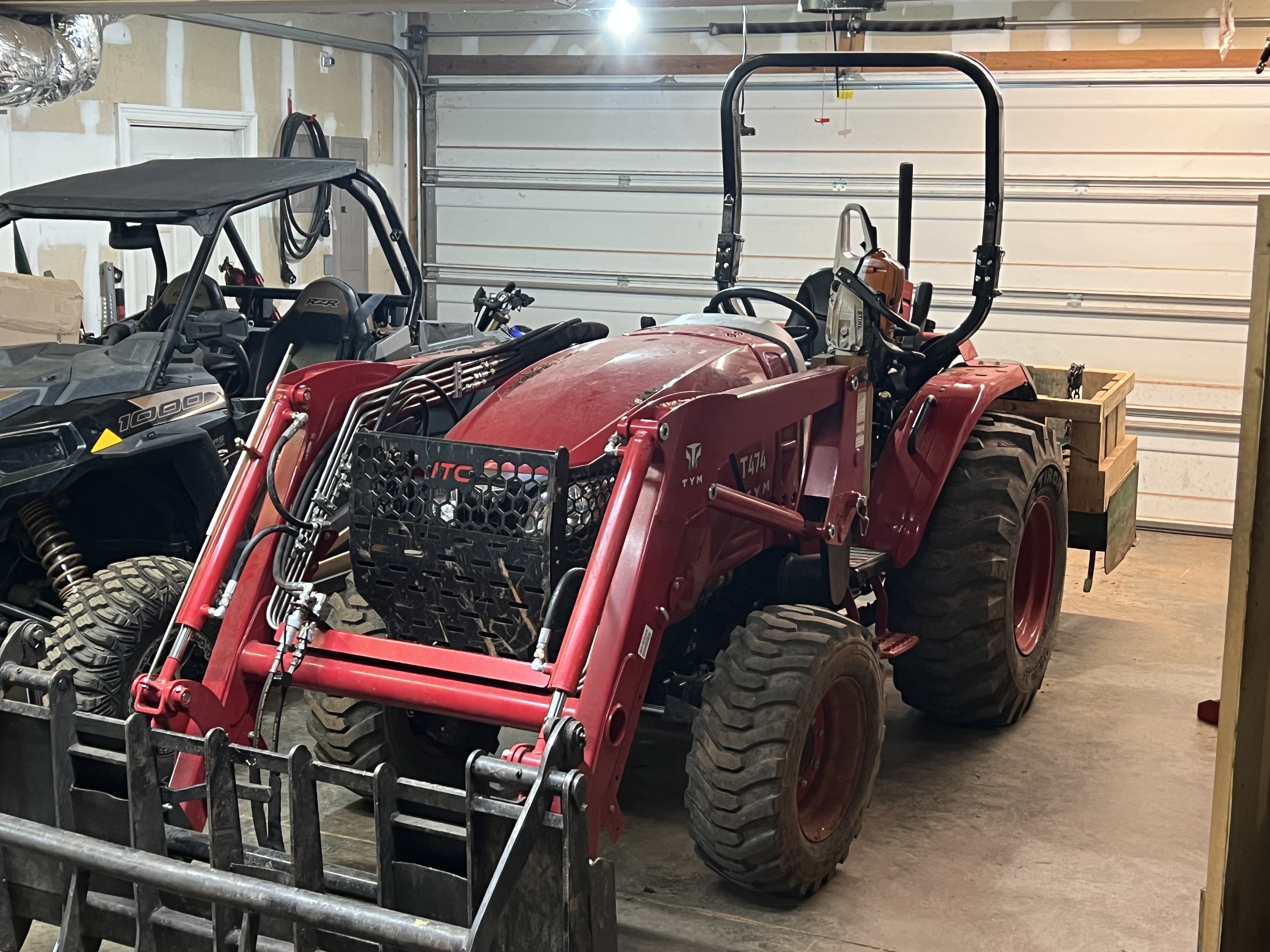

I’ve had my T474 a couple of months now. It is used for logging. I don’t know if there is anything more demanding on a tractor - moving heavy logs, pulling stumps, running a chipper. I’ve learned I need to be easier with it than I was on the John Deere. I’ve already bent the loader mounts, but they have been replaced with new ones and reinforced.
   / TYM - T474HC My next work partner. #32
What JD model did you compare it to?
   / TYM - T474HC My next work partner. #33
I still have the JD 3320R. It's a low HP tractor for it's frame and the T474 is a high HP tractor for it's frame.
