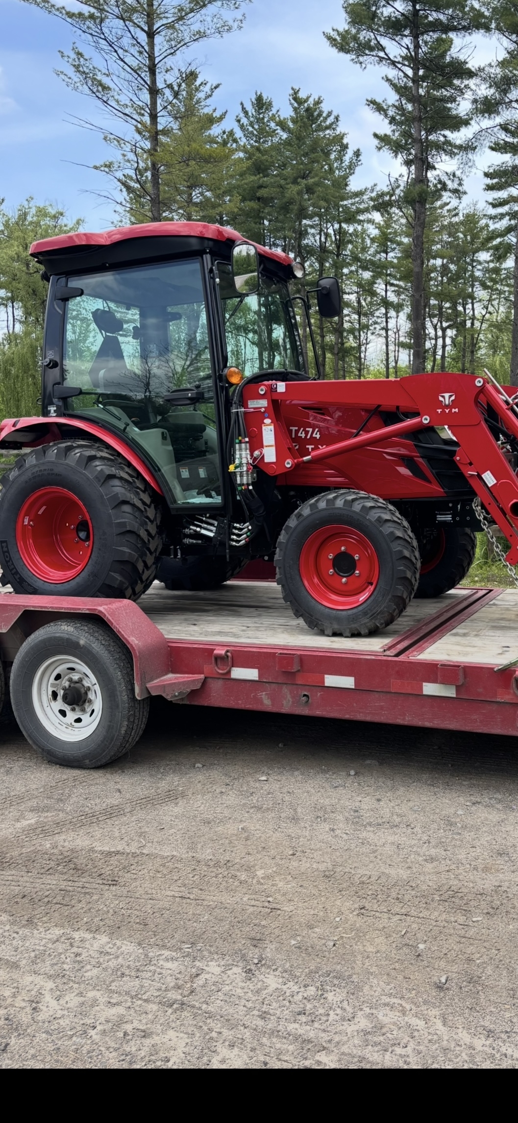

/ TYM - T474HC My next work partner.
#43
It sounds more like a fuel/fuel filter issue rather than hydraulic, possibly even air filter.
These engines can't derate as they have mechanical injection. No electronics at all to control it. Only a very clogged DPF will slow it down and sound awful.
The hydraulic filter collapsing is a fairly known issue on certain tractors that came with that filter.
A collapsed filter would cause the hydraulics to move very slow and on an HST, eventually would stop moving.
I don't think it would cause the engine to stall.
So the collapsed filter was replaced in the full 50 hour service. Still did it when used it at home a day or two later. I’m surprised they don’t have it back to me yet. And even more surprised that they haven’t even contacted me to tell me what is going on. Kicking myself in the ASS for buying it now.

#47
That engine doesn't have any computer control... That's curious
I said to them when I brought it in that I wondered if it was an electrical issue. I’m no mechanic. One of the reasons I bought new was I didn’t want to be working on my tractor.
#56
Just found out a couple minutes ago. Pinched fuel line.
:picard:
Loader frame was pinching it just enough. They took the loader off and moved the line so it can’t happen again. I won’t see it until I get home next week. Must been a problem from the factory. Can you say quality control?
/ TYM - T474HC My next work partner. #57
Just as I thought, a fuel related issue. Easy fix too and sometimes it pays off just giving a once over on the more basic things.
The loader frames are installed either at the dealer or at the importer. I wouldn't really blame this one on the manufacturer though.
