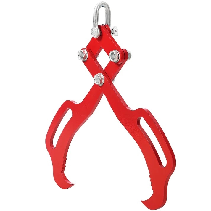

Anyone using the 2-claw type? I mostly lift smaller logs for milling and splitting.
I noticed Amazon and GARVEE both have 2-claw log lifting tongs — wondering if they stay steady or tend to twist under load.

/ Two-claw log tongs any good? #6
Get the ones with 4 claws.
I got the 2 claw ones first, but they were useless. Kept twisting and sliding and logs kept slipping out.
Got the cheap vevor with 4 claws from Amazon. It's 100 times better and more stable, and I dont lose logs now.
I can pick up logs without having to get off the tractor with them too.
2 claw sits now in the garage. Not using it at all

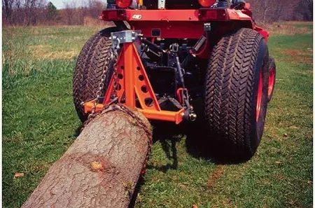

/ Two-claw log tongs any good? #7
When I use the tongs for lifting, I make sure to grab onto the round or log ABOVE center. (not like the image above with the tong hooks UNDER the log.)
By lifting from above center, the work will not try to roll out on it's own.
Same with dragging when it must be done. I try to figure how the log will ride, and then set the tong spikes "above center".
Turning corners can upset the tongs when the log changes orientation however.
