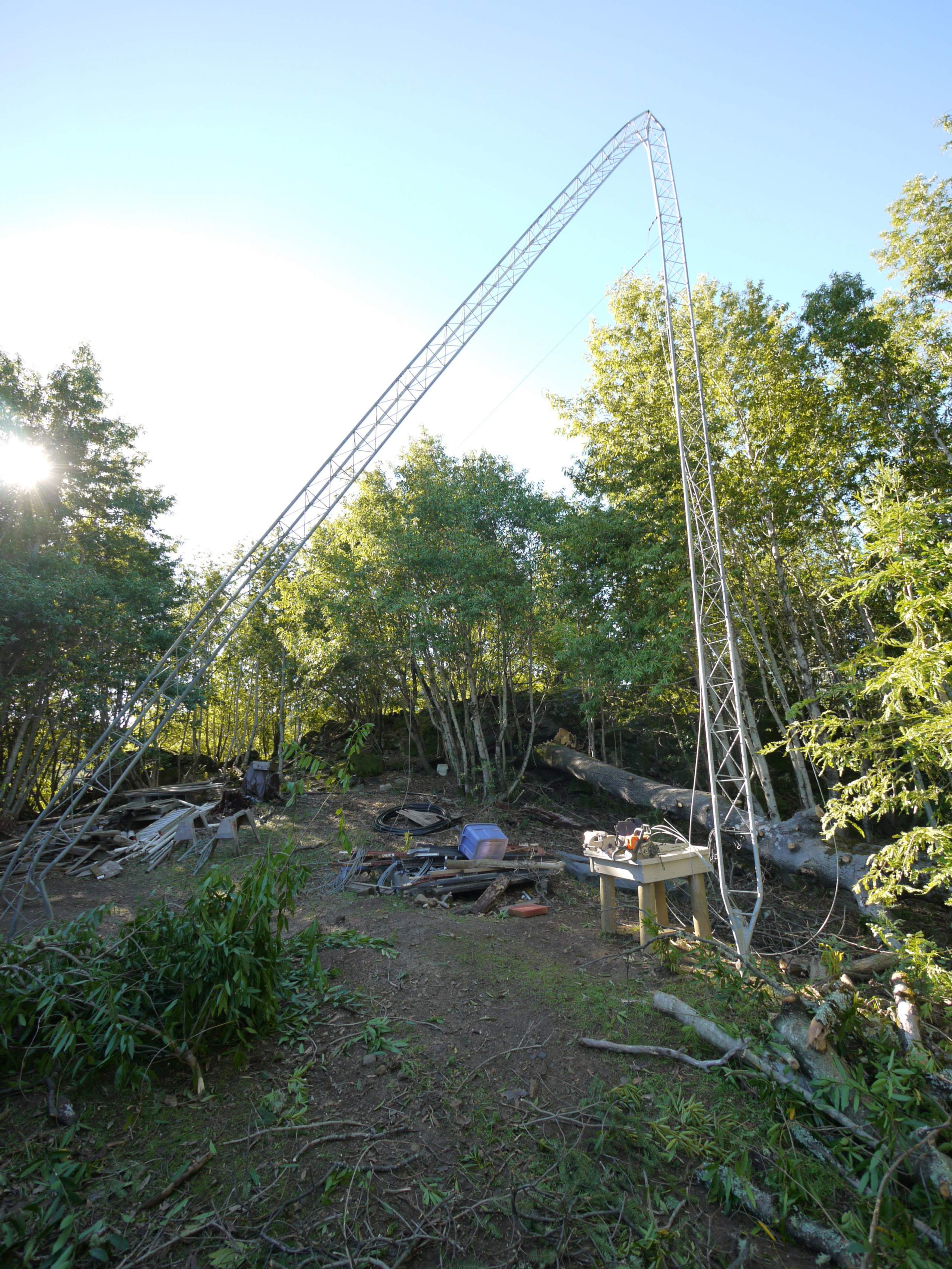

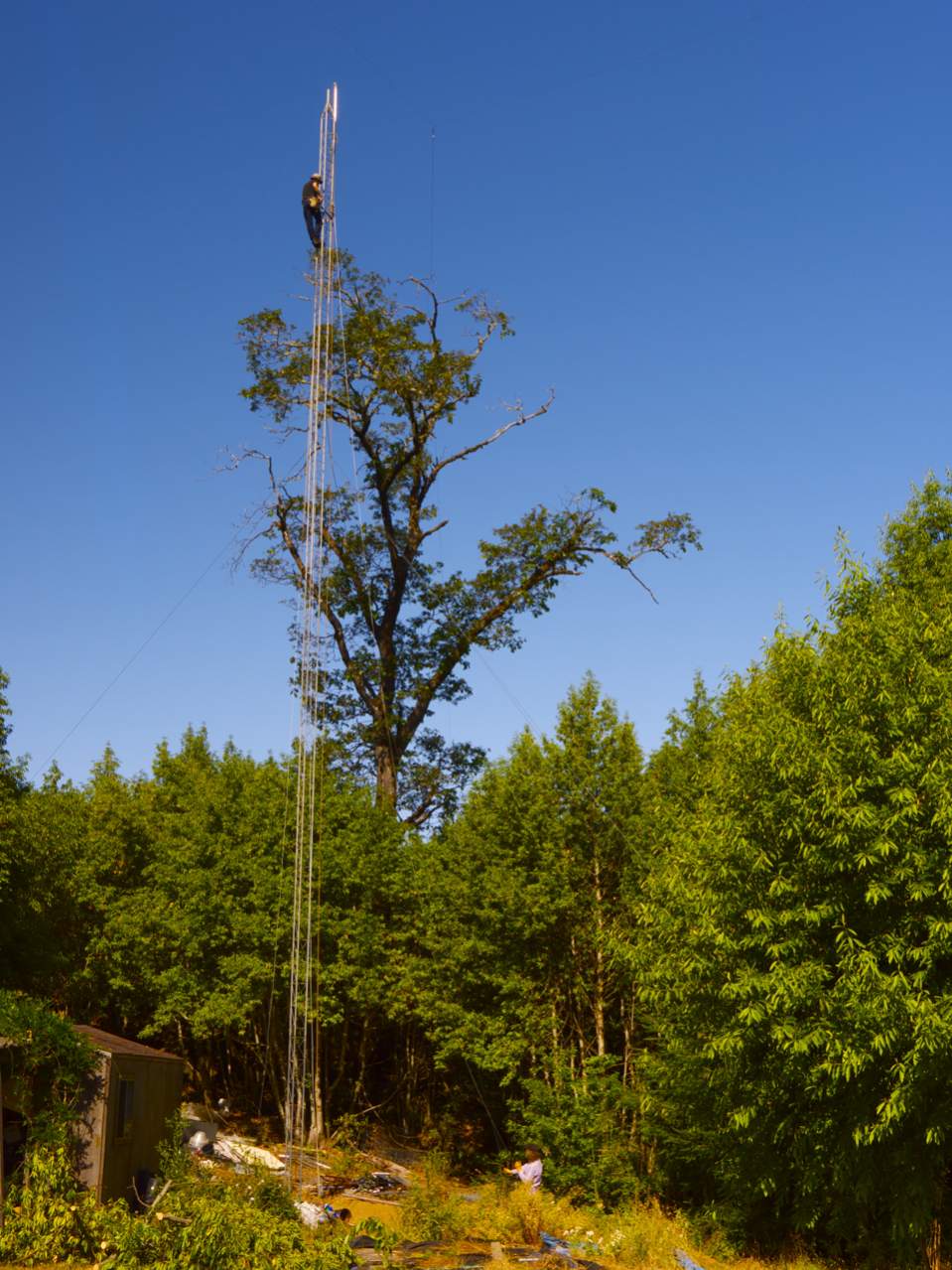

OK, I did gloss over the part where you said you want to take it down to re-set it someplace new for your own use. Thus, you will need a gin pole, and take it down one section at a time. Re-assembly also should be one section at a time. I have done it, and will soon do it again. I have 2 Rohn 25 towers, one is 60', and the other was 80'. It came down on Monday due to an adjacent 75' Oak tree which fell and hit one of the guy wires. I think I only lost two 10' sections, and I will be able to re-use the rest. It will go back up soon!
