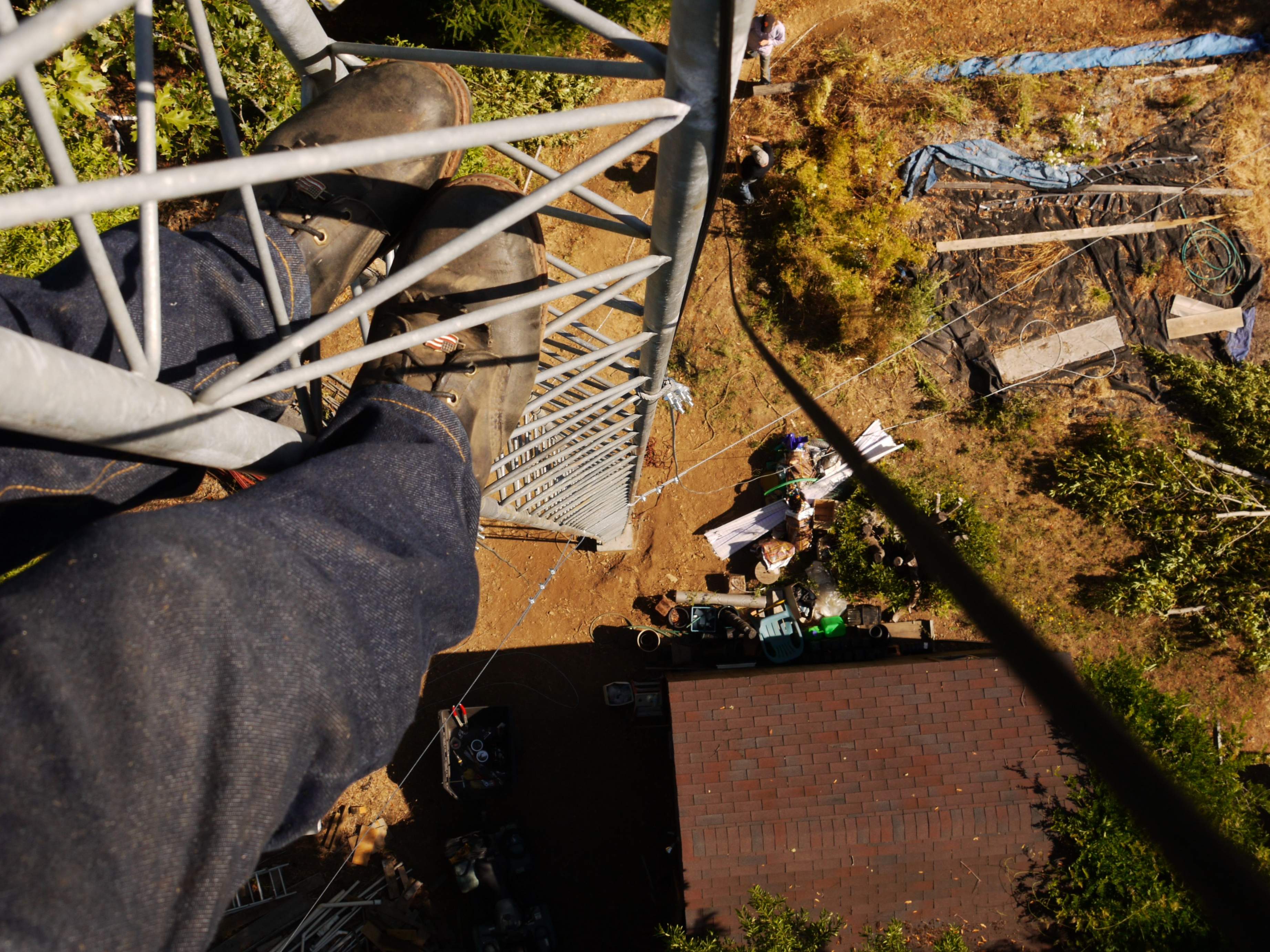

If it is a Rohn 25, the most common type around, dis-assembly with two people and a jin pole is easily done. These towers are in demand by Ham operators, and frequently bought and sold. I have 2 of them (50' & 80') on my ranch. If you place a listing on QTH.com (free) you will likely get several responses, particularly if you offer it at no charge. Market value is about $50 per section. Be sure to state your location. If offered for free, getting someone to take it down is no problem. If you are not sure what you have, take a photo and post it as well.
