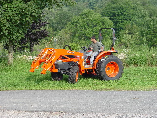

L3010-HST-KUBOTA-4WD-R4's great combo. I find the R4's to be the best tire to fit my needs. I have plowed snow,mowed lawn,played in mud and dirt,driven on highway,all with great admiration for the R4's. Another feature of the R4's is that they are in most cases 6ply rated tires,great for loader work.The only precaution I take,is when I mow I always remove the FEL to lessen the chance of lawn scuff. To sum it up ,R4's I feel are the best all around tires. <font color="orange"> </font>
