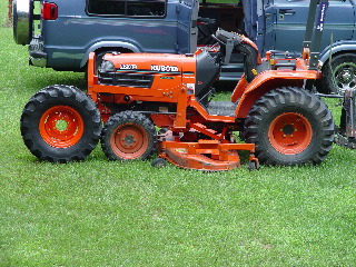

Another view.

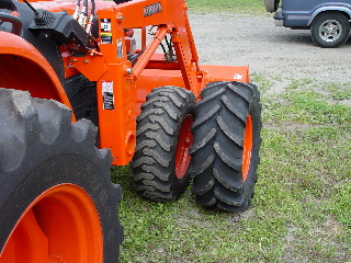

Attached is a closeup of the XM108 next to the Titan R4 on a Kubota L3830. You can see how much taller and wider the Michelin is, and how much deeper and more aggressive the lugs are. Yet, because of its size and because it is a radial ply that will squat flat, manufacturer specs and calculations show that it will have a much bigger, flatter and shallower footprint than the R4 and hence will transmit less pressure per square inch onto the ground. Preliminary tests at Woodbury Tractor confirm this.
The real world test happens Sunday upon delivery. After a few glamour shots, I will drive it straight into the Oozama to where I have completely buried my 2910 many times. If Bob Wolff brings a winch and allows it, maybe I will drive in my departing 2910 right next to it and have a head-to-head mud pulling contest.

Wow Glen, that tire is considerable looking. The tire must work, but man on my L3830, there is a whisker of room between the loader and the R4 I have. Now you have me really curious how this was accomplished. I did not realize you got the new tractor until this thread. The last I saw you were trying to get the ROPS/Folding ROPS figured out. I want to check your profile now to check into the hoe and other things you have. Thanks for the update. Rat. /forums/images/graemlins/wink.gif
