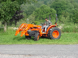

I can't help myself. I SO MUCH love these tires. (But the apocalyptic Oozama Ver Boten test is yet to come. Sunday.)
Here is Bob Wolff of Woodbury Tractor Company (originally a big skeptic), just earlier today, intentionally trying to scuff Connecticut-soaked turf with my Michelin radials.
He failed. Completely.
