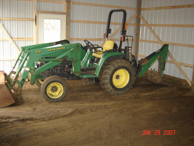

You mean like this (see attached)? Yea, it can & has been done.
