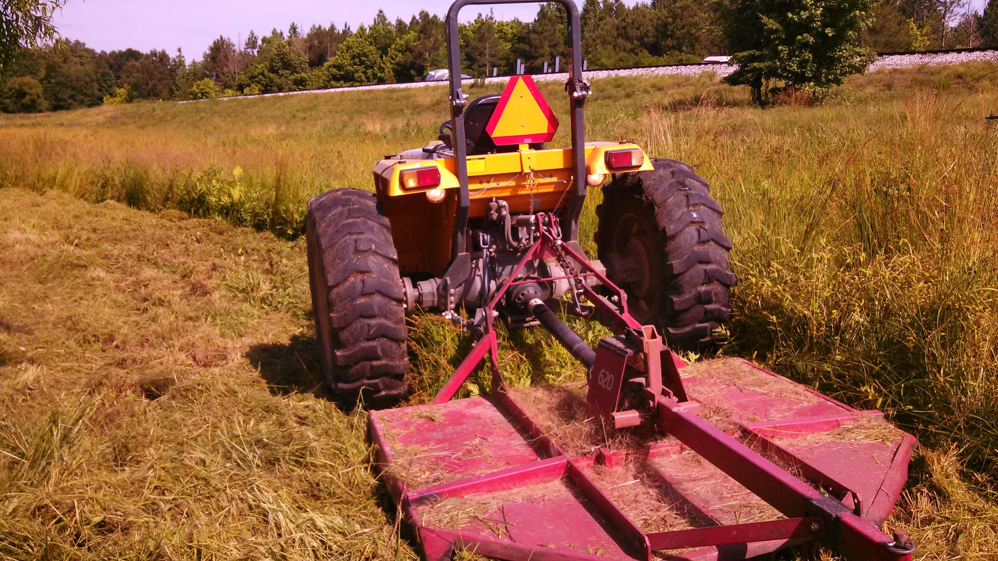

I mowed yesterday for the first time since putting the spacers on. I was able to make 3 passes along the hill by the pond. About 3/4 way up, the hill gets a little steeper and my pucker factor decided that was far enough. Could the tractor have done it with stock track width?, I don't know, maybe but not with my pucker factor. Heck, someone that is used to tractors may even mow the whole hill sideways and not even think twice about it. I'm not there yet, or my pucker meter *is* calibrated and I am right? I could feel the weight of the FM pulling on the tractor to the downhill side. I've been riding/racing dirtbikes and offroading literally my whole life, so I am pretty sure my pucker meter isn't far off from reality. I don't have any idea what the angle is, I need to measure and see just so I know.
It sure does make mowing go a lot faster than having to mow backing up and down the hill the whole way.
I wish the spacers were 6" wide each side, that would be great for mowing the slopes. But in reality 3" each side puts the rear tires at 66", which is the same as my FEL bucket and still under the FM at 72". Nice thing about that is when I have the FEL on, if the bucket fits between 2 trees I know the rest of the tractor is going to (minus the FM).
