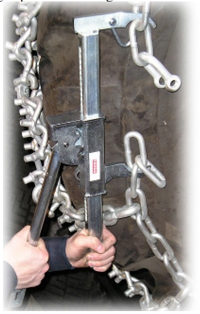

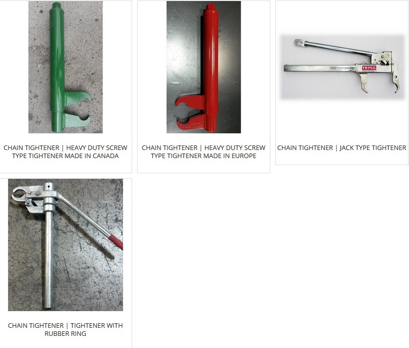

I found that without using the special TRYGG jack, the chains are never as tight on the tire as they are intended to be.
I tried other tools but once I bought the special tool (expensive $280 in Canada) it was like having a gorilla helping me.
There are other cheaper styles available and skilled owners could make one up.

The attachments show up fine now and nice job on the fix.:thumbsup: Glad to hear it is more of a wobble than a rough ride. I'm really expecting these chains to ride quite smoothly, especially compared to the ladder chains I had on the front tires last year. Man those things rode rough on ice.
Dave, thanks for the pics of the chain jacks. The screw type look like they should be fairly easy to make. I see a little project in my future.:)

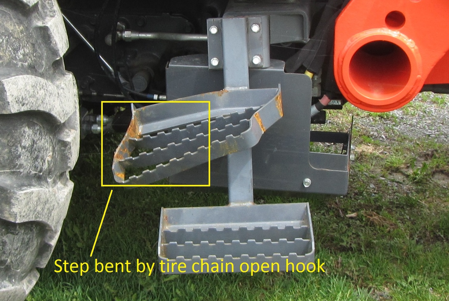

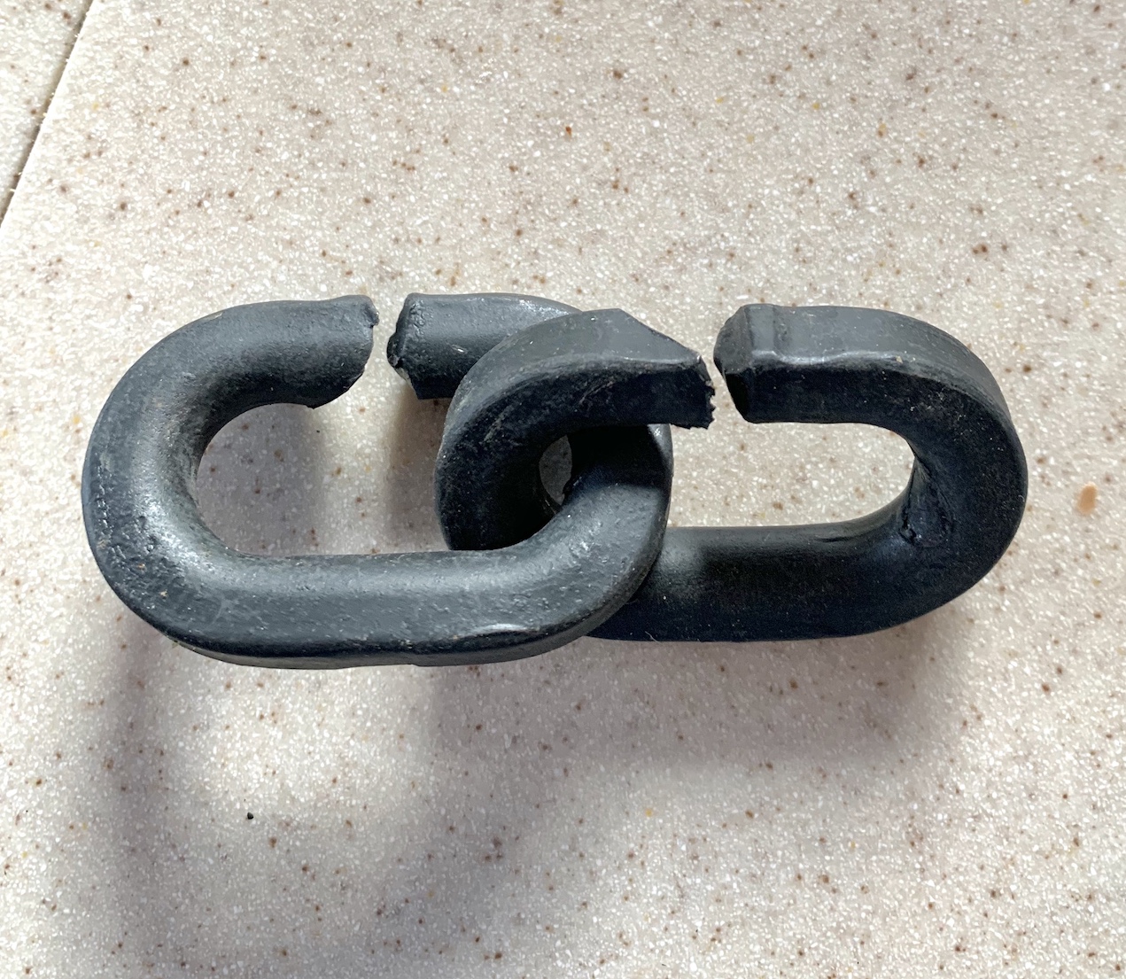

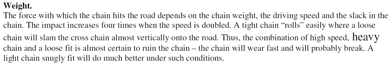

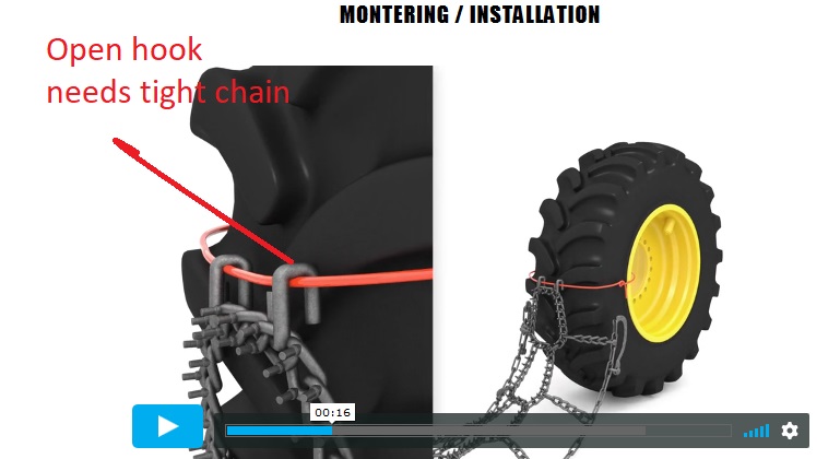

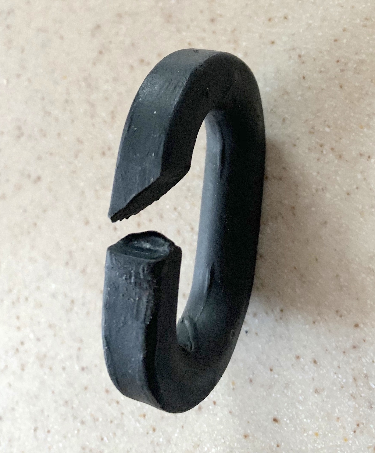

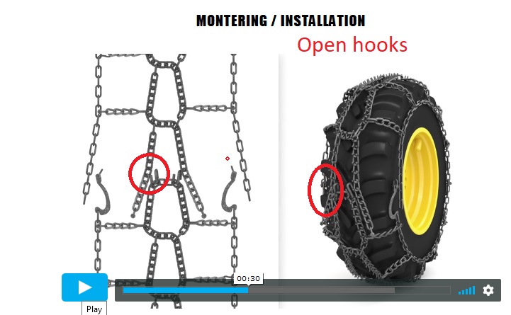

I have provided some info regarding TRYGG chains and a tight installation.
TRYGG maintains a loose chain will have much greater wear and damage from pavement impact.
The diamond pattern of studded chain wrapped around the tire circumference is only completed by joining two diamonds using open hooks.
If the chains are not tight the diamonds will come apart.
When my too long chains came apart, the open hooks grabbed unto my tractor's step and locked one back wheel which was scary.
Dave M7040

/ Trygg chains installation #46
interesting, none of mine have an open hook they use clevises or the open link that has to be twisted and turned just right to be hooked or unhooked.
/ Trygg chains installation #47
Yeah, them open hooks are a accident waiting to happen. I always thought chains should be loose enough to walk around the tire a bit while in use.

Looked at your pics of the chains hooking your tractor's step. That must have been a scary moment, don't want that to happen at road travel speed.

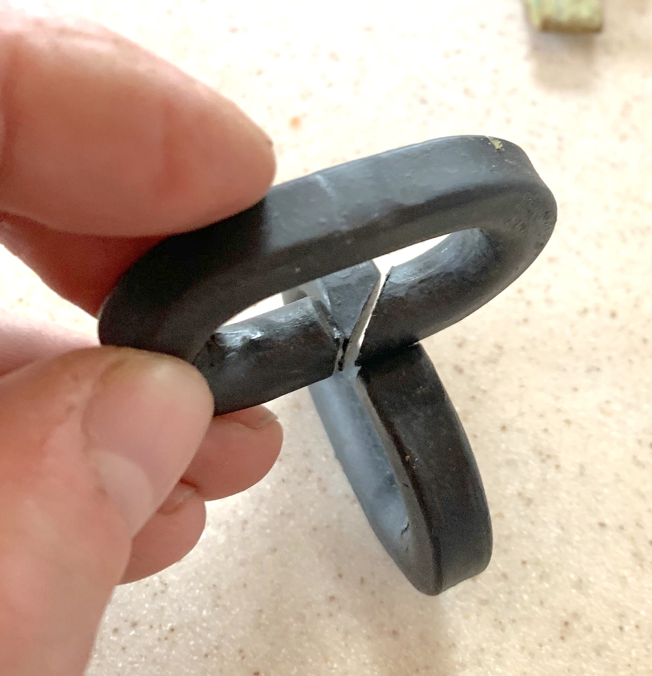

I can see how open hooks or S hooks could cause a problem if the chains were loose. OFA EKO chains have a different method for joining the two diamonds when installing the chain. They have a special chain link with a diagonal cut in the side:
Two of these are attached in two places to the trailing edge of the last diamond pattern on one end of the chain, and two more are attached to the leading edge of the diamond on the other end of the chain. Once the chain is wrapped around the tire, the links can be connected together, but only if they are in a specific orientation. Once connected, they act like regular chain links and will not come undone unless they are moved to that same orientation and pulled apart. The overall circumference of the diamond section is adjusted to fit slightly larger or smaller tires by adding or removing extra links (which is why I happen to have spares).
I have never had these come apart in use. In fact it takes a bit of fiddling to get things just right when I do want to take them apart.
