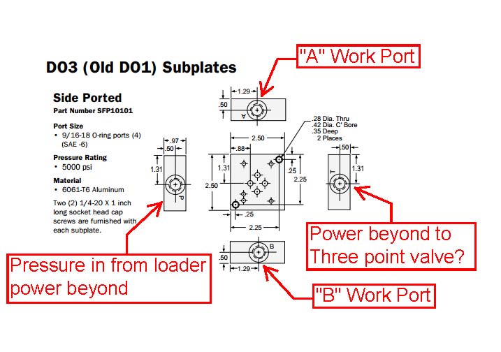

All the ports on a subplate are capable of about 5000 psi.
You can insert the 3ed function valve anywhere after the FEL valve, but before the 3pt valve.
The 3ed function T port can go to tank if that is your only valve or last valve in the hyd circuit.
Any action you do with the 3ed function, will be reflected in the FEL valve relief.
You can also insert a relief valve anywhere in the hyd circuit for protection of a cyl or motor, etc..

#37
JJ
To clarify....
"The 3ed function T port can go to tank if that is your only valve or last valve in the hyd circuit."
In my build the 3rd function would be before the three point connection.
So the "T" port from the third function sub plate would feed the three point valve???
Power beyond to the three point valve?
Thanks again for all of your patience answered everyone's questions. It's greatly appreciated!!!
JJ
Here's a diagram of the sub plate.
I added the comment boxes indicating my understanding how the flow of the valve should be.
Is my interpretation correct????????
Thanks for all of your wonderful advice Sir.

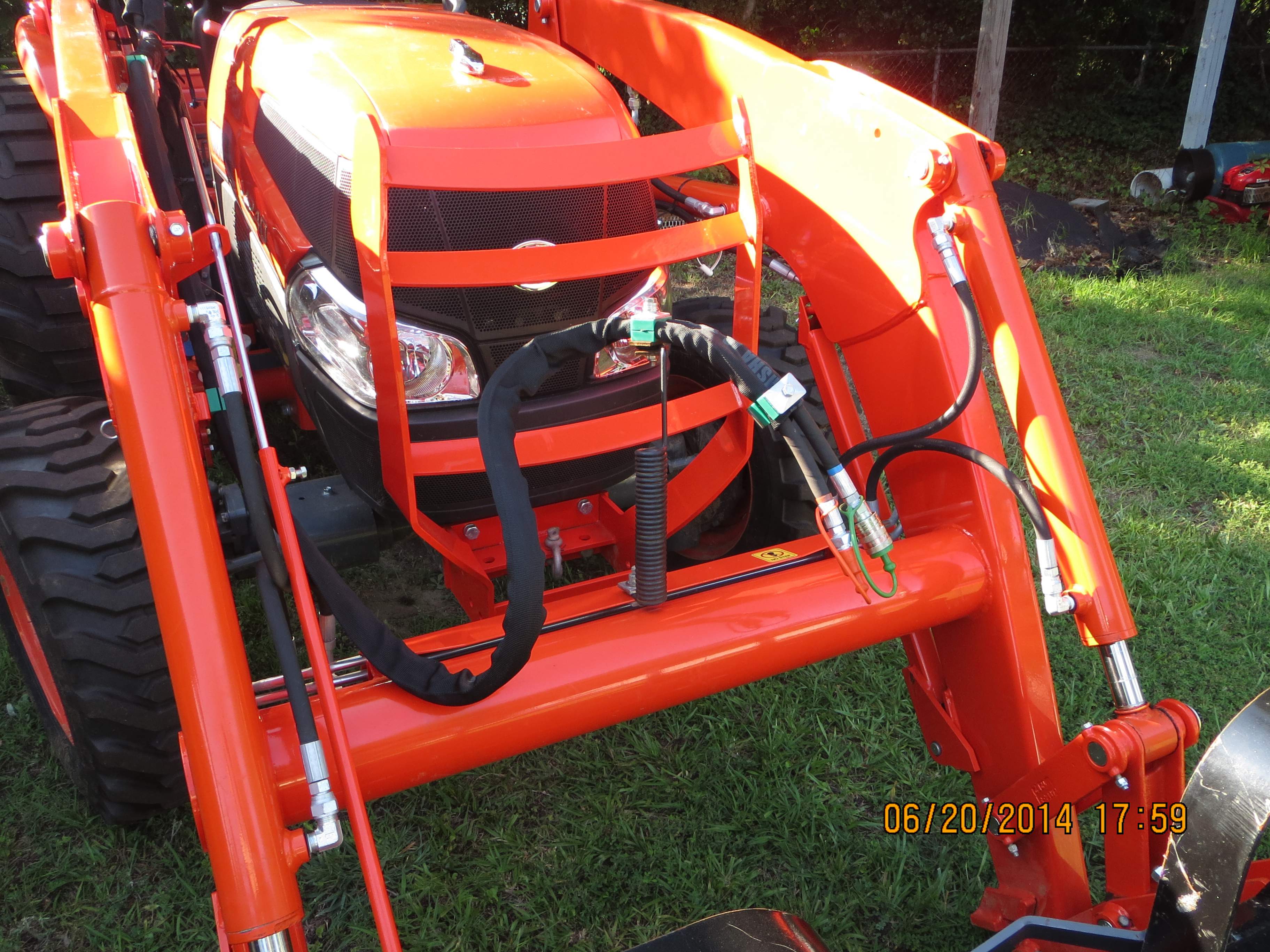

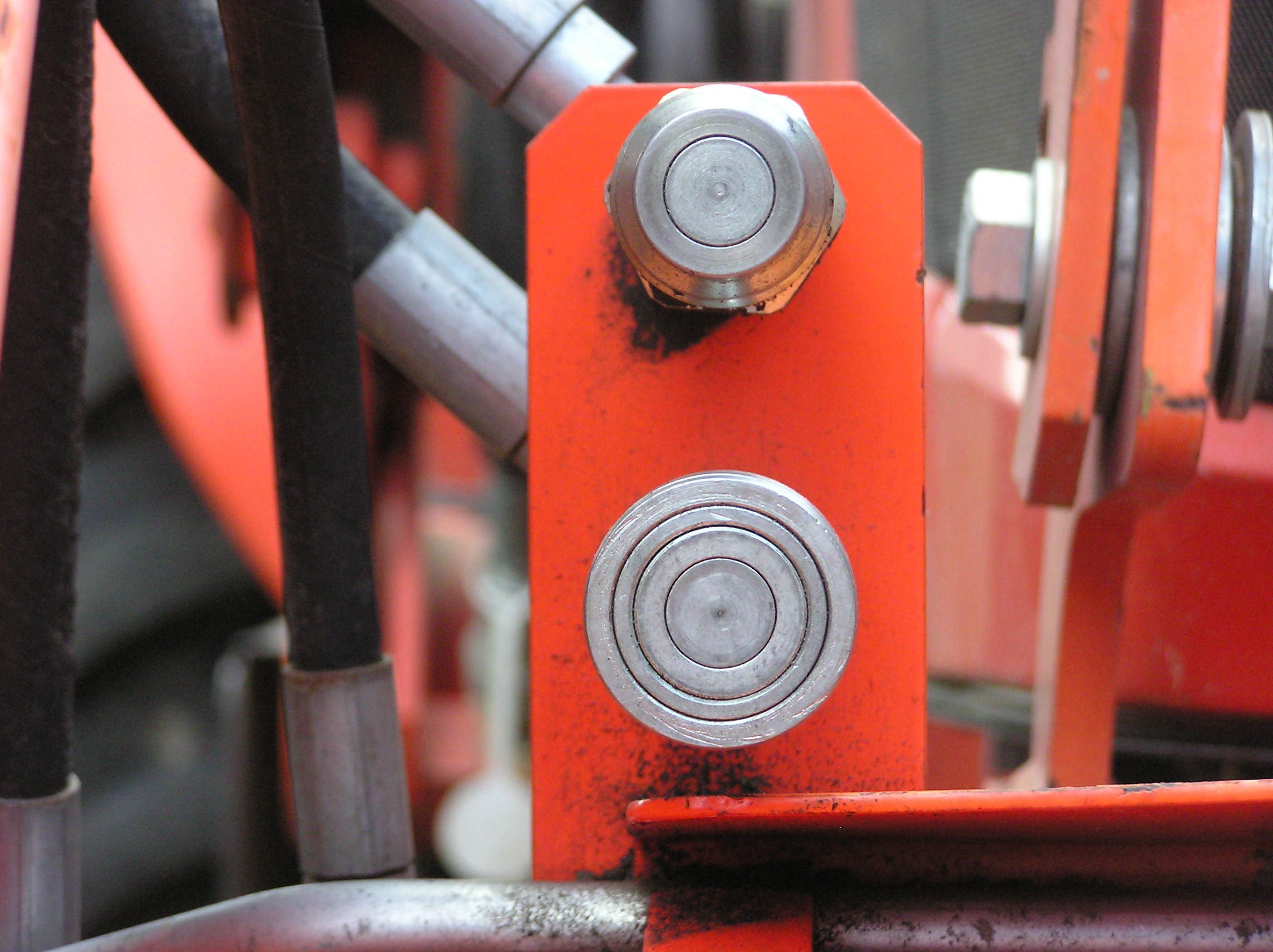

Kubota Factory 3rd function
I have a kubota 3rd function valve & connections on my M5140. The dealer installed it on the bare used tractor at the same time he installed the kubota Loader (LA1153) on it. I am installing a grapple next week and I want to plumb it so when I push the kubota loader control Joystick TOP Button it will open the grapple lids and the LOWER Button would close the grapple lids. Does anyone know if there is a standard or uniform way they install the system so the coupling mounted on the loader frame bulkhead are mounted the same on all installations? Example the top coupling in my case it is the Male coupling (see picture I have included) would be the pressurized line when I press the Top Button. I know if I just install the the hoses and couplings to my grapple I have a 50% chance of being right. I am just trying not have to reinstall my couplings and get hyd fluid all over the place. Or can I just reverse a electrical plug at the Joystick area?
I guess what I am trying to ask is here a standard or uniform way the Kubota Factory 3rd Function Install is installed? Thanks in advance

Your won't lose that much fluid swapping out the fittings.
Just do it over a bucket.
