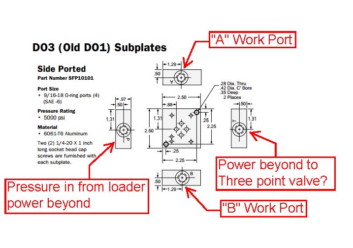

Where can I find a solenoid valve sub plate with pressure relief, power beyond and tank ports?
Everything that I've looked at only have four ports P-T-A-B
Or is ther another way to skin this cat?

A hyd subplate outlets are PB capable.
There is always an IN port and OUT port.
As far as a relief, there are external relief that can be added to any circuit.

All the ports on a subplate are capable of about 5000 psi.
You can insert the 3ed function valve anywhere after the FEL valve, but before the 3pt valve.
The 3ed function T port can go to tank if that is your only valve or last valve in the hyd circuit.
Any action you do with the 3ed function, will be reflected in the FEL valve relief.
You can also insert a relief valve anywhere in the hyd circuit for protection of a cyl or motor, etc..

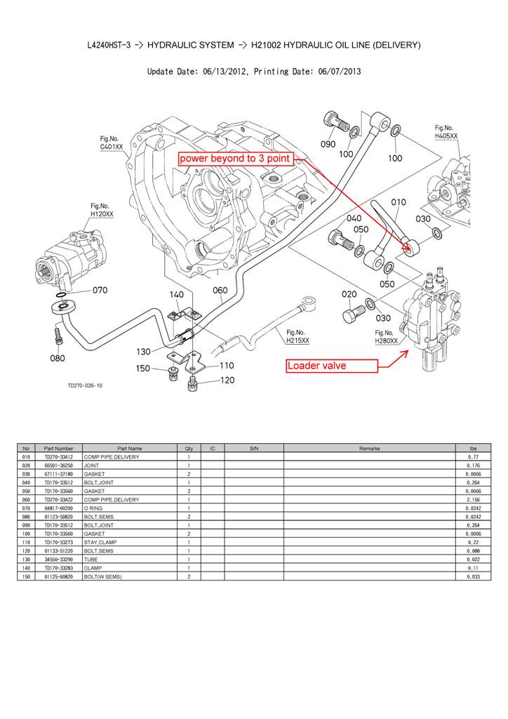

The Kubota L4240 that i have on order should be ready for delivery in a few weeks.
I'm on the fence whether to source the parts myself for the third function or just order the Kubota kit. I'm very comfortable installing either myself. I added four remotes to my L3800. Designed and fabricated the valve and quick connect mounting bracket locations and all plumbing routing.
We all say wow $900 for third function....I could probably do that for much less myself.
The kubota kit is only about $400 more than sourcing all of the parts myself.
I've looked at all of the Kubota parts diagrams and they use a ton of hard lines, between the pump and valve, valve to valve, along the loader arm, and have all of the brackets fabbed and painted, quick connects dust covers, complete new loader control lever with joystick, switches, relays, wiring, connectors, nuts, bolts, screws etc. If you look at the quantity of parts it's not really overpriced and makes for a very clean install.
The Kubota kit is a "true third function" not just a diverter valve. Which of course means curl, lift and grapple can all work at the same time......and yes I currently, at times use all three at the same time. If the grapple was controlled by a rocker switch on the loader control I can see opportunities to use it even more often.
The only two downsides of the factory kit is the additional cost and not being able to spend quality fab time in the shop building it.

Where does the PB go on your tractor "normally"? On mine it would go either to the backhoe - or directly to the 3pt.
From your description it sounds like the solenoid valve might have been installed in the line that normally goes to the 3pt - so now when you want to use the 3rd function you're "diverting" the fluid that would be going there - to the 3rd function instead.
If so- it sounds like you've the same type of setup on your tractor I was thinking of installing on mine - if possible would you be able to get any info off of the valve that solenoid valve you're talking about?

In my build the 3rd function would be before the three point connection.
So the "T" port from the third function sub plate would feed the three point valve???
Power beyond to the three point valve?
Thanks again for all of your patience answered everyone's questions. It's greatly appreciated!!!

JJ
Here's a diagram of the sub plate.
I added the comment boxes indicating my understanding how the flow of the valve should be.
Is my interpretation correct????????
Thanks for all of your wonderful advice Sir.

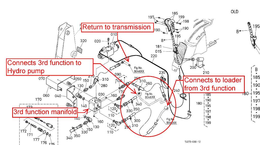

Well I finally got it all installed and it is a much cleaner installation than the factory setup.
I found some space underneath the seat for the solenoid valve.
Just needed to fabricate a mounting plate for the valve.
Used a D05 open center 12v solenoid valve from Ebay.
I did locate a space saver sub-plate that is only 1.25" thick D05 pattern SAE 8 connections.
I tapped into the backhoe loop after the backhoe.
I sourced the control handle from John Deere, see this post
http://www.tractorbynet.com/forums/...-need-measurement-l4240-loader-control-2.html
I cut the existing loader control handle shaft down to a more comfortable height below the offset. This also allows additional room to exit the right side of the open station.
I ran a high amperage circuit back to the left hand side of the seat. There is plenty of room to install relays there underneath the range shift console. This will also provide power for my ROPs mounted work lights.
Picked up an ignition on hot from the right hand behind the seat area. There are three connectors there for that use.
