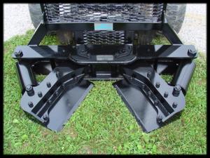

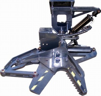

Hey guys,
I am new to the forums, been reading awhile. I posted some on the hydraulics pages because I wanted to build a tree shear. I dont know how I missed this post. I am still trying to figure this out. If anyone has plans or pictures of a homemade tree shear it would be greatly appreciated.

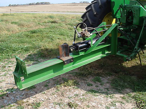

/ Tree Shear #20
Are you talking shear or splitter. Two different things, A shear will cut the tree down, and the splitter will split it up in smaller parts.
