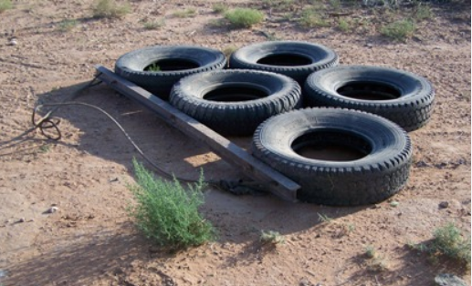

You can make a tire drag by bolting some old tires together.
/ Rehab Softball Diamond #5
A washer should do. I suppose you could use a hunk of 2x4. Some people have just wired them together.
