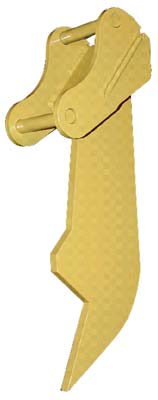

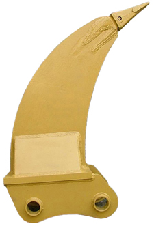

How about ripping roots with a single shank on a box blade down?
/ Tree pulling traction: loaded tires or ballast? #22
That might work for smaller trees, but mid to large, the roots are deeper, and if the shank can get down to the root, it might bend the housing for the shank. A single large root getter will concentrate all the power in a small space.
You will break your teeth, I know. And with a box blade slow and steady is the proper pace no running start. You want the BB to stall you before you twist or break something.
