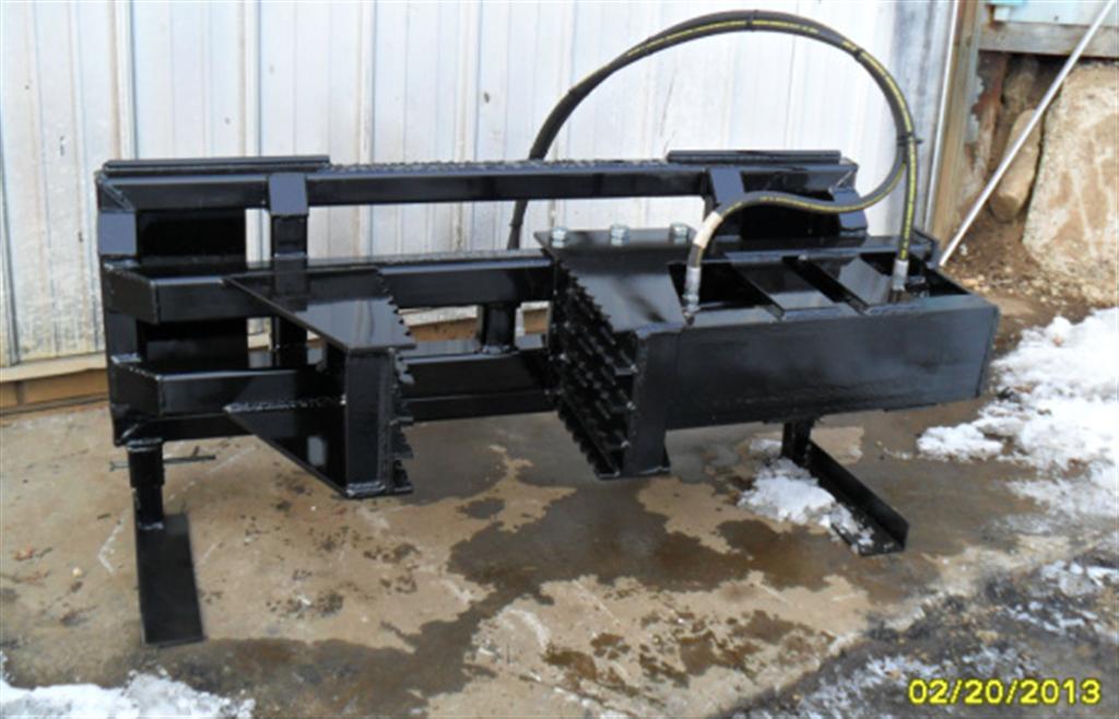

That's an interesting design. I would think you lose a lot of "power" with it so far out in front of the loader, however I know you have around 5k lb lift capacity so for you I guess it doesn't matter :laughing: Right, pops em right out! :thumbsup:
Did you come across any tree pullers that are meant to be used on a 3 point hitch? I think any of them could be adapted. This heavy duty one could be built for a 3 point, call Koeckeritz, he will do it.

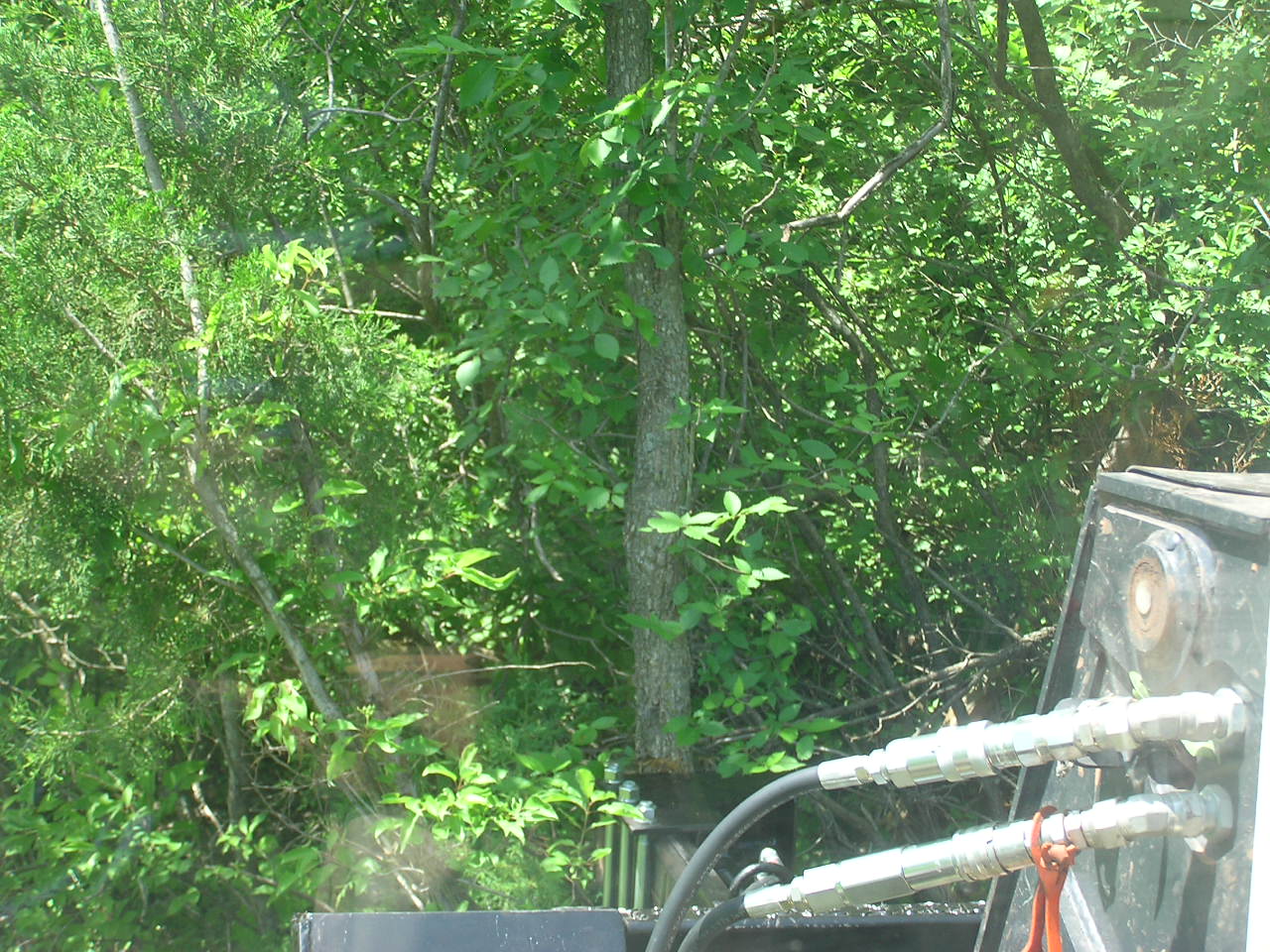

I was worried that I would have trouble getting the clamp around the trunk, but it opens to 8", and with 4 wheel steering I just drive up next to the trunk and turn right. Then grip and pull.
I guess everyone realizes these pictures were taken sitting in the seat, so it is what I see out the windshield.

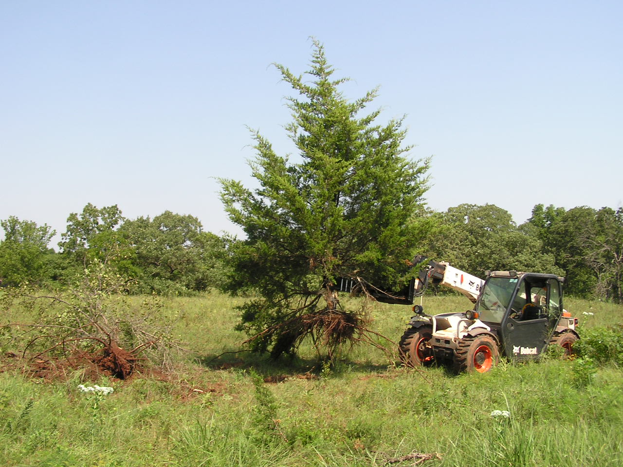

Some tree puller pictures from last month.
A small cedar tree, the view from the seat.
Shook the dirt off of the roots.
The trunk on this one is too big for the pullers 8" opening, but is mostly dead, with some new growth at the old break.
Grabbed one of the new limbs, and the old trunk broke at ground level.
Moved it to the burn pile yesterday.

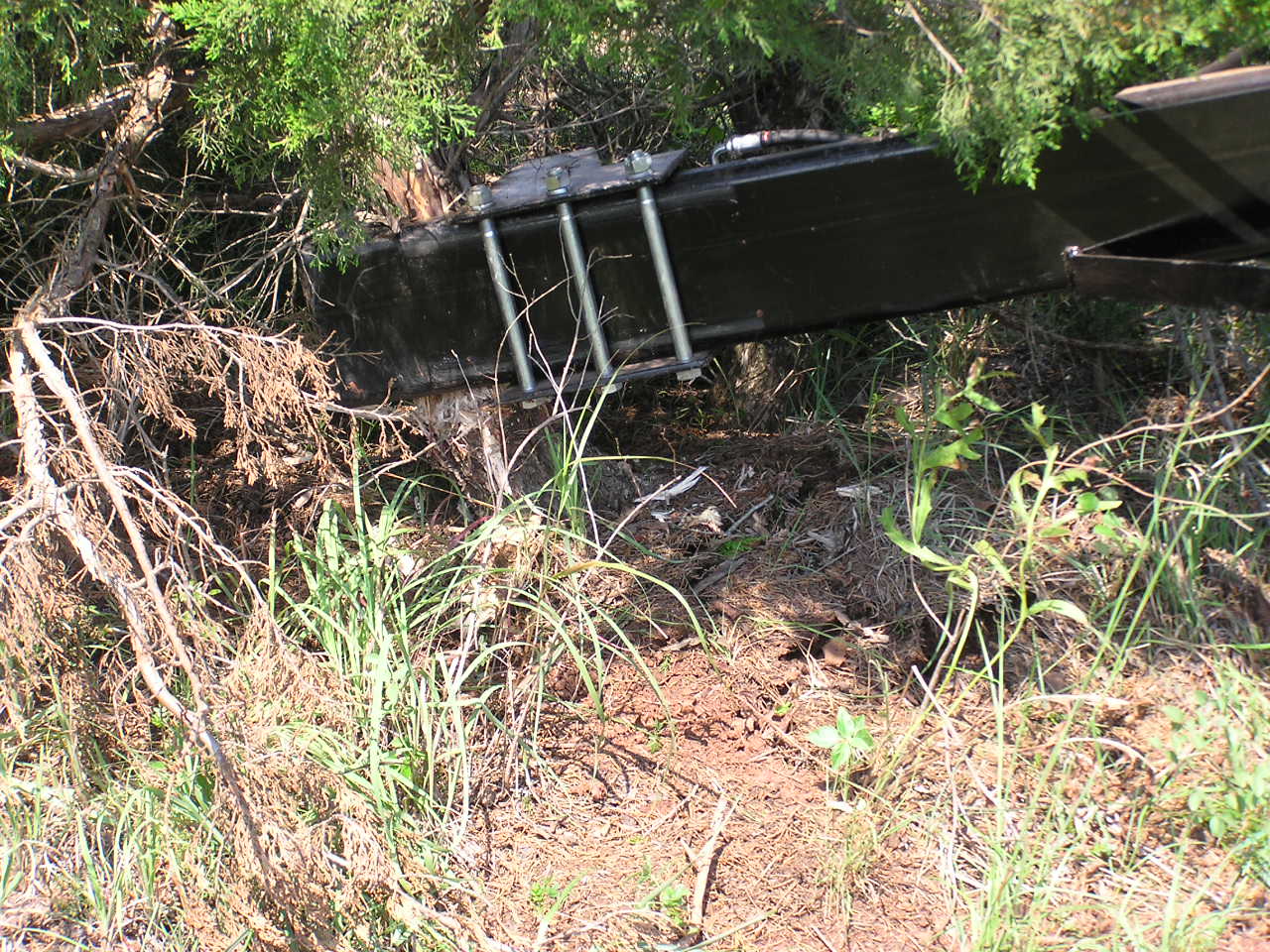

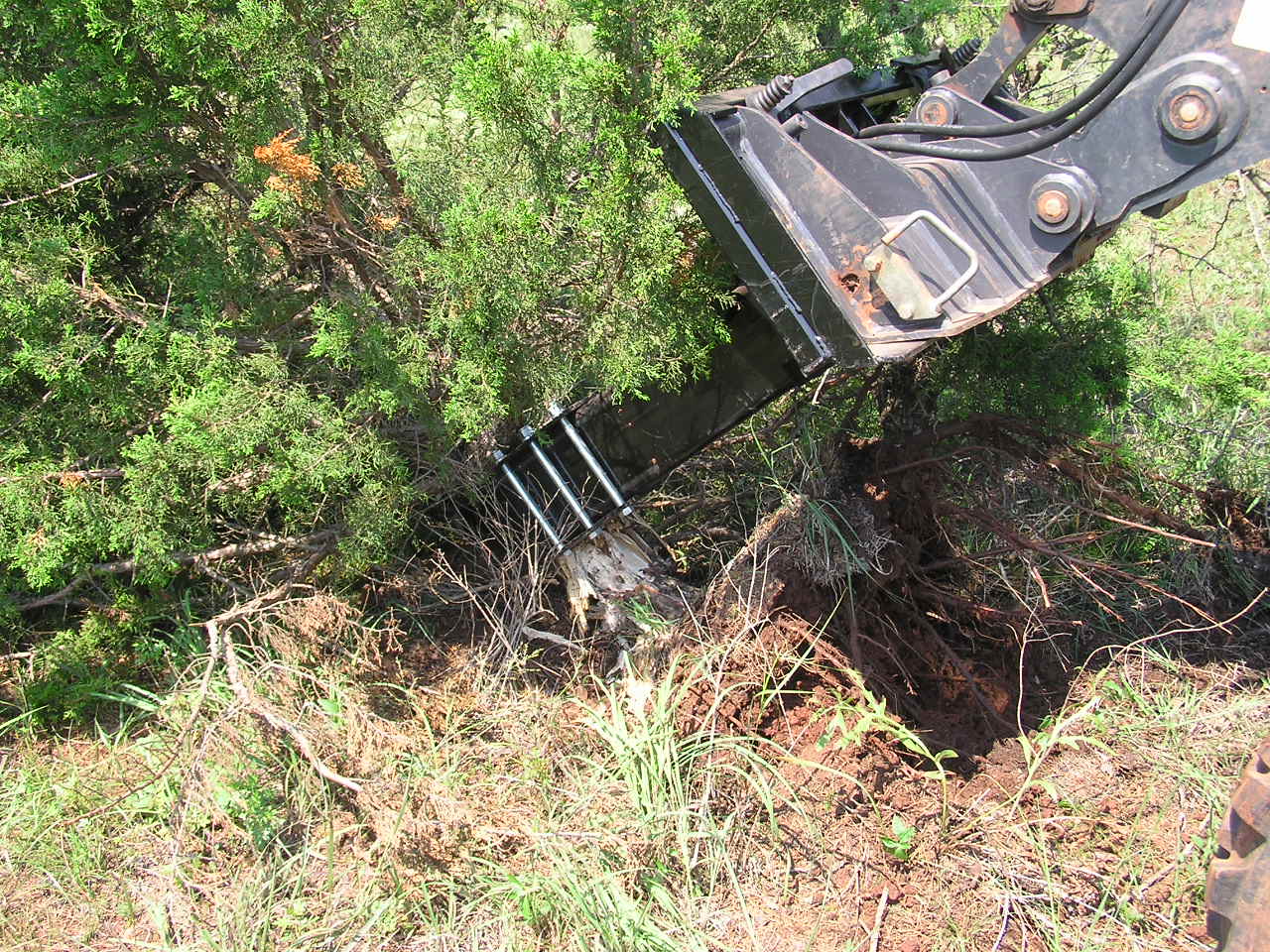

Used the tree puller on the biggest cedar tree that I have tried to pull so far. It is about 5" in diameter.
Raised the rear end when I tried to pull it straight up, so I curled down while pulling up and moving forward. That broke some roots loose. You can see the crack in the ground.
Curled up while pulling up and moving backwards. That broke some roots on the other side.
Went forward again and it started coming up.

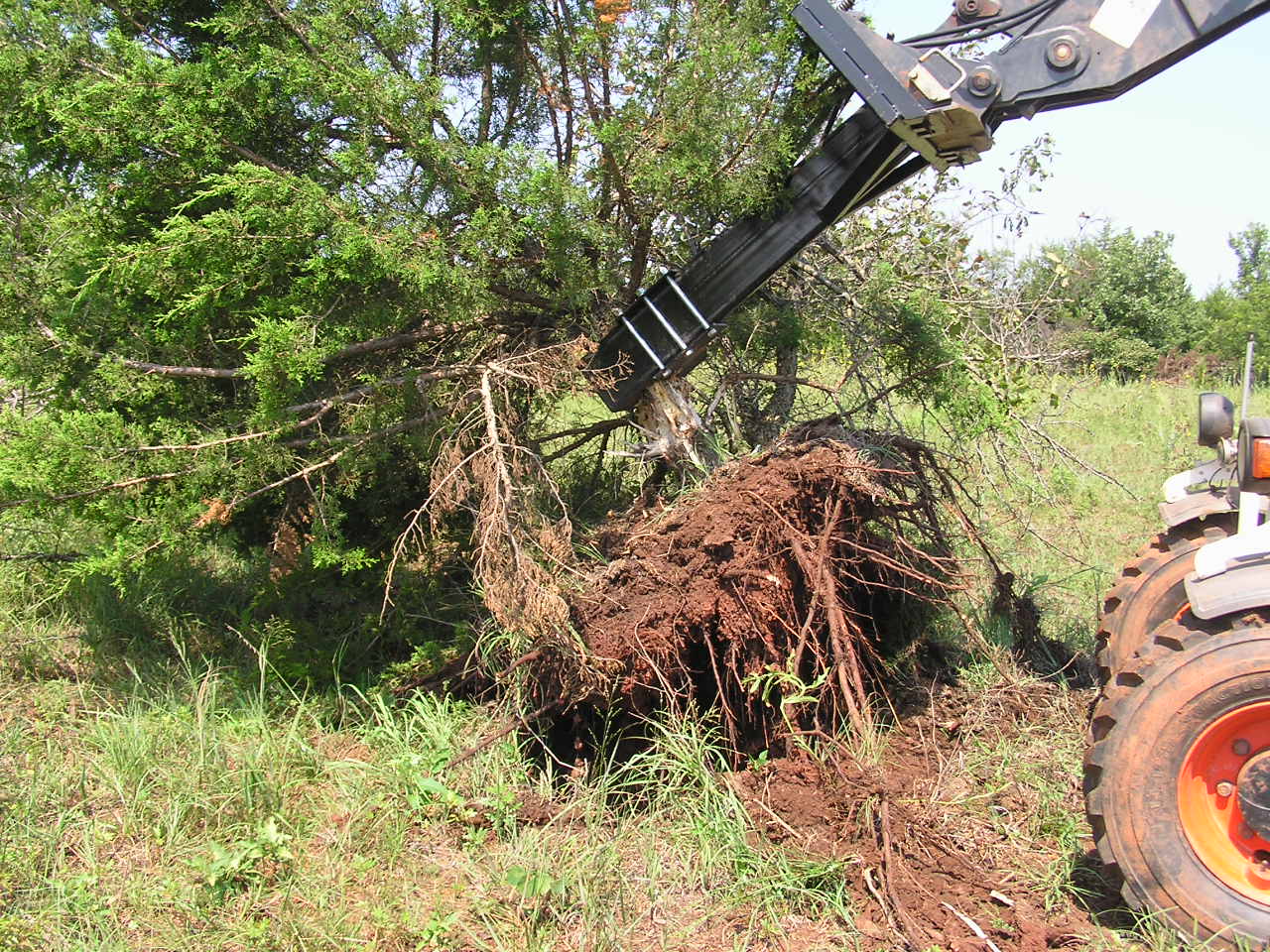

Raised the boom, the cedar came out of the ground and brought another tree with it!

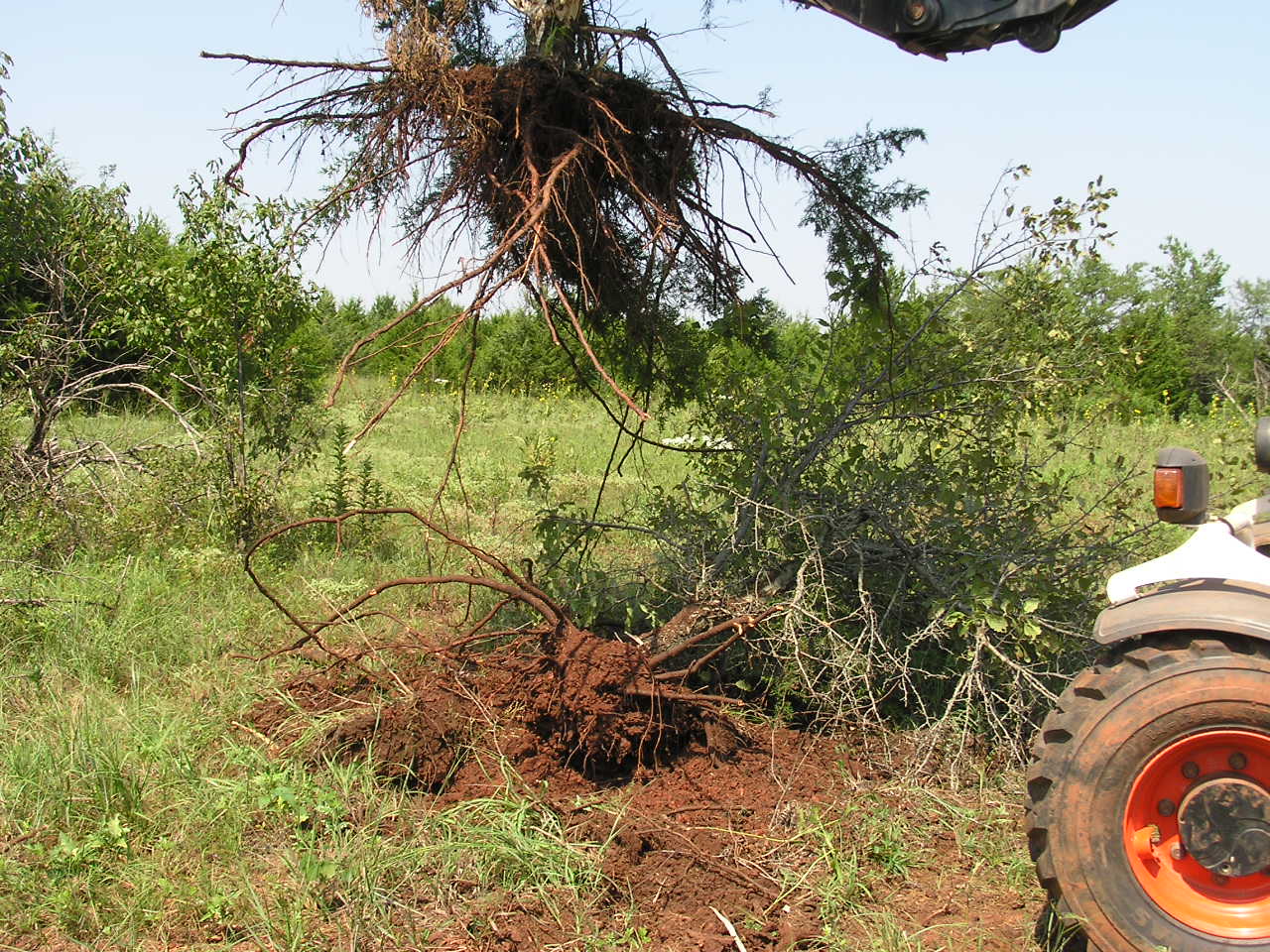

Shook the dirt off of the roots and the other tree fell to the ground.
It looks to be about 3" in diameter.
1 pull, 2 trees! :D

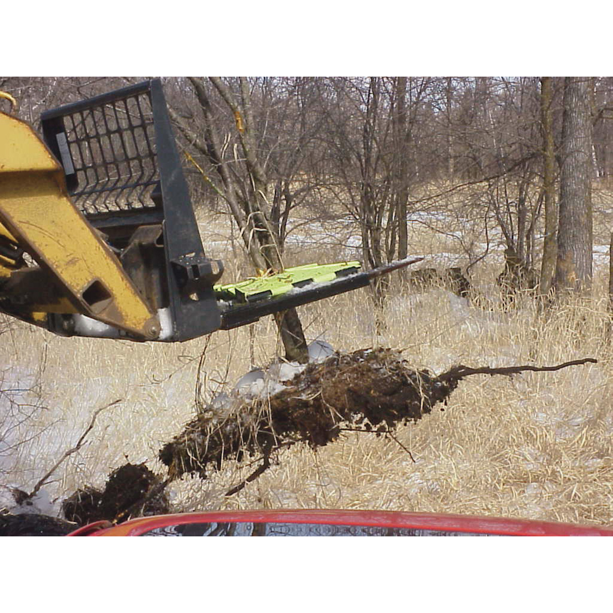

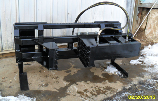

Right on flow, it doesn't matter how fast it closes. Lift capacity is the main thing. Try removing the bucket and use a chain on some 3" trees and see what it will do.
It depends on what type of tree you are pulling.
It should do well with this style, but might be hard to see the trunk from the tractor seat.
From Buckthorn Puller - Custom built Skid Steer attachments to fit almost any need you may have. and Holden Services :: The Hoss Tree Puller

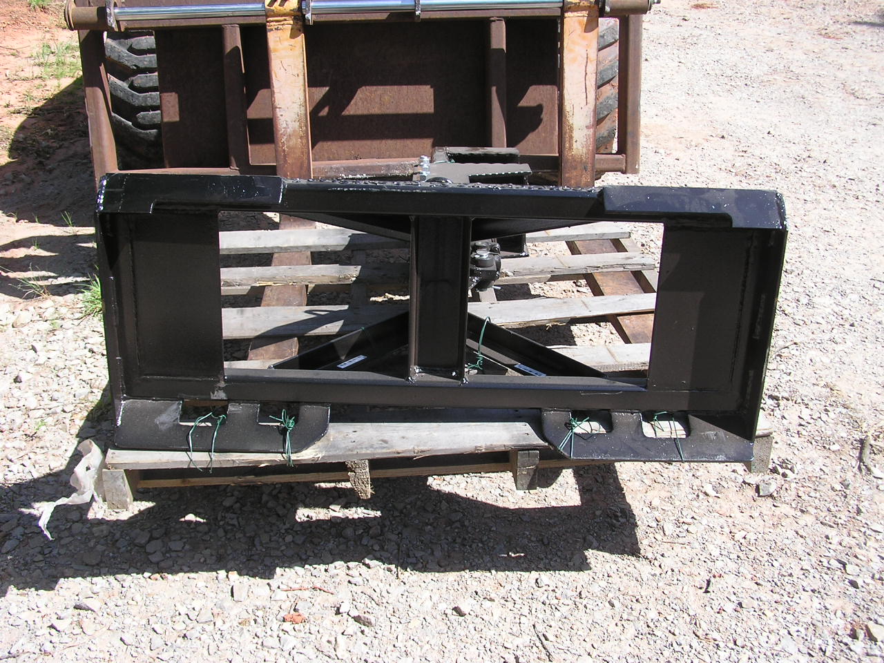

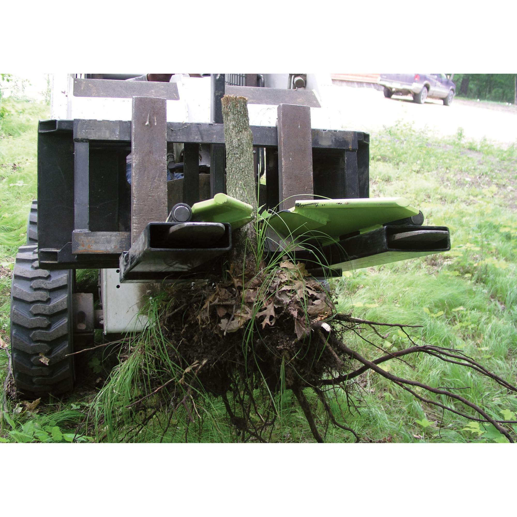

If you have a set of forks, these might work, cedar trees don't have a big tap root, so they pull fairly easy.
If you don't have forks, it would be a reason to get some! :D
If your loader won't pull it, you can drive forward and pull it out.
It might cost less to buy something that you can get the smaller trees, then rent a skid steer for the rest.

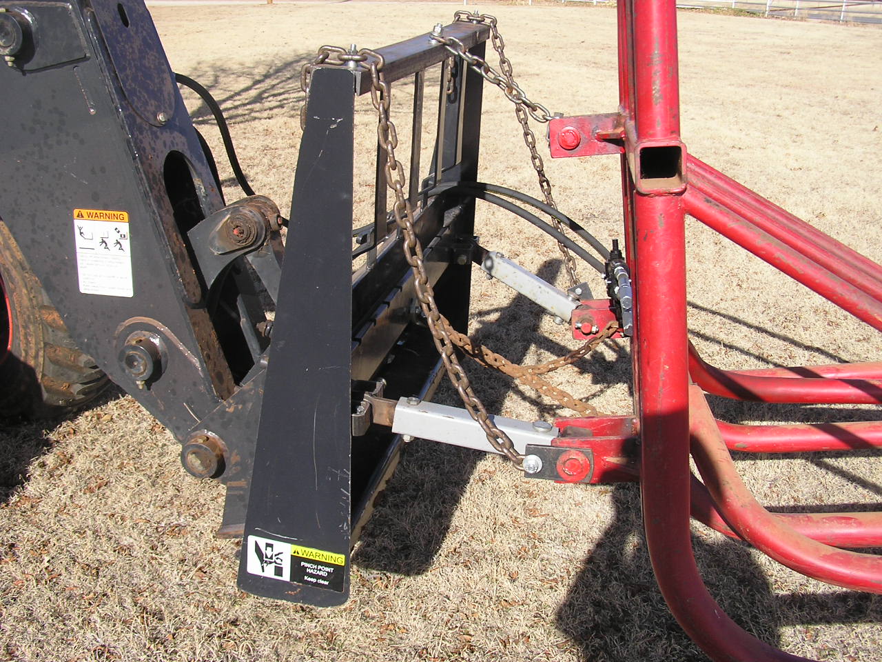

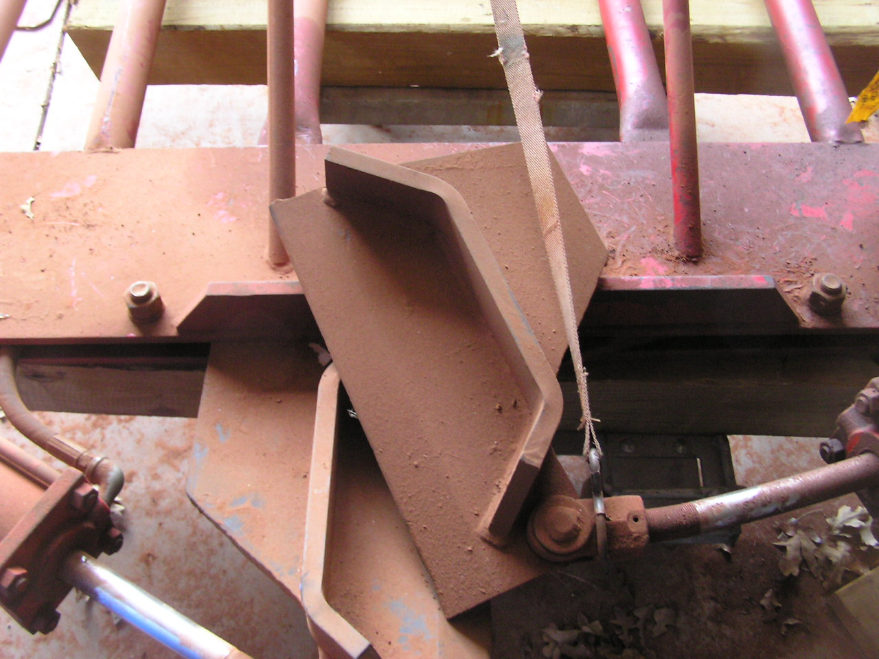

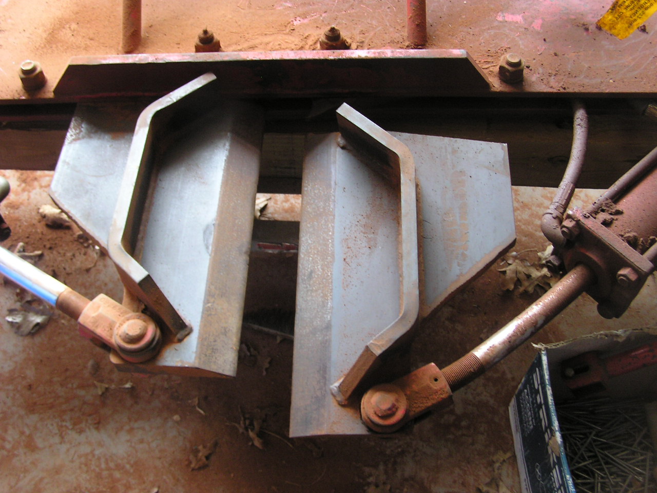

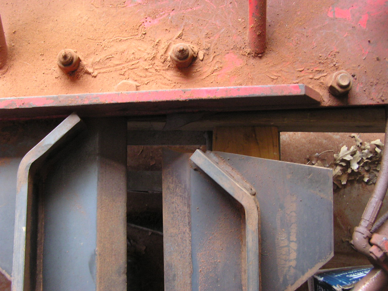

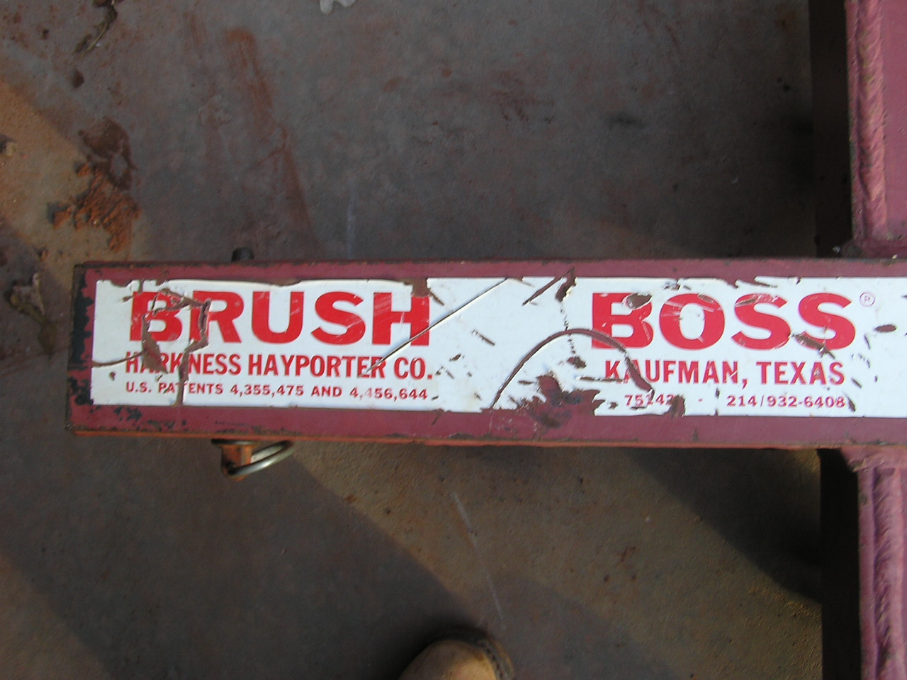

Many years ago I had this on a MF240D 3 point.
It was too much of a hassle backing up to each tree, so I turned it around. any tree that I could drive over it would pull out.
Let us know what you come up with.
