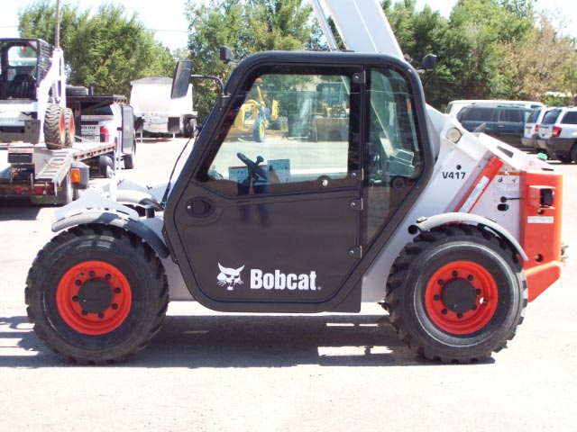

Need advice on choosing a heavy duty tree puller for my Bobcat V417. It has a SSQA, over 5,000 pound lift capacity.
Anyone have real world experience with one?

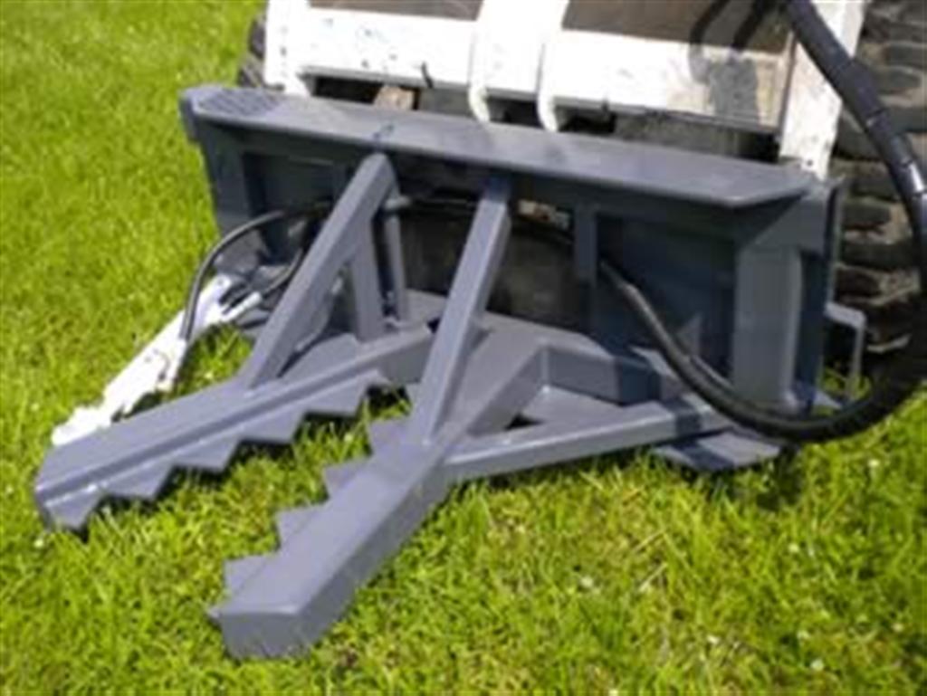

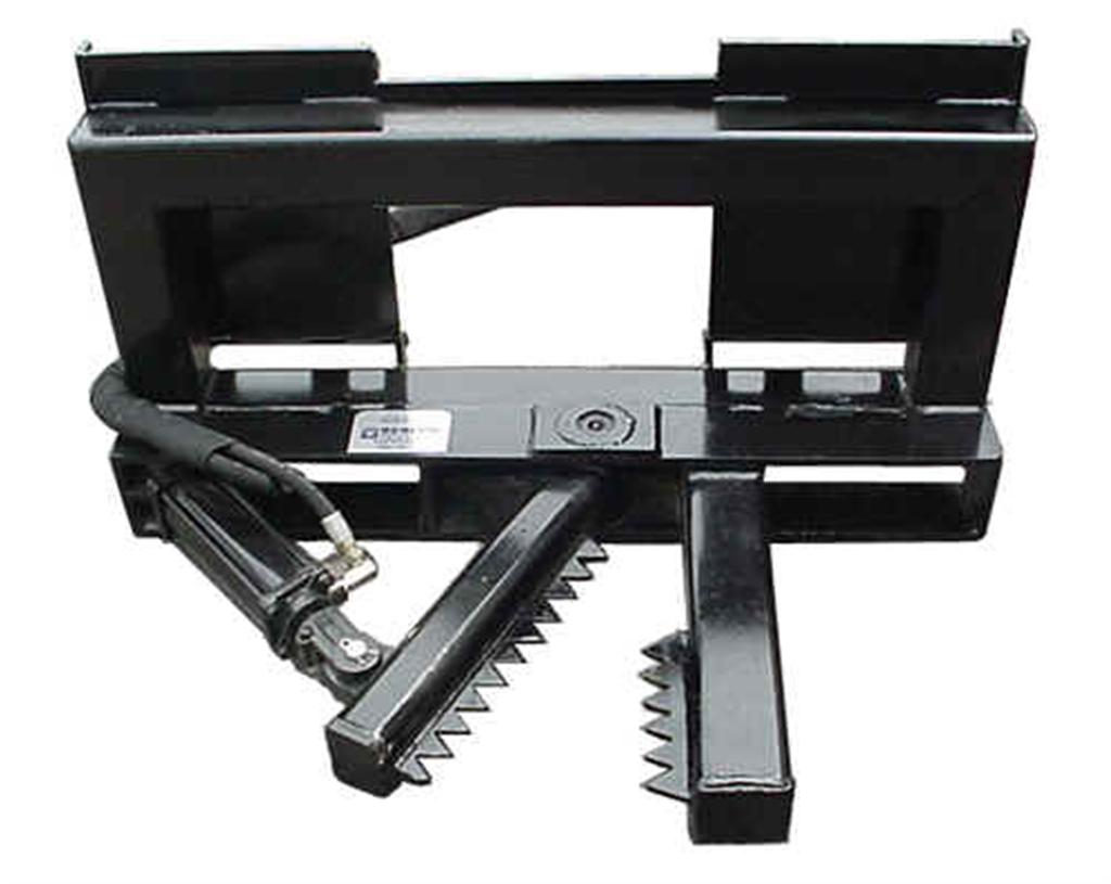

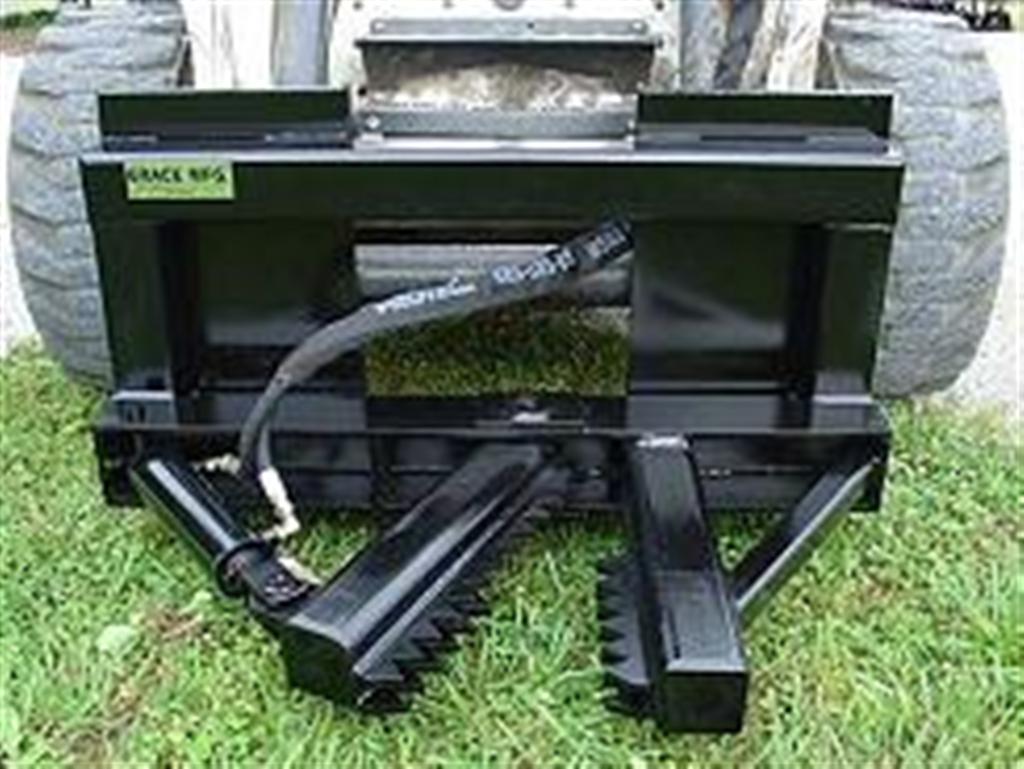

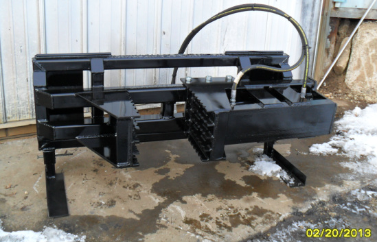

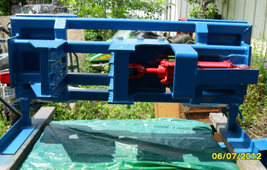

Here are two that I am looking at.
Tree Terminator - Tree and post puller for skid steers and tractors
Super Duty Tree Grapple / Post Puller - attachments for skid steers - Sidney Manufacturing Co. LLC
Has anyone used one like these?
Any recommendations?

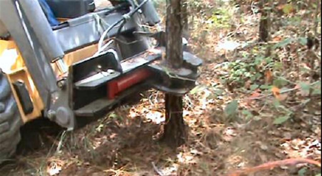

A different style.

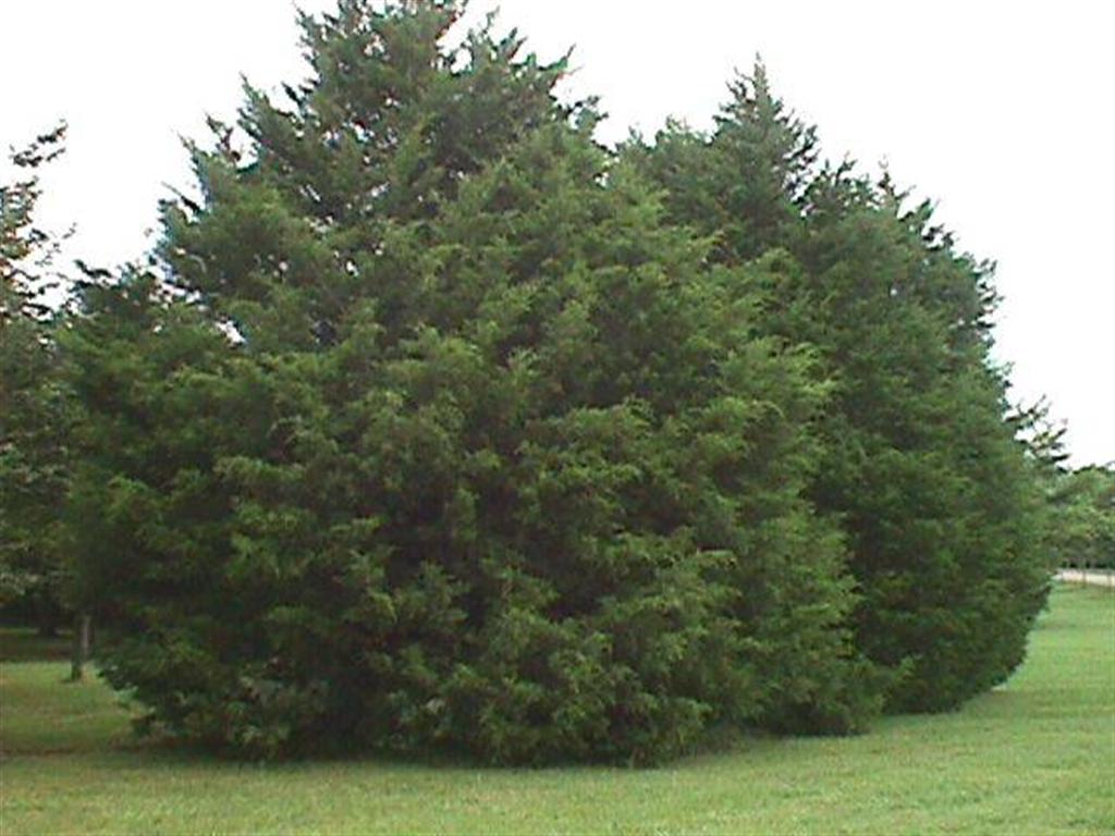

Yep, I have seen that type, but it wouldn't work well on cedar trees with long limbs at ground level like these.
I need the puller for small trees that will grow back if cut off.

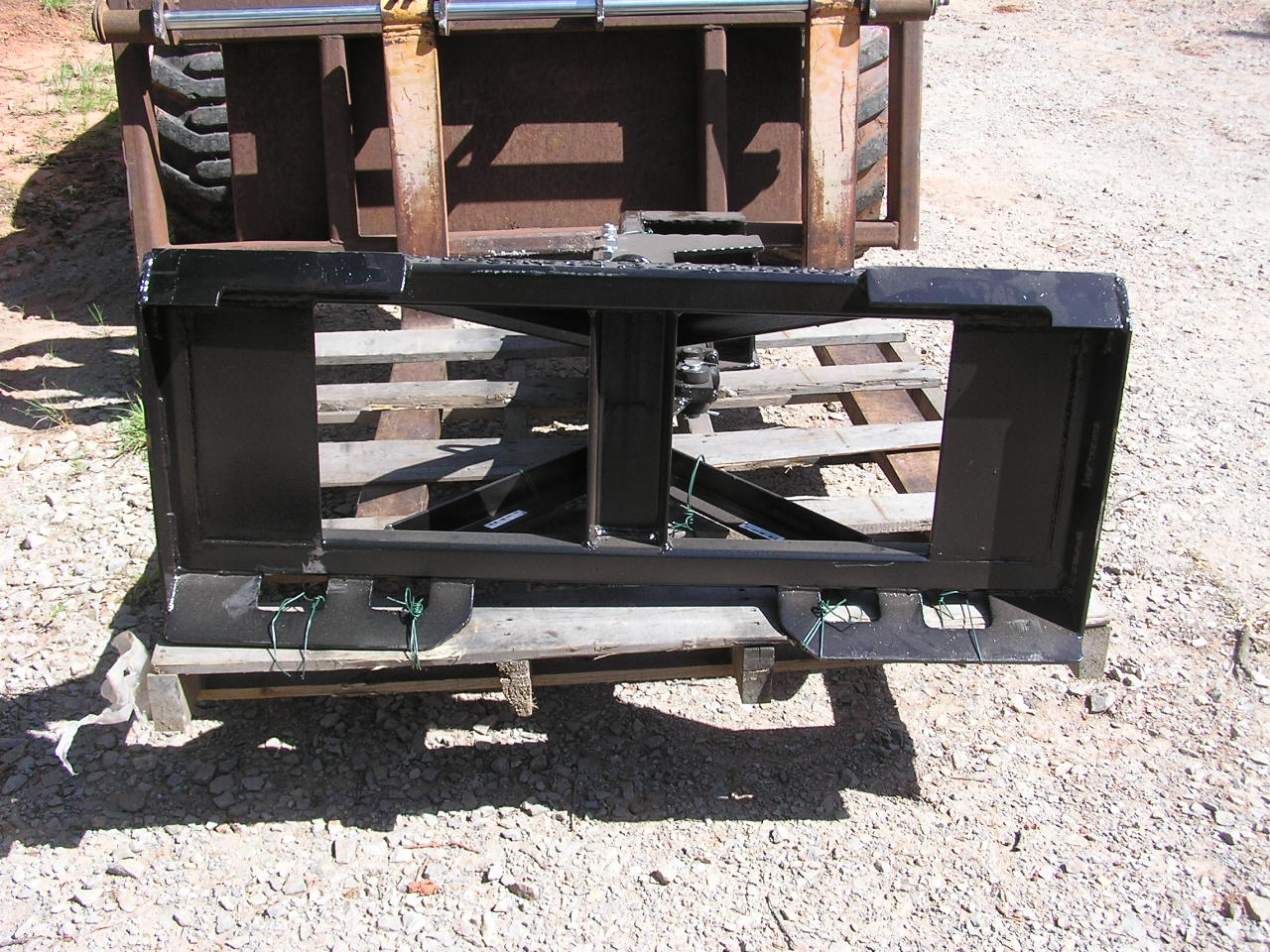

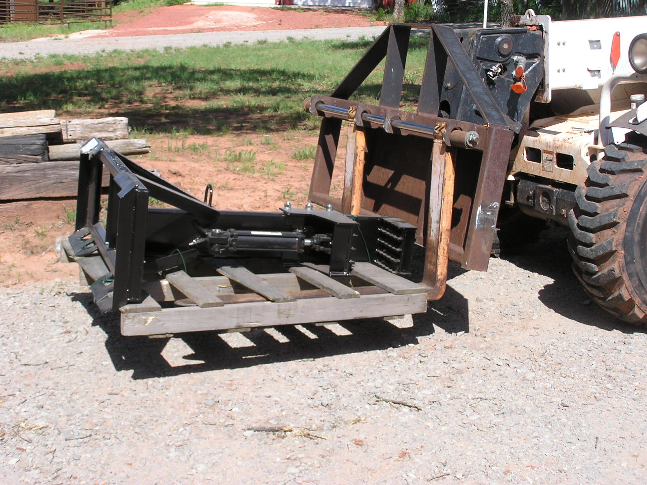

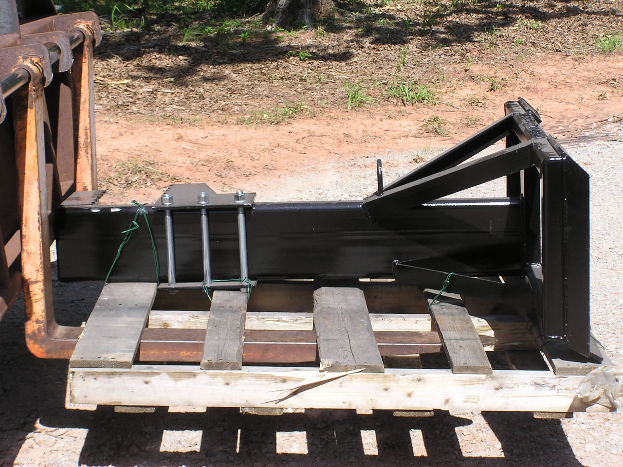

Update, tree puller was delivered yesterday. :D
Hydraulic shop supplied the fittings and cut a 12' hose that I had saved for many years.

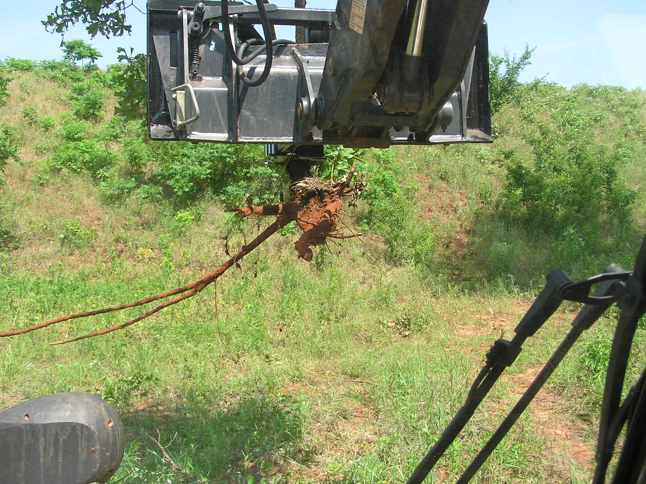

First tree pulled. :thumbsup:
It works good, like I thought it would! :D
I bought this style, because I can see the opening where it grabs the tree, from the seat in the V417.
/ Tree Puller? #17
That is a interesting tool.
Can it be rotated for picking up logs and such?
How large a tree can it pull?
I don't see where any great torque is generated due to the position of the tree from the pivot point.
I would think the grabber part would be in close to the pivot point.
/ Tree Puller? #18
That's an interesting design. I would think you lose a lot of "power" with it so far out in front of the loader, however I know you have around 5k lb lift capacity so for you I guess it doesn't matter :laughing:
Did you come across any tree pullers that are meant to be used on a 3 point hitch?
Also, did you get a price for the Tree Terminator? I'm interested in that style, they don't list a price on their site.
/ Tree Puller? #19
I've never saw that design either. Wouldn't work very good on a tractor, but would be okay on a skidsteer. Even then, I think you'd get tired of getting it positioned on a tree. A couple weeks ago I pulled over 100 trees for my neighbor in 3 hours. I was tired of hitting the tree with my V design puller, can't imagine having to squirm myself onto everyone of those with this design. But if it works great for you, that's what's important!!!
/ Tree Puller?
#20
That is a interesting tool. Yep, just what I was looking for.
Can it be rotated for picking up logs and such? No.
How large a tree can it pull? This one is rated for 4".
I don't see where any great torque is generated due to the position of the tree from the pivot point. Not a problem on the Versahandler.
I would think the grabber part would be in close to the pivot point. Right, they make 3 models that are.
I was going to order the other style, but didn't because the gripping clamp is in a blind spot on the Versahandler. Then I saw the "Long Arm Buckthorn, Tree & Post Puller", and got it. As you can tell from the pictures, I can see the tree when I clamp on to it.
