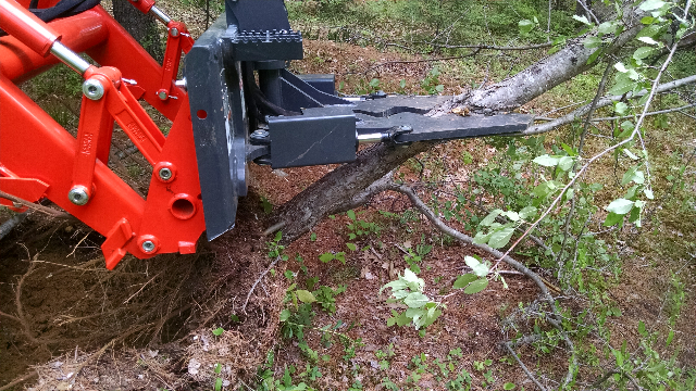

So when I purchased my Kubota MX4800 I also bought a Bradco Jaws large model. I have about 30acres of overgrown woodland that was poorly logged in the past. Buying the tree and post puller was a major gamble because I was not sure how well it would work especially not being on a skid steer.
I'm sure a tracked skid steer would work better but I an truly amazed what it and my MX with loaded tires will pull up. Attached is a YouTube link and some pictures.

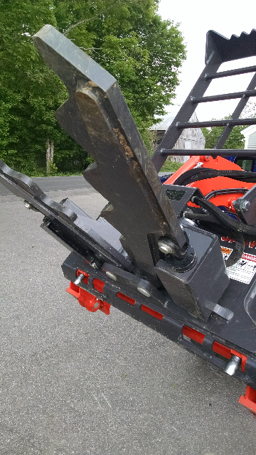

Appears to be very well built. The hinge pins are a bit short, but they appear to be large. Are they greasable?
Double jaw is great for clumps of small brush, wider bite.
You'll soon find yourself trying to pull trees that require some rocking back and forth to accomplish. Be very careful about applying compression loads on your tilt cylinders. You'll bend the rams.

The hinge pins are greasable but the piston pivots are not. I wish they were because they are also down in the dirt.
Seemed to me that the way i was using it was fairly safe. Do y'all agree? I do hear what you are saying about compression forces. I'm also concerned about twisting force on the jaws. So far, so good.

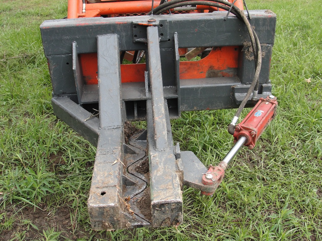

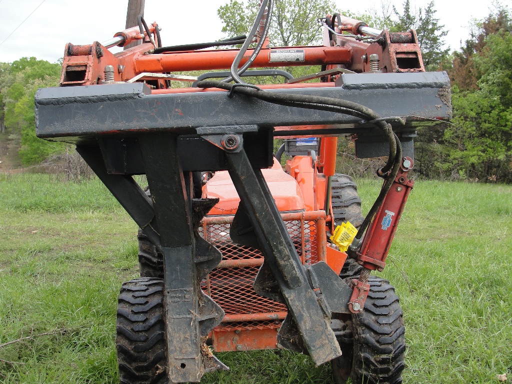

I built my tree puller. I've also got a Grapple. Considered adding 3pt tabs on the puller for that purpose. Just haven't done it because I don't think I want to be that close to the tree being pulled. Not because of danger. Just because of being poked and gouged by tree limbs.

Larry, there's a welding shop here locally that builds single cylinder models like mine for $1275. You might do some research in your area. If you can't come up with anything PM me and I'll see if there's a way we can ship you one if interested. They are very well built and braced.

In these pics you can see what I talked about earlier with the double swinging jaws. I don't have near the bite width with just a single swinging jaw.

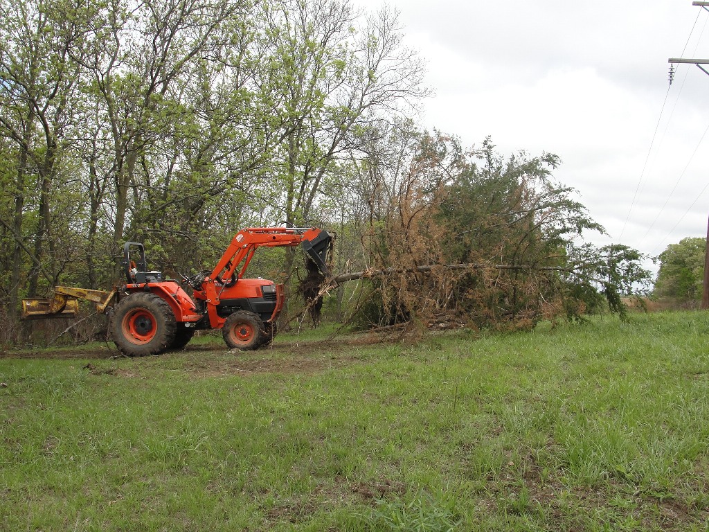

I started out using mine on a L4400 Kubota. My greatest caution was that I could pull trees that were large enough to upset the tractor if not properly handled. Now I use it on the M9540 and don't worry about that as much.
