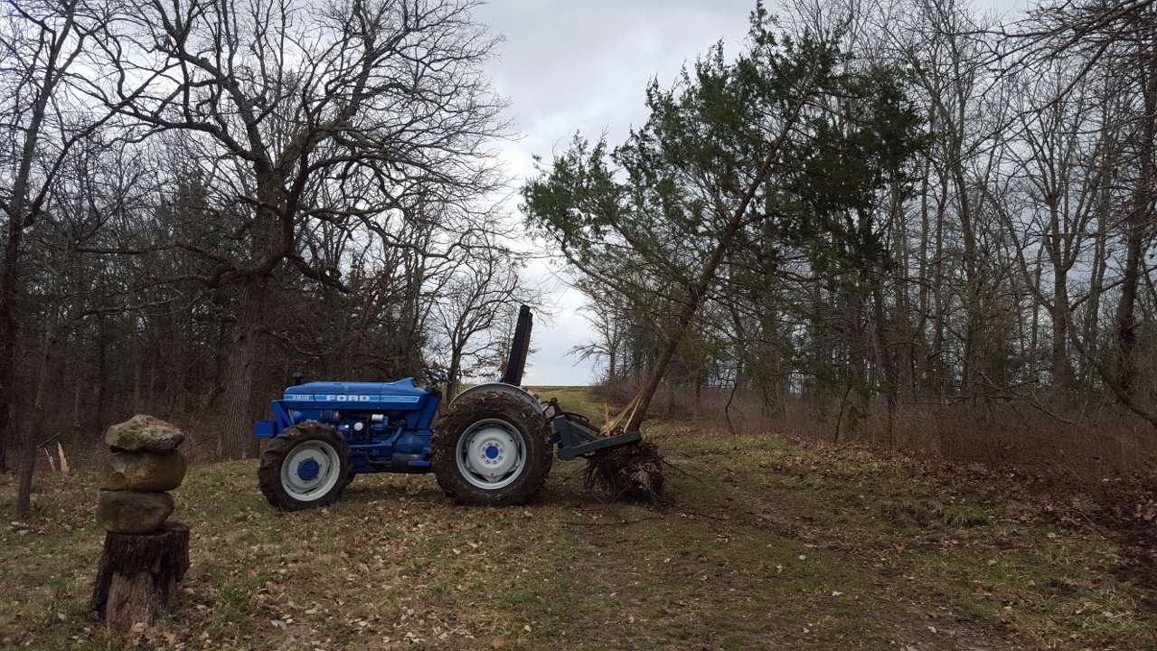

I have one of these mounted on the front of my Deere 3520. It's a bit much for it, but it does a pretty decent job. The limitations are due to the size of the tractor and FEL, not due to the device itself. Your Kubota is a bit bigger than my Deere, so you'll experience less of the limiting factors. I use mine primarily for pulling up honeysuckle and dead ash trees.
As others have mentioned.... Expect to rock back and forth to break the trees loose. Even a "small" tree can get a bit stubborn. Also, be VERY AWARE of what my come down out of that tree when you're shaking it. It's pretty scary to have stuff come down on you!! I now wear a forestry helmet with a face guard when I'm using my puller. I also keep the ROPS raised. Also, with my dead ash trees, I generally try to cut them down to 3' or 4' now as that minimizes the amount of stuff coming down on me.
Also mentioned was the use of copious amounts of ballast. I'll second this suggestion. Without ballast expect to have your rear end come up on a regular basis.
One of the reasons I went with the Notch Tree Puller was the fact that the pulling point is centered on the puller rather than being offset to one side. I wanted to minimize the chances of tweaking my FEL frame.
