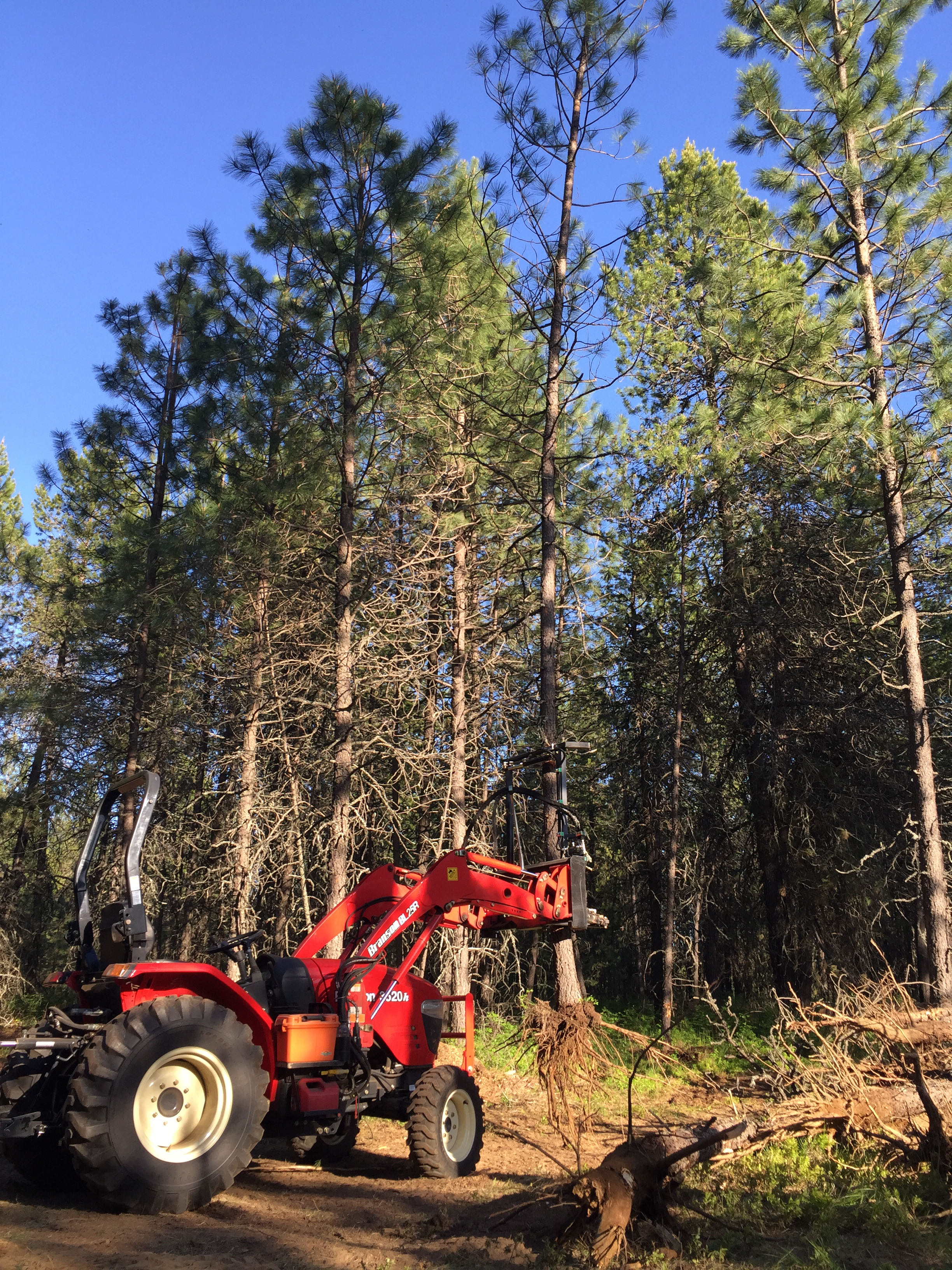

I just bought this exact setup last week. I have mostly sandy and rocky soil in New Hampshire. I bought it specifically to thin out my woods. I have hundreds and hundreds of evergreen saplings that need to be moved. My Mahindra 2538 pulls everything up to 5" out like butter. I've found that if a tree is stubborn, just clamping the jaws on it and rocking it will loosen it up enough to at least be able to drag it out if you can't lift it directly up. Regardless, it beats the heck out of getting on and of the tractor with a chain. I'd recommend it. Look at post #185 here. http://www.tractorbynet.com/forums/mahindra-owning-operating/377997-what-did-you-do-your-19.html

Depending on how close the trees are, you could cut each tree with a saw at about 3' dropping it on the ground. Then use the 'puller' to remove the short stalk and root ball. This way you don't risk the bigger trees falling back toward the tractor and you can use the puller to bring the tree to a place to burn or cut into smaller pieces, safely..
I have a Titan tree shear, and it is a powerful tool. It has a 5" diameter cylinder to close it's jaw and cut up to 12" trees, but it needs to be carefully positioned, and wind has to be taken into account, as well as topography to make sure nothing comes back at the operator/tractor. Having a canopy and tilting the shear away from the tractor helps protect the OP, but things can get away from one quickly...
What is the seller asking for the puller and why is he selling it?
Also, if you buy it, put any tree you're pulling as close to the back of the jaw/upright, (fence) as possible to give the most control over the tree you're pulling, and give a downward tilt to the front of the jaw - away from the tractor to provide control over which way the tree leans. Test out the open/close time so you know in advance the recovery time- in case you need to let a tree fall away from you/your tractor as needed.

I built a puller. Next to the Grapple, it's most used FEL tool. Wouldn't be without one. A new one locally built here can be bought for $1200.
Here's an example on my old L4400 Kubota.
I built it to also be used on 3pt. Would be very easy to add that modification to the one you pictured.

With such a variety of locations and tree species this might not be correct guidance. I've pulled thousands of trees. I've never ran across this problem you speak of. Generally the machinery running the puller is limited on what size tree it can pull. In the 6" and down category there won't be enough roots left to allow regrowth. Speaking strictly in Missouri.
teg is exactly right about ToH: It grows and expands by both seedlings and rootings. And it also reacts very aggressively against being attacked or killed.
The plan here is to uproot as many as I can, then bushhog the now cleared area to keep them from coming back up. After a couple cuttings, they will finally die out due to exhaustion.
Another outstanding post! Your 2538 is just slightly smaller than my L4330. The 2"-6" trees are what I'm targeting since they are too big for my bushhog and too many of them for me to walk around cutting/drilling/spraying them.
