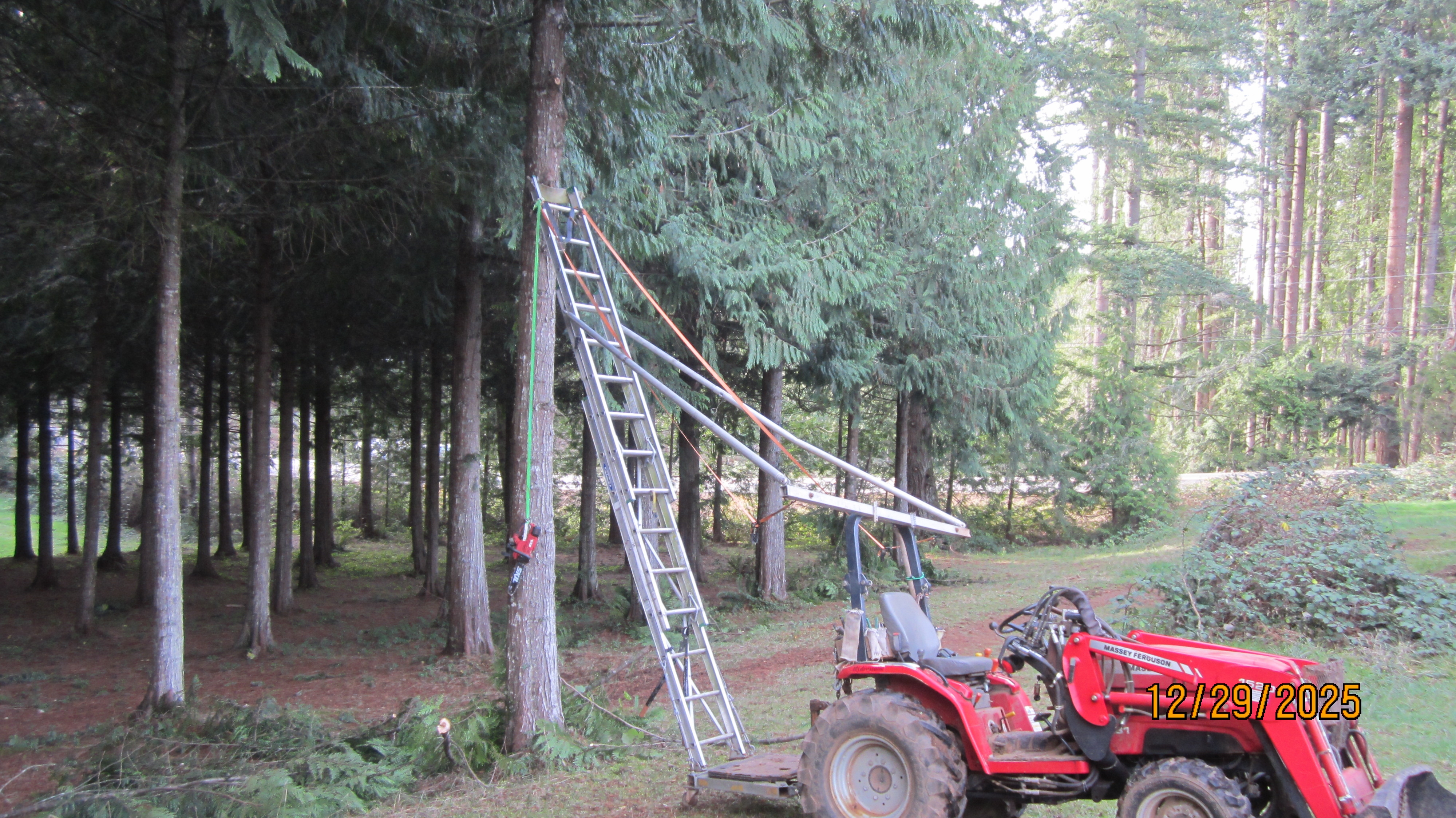

Started my yearly job of pruning
Good on you! I hate going up a ladder leaned against a tree, which way is it going to slide and spin me off. This looks as safe as you can get with what you have. Nothing can move ,no creeping hydraulic, ladder stabilized, I'm not sure what the fuss is about??

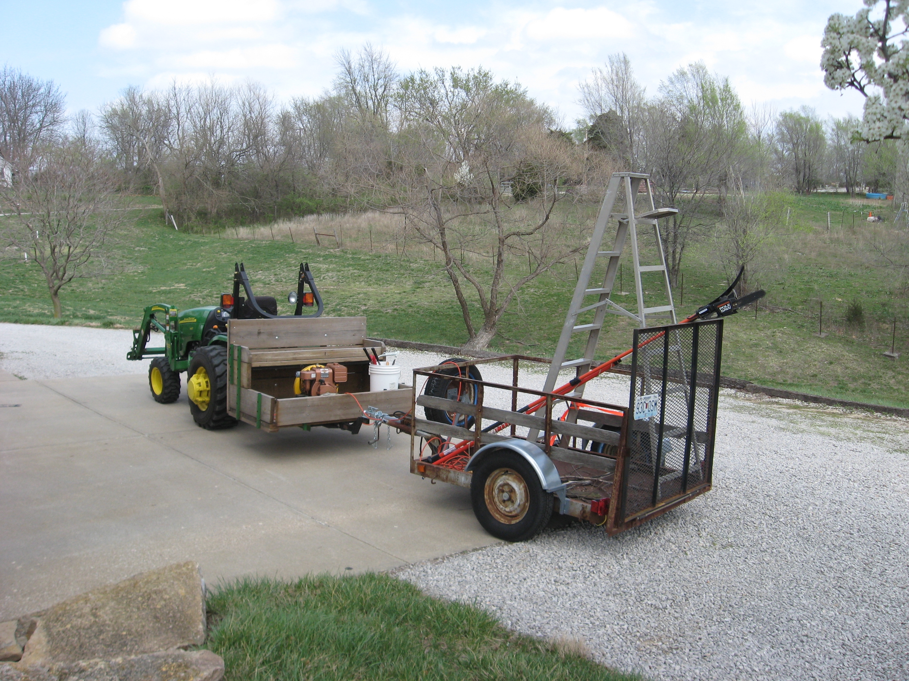

I sometimes employ a similar method, except I use a step ladder in a trailer, stabilized by ratchet straps. Piccy shows my 8 foot ladder, but sometimes I lean my 10 foot step ladder up against the mesh ramp on the back and secure it with ratchet straps and clamps.
It ain't the best way to do it, but much more stable than just trying to use the ladder supported directly on the ground.
A typical place I might use this rig is the tree in the background just left of the nose of the tractor. That tree is so small, there is no good way to climb it with my climbing gear and it has lots of dead twigs waaaaay out on the ends of the branches that are too high to reach with the pole saw alone.
In a situation like that shown in the OP, I would just use my climbing gear and Echo CS271T to remove the branches. Industry standard (in US) for arborist rope climbing and pruning (assuming using only the rope to climb and not spurs) is to be "double tied-in" before using the saw. An example of being "double tied in would be as shown in the photo in post #25. where the climber is supported by a Moving Rope System rig tied in higher up in the tree AND the lanyard going from his belt around the tree.
I probably wouldn't try (or have any reason to try) to cut any large branches using the ladder method, just because I wouldn't want to get knocked off the ladder.

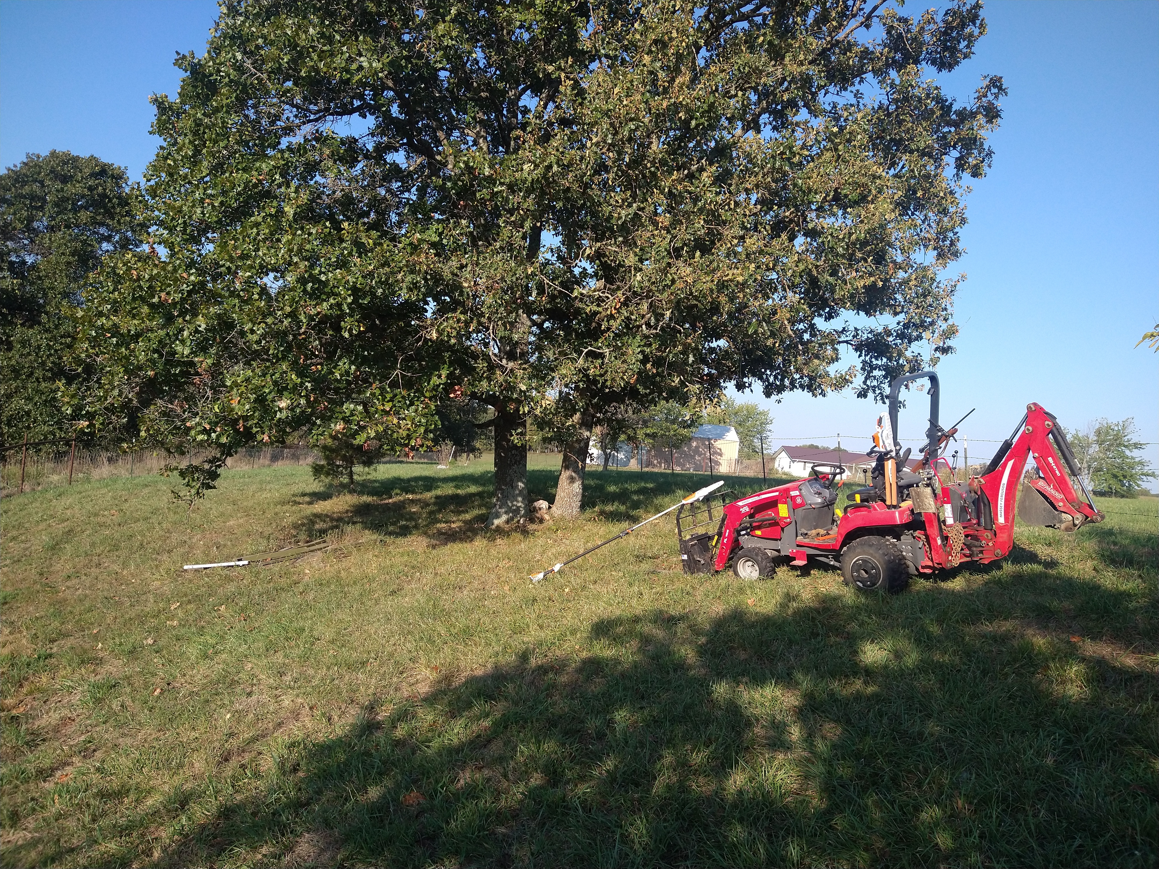

Yeah, that's what I 'm in the sleeper of right now ...
I don't have the 2' extension for the pruner, they didn't have it in stock when I bought it, not sure if I'm gonna get it now or not ...
Did use the saw a little on this one, but no ladder needed ... As It just needed to clear my cab tractor ...
I don't go out of my way to see if I can hurt myself ... But it does happen by accident sometimes ...I'm all alone, and prefer it that way .
