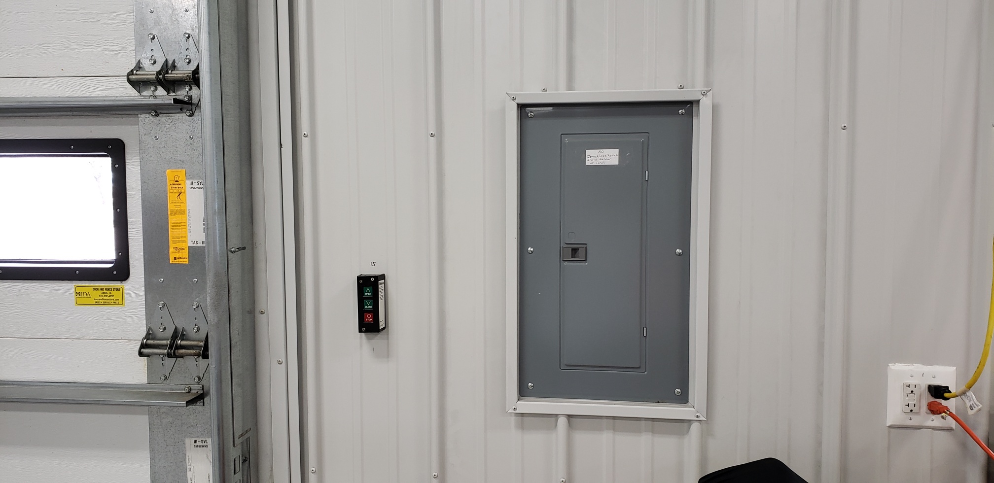

What you described is, as far as i know, not against code. It's quite common to have multiple outlets on a single breaker. Generator transfer switches are required to be designed in a way that it is physically impossible to energize the (assumed down) grid. But there is no transfer switch here. Just two outlets on one breaker. Totally normal. Now, what you choose to do with that outlet, like feeding generator power into it with a dead man cord, I don't know where that falls on the spectrum of legality. I would officially advise against it. Unofficially, if you know enough to even think of performing the prescribed actions, then you probably know enough to not cause an issue. But your audience may not, and may be getting dangerous ideas.

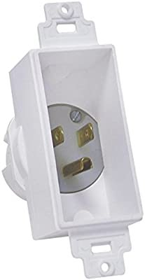

This part however I'm afraid I must condemn both on and off the books:
I don't know why they sell those male outlets!
Seriously, I thought of something else...and those male outlets are available with a cover.

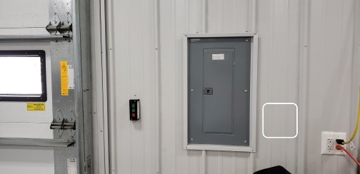

There's probably room in that panel box for one more breaker. Wire that new breaker to the male outlet, leaving that breaker OFF.
Now that outlet has no power.
When power goes off...follow these steps:
1) turn main breaker off
2) flip ALL breakers off
3) plug in and start generator
4) flip just door and generator two breakers on
5) open door
Why wouldn't that work? It's simple, easy. Now someone is going to say...well a kid could turn male outlet breaker on...then open that outlet door...then get electrocuted.
But that's true getting hurt other things in garage!
Besides...they even make locking outlet covers.

those male outlets are to be used only on circuits that have no source of power without a cord plugging into that outlet. an example would be a charger built into a dump trailer. you can NEVER hook one of those outlets into a breaker panel, period. how would you feel if some dumb, particularity stupid kid were to turn on that breaker. lets face it, there are some numb nuts out there. i was on one job where the owners kid. by kid i mean a teenager, was playing with my holehawg with a wood auger bit on it. he ended up twisting the bit up in his sweater and it took alot of work to get it unwound. luckily he didnt hurt himself. well guess what, he did it a second time about 15 minutes later. i had to kick him out of the building after telling his father. you really cant fix stupid.

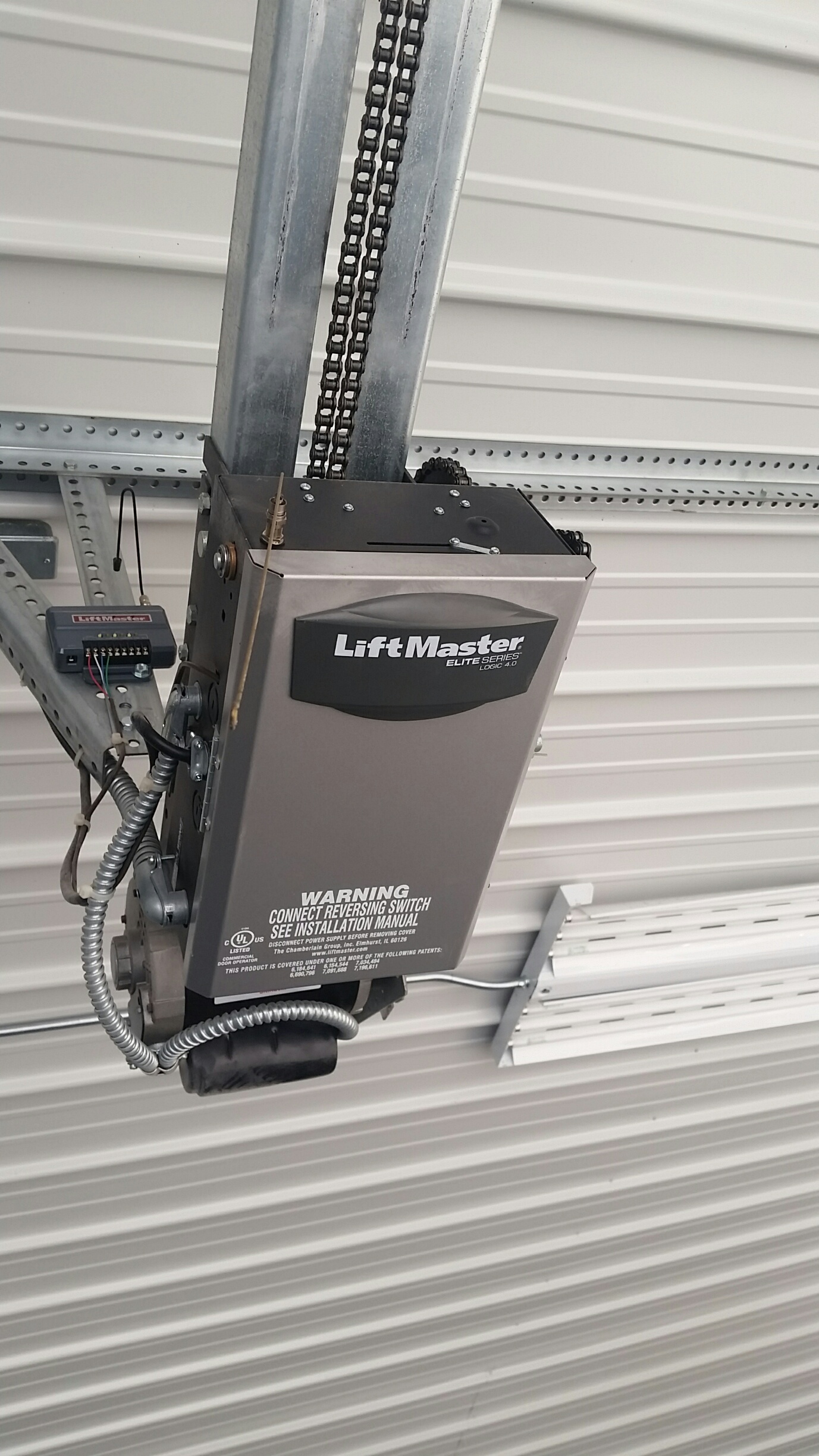

It's just a garage door opener switch? Like my little doorbell button?
Yes, just like a fancy doorbell switch but with up-stop-down buttons.

It's an easy job if you know what you are doing. Based on your questions you should be hiring an electrician. If you are worried about cost get 3 quotes and adjust your expectations.

It would work. Either with an ordinary female receptical and a dead man cable, or with that wall mounted idiot killer. Heck, he could do this with one of the existing outlets without having to do any building wiring modifications at all. Yes, very easy. All you need is to make a dead man cord.
The problem is, it's officially unsafe, and most likely illegal. If you forget to turn off that main breaker, you will backfeed power to the pole, thru the transformer, and energize the power line with 7kV. The power line where there's most likely a lineman trying to fix your power outage. That's why transfer switches are required to preclude any possibility of the generator-powered sections and line-powered sections being connected at the same time.
The requirements for transfer switches are meant to idiot proof, and what we are discussing is not idiot proof. It's one thing when an idiot kills himself, but something else entirely when an idiot kills someone else. This solution leaves the door wide open to the latter.

I've never seen ANY garage door that doesn't have a release mechanism so it can be manually opened. If yours cannot be lifted by hand there is an issue with the installation.
My release latch is higher than I can reach but I bent a simple wire that hangs down just enough to unlatch and latch it.
As far as connecting a generator goes the panel interlock with an outside plug in is the least expensive way to go. That way you can power your lights and opener from one connection.
The installers wrapped the rope from the release mechanism around the lift arm and tied in into a knot so it wouldn't get released inadvertently. They probably figured nobody is ever going to manually move such a large door. It is 12'x24' and 3" thick with 8 thermopane windows in it.
