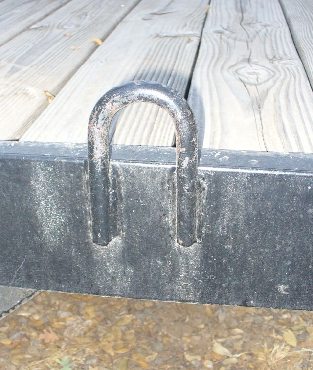

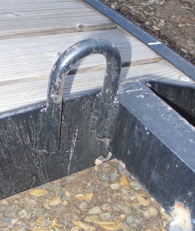

Another thought is tie down points...... I have a Carson 7000 GVW tandem axle trailer when it came there was NO REAL TIE DOWN POINTS..... Only stake pockets... I had 5/8 inch diameter steel "U" shaped loop welded to each corner of trailer because it was a real pain to put the hooks on my stripe into staker pockets and alway seemed to mess up the hook latches....... So in my thinking its not just number of securing straps/chains but also anchor points on trailer.... IT also has no battery and break away switch for electric brake's in case it got loose from tow vehicle, so I added one, but that is another story...
Excellent approach. On my larger deck-over Pequea trailer there is a perimeter rail the entire length of the trailer on both sides. That allows you to tie down anywhere along the length of the trailer and at "ideal spots." I think several good brands of trailers use the perimeter rub rail design which is hard to beat. With my smaller 14' Stagecoach brand trailer the frame about 18" above the deck is heavy pipe and (like many utility trailers) the sides are expanded metal webbing/heavy screen. SO, that allows me to use 3/8" steel cable loops any where I want them along the sides of the trailer for tie points. Each cable loop uses about a foot of cable secured using bolted U-clamp cable clamps. Rats no picture. I also use vinyl tubing covered cable to minimize rust, stab wounds from steel cable, etc. Certainly stainless cable would be nicer. These cable loops work nice with strap binders or chain or just about any binder choice.
That looks nice. U-Bolts? You can also purchase weld-on tie downs that pivot up and down.
I always like the bed to be flat so stuff can overhang a bit. Usually in front or in the rear, but occasionally I'll get a pallet that will barely overhang the side.
My trailer has a paucity of tie downs. I use the stake pockets (channel iron) quite a bit. One of my first mods on the trailer was to round all the corners of the stake pockets to be safe for ratchet straps. Ratchet straps can also simply hook over the channel iron.
Everything (including my winch) gets chain hooks, so no hook latches. I usually pull enough chain through the pocket to hook the chain back onto itself. My tractor bucket also has chain hooks welded to it, but unfortunately the shape was wrong and they're a pain to use (probably cut down chain hooks). I need to cut them off someday and put weld on type hooks.
