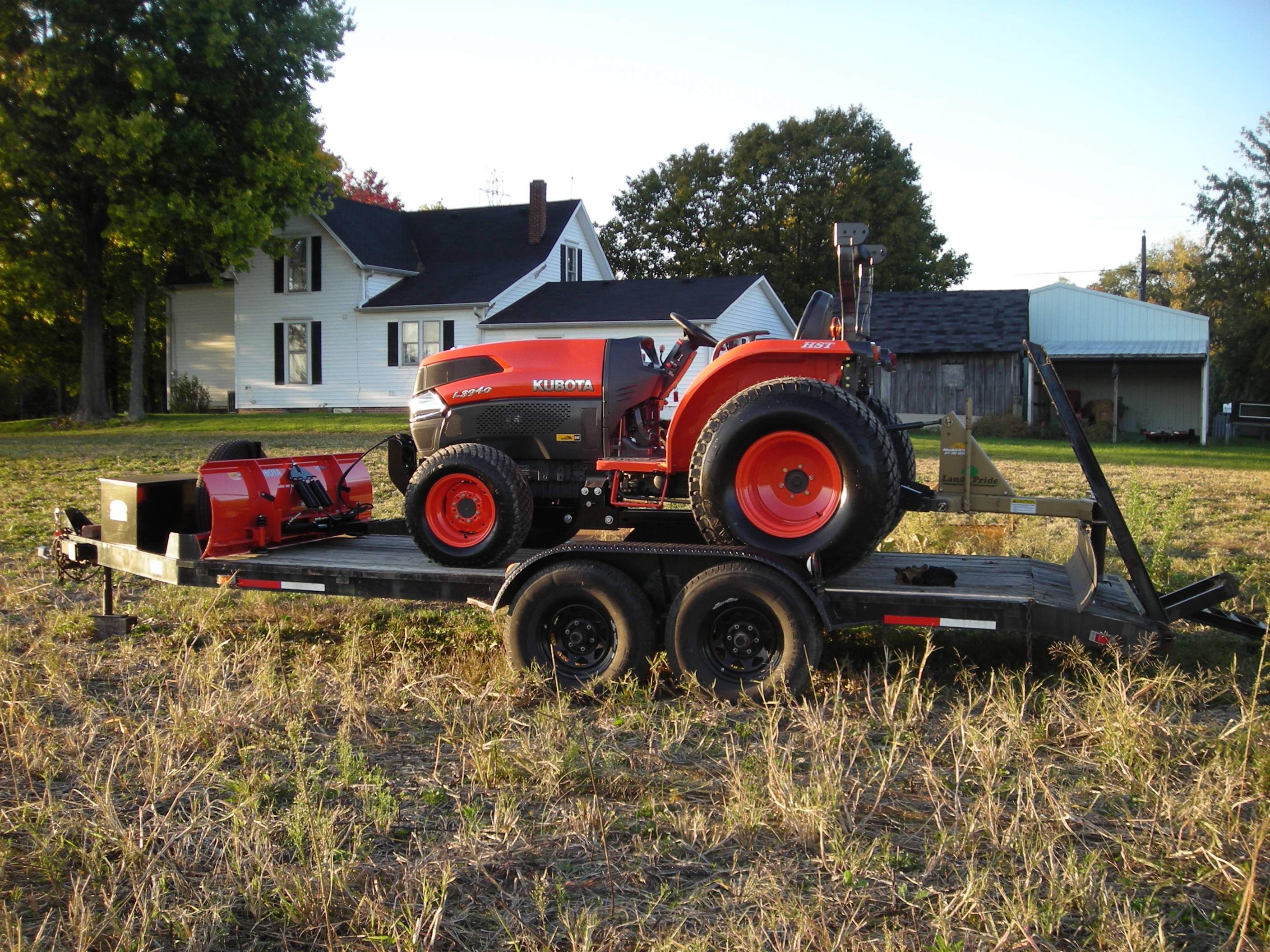

Here is a 16' + 2' bearver tail and an L3940. I cannot haul tractor and 6' bushhog at same time. Philip.

My 16' (deck) is fine for hauling a 100 bales of hay but not so useful if the FEL and bushog are on. Pulverizer or finish mower are a bit shorter. If I really used the trailer more for moving the tractor I would be looking at a 20' trailer.
