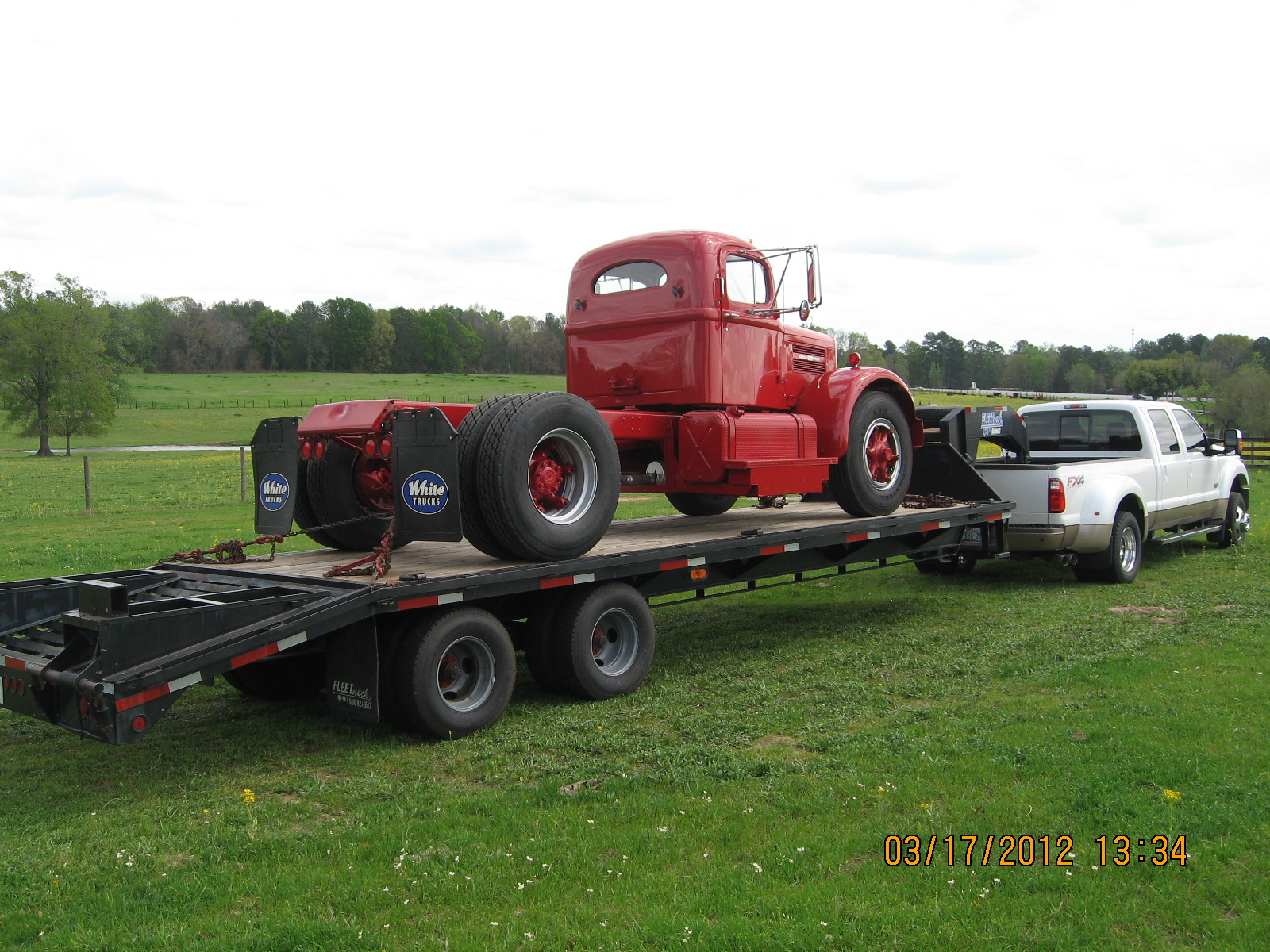

About five years ago I removed the floor and had my flatbed gooseneck sandblasted inside and out. I primed with Rustoeum rusty metal primer and then painted with black Industrial Rustoleum. Bought the paint from Lowe's. It's held up very well and except for the expense of sandblasting didn't cost a lot to paint the trailer. Here's a recent picture of the trailer. I may repaint this spring but this time I'm going to paint it smoke grey.
Was the paint from a spray gun or a can?
/ Trailer Repaint On the Cheap? #18
I bought the paint in gallon buckets and used a spray gun. The industrial rusoleum is thinned with acetone. I primed and painted inside and outside before I installed a new floor. The Rustoleum has held up well, no chips or flaking. It's weathered some but not as bad as I expected.
