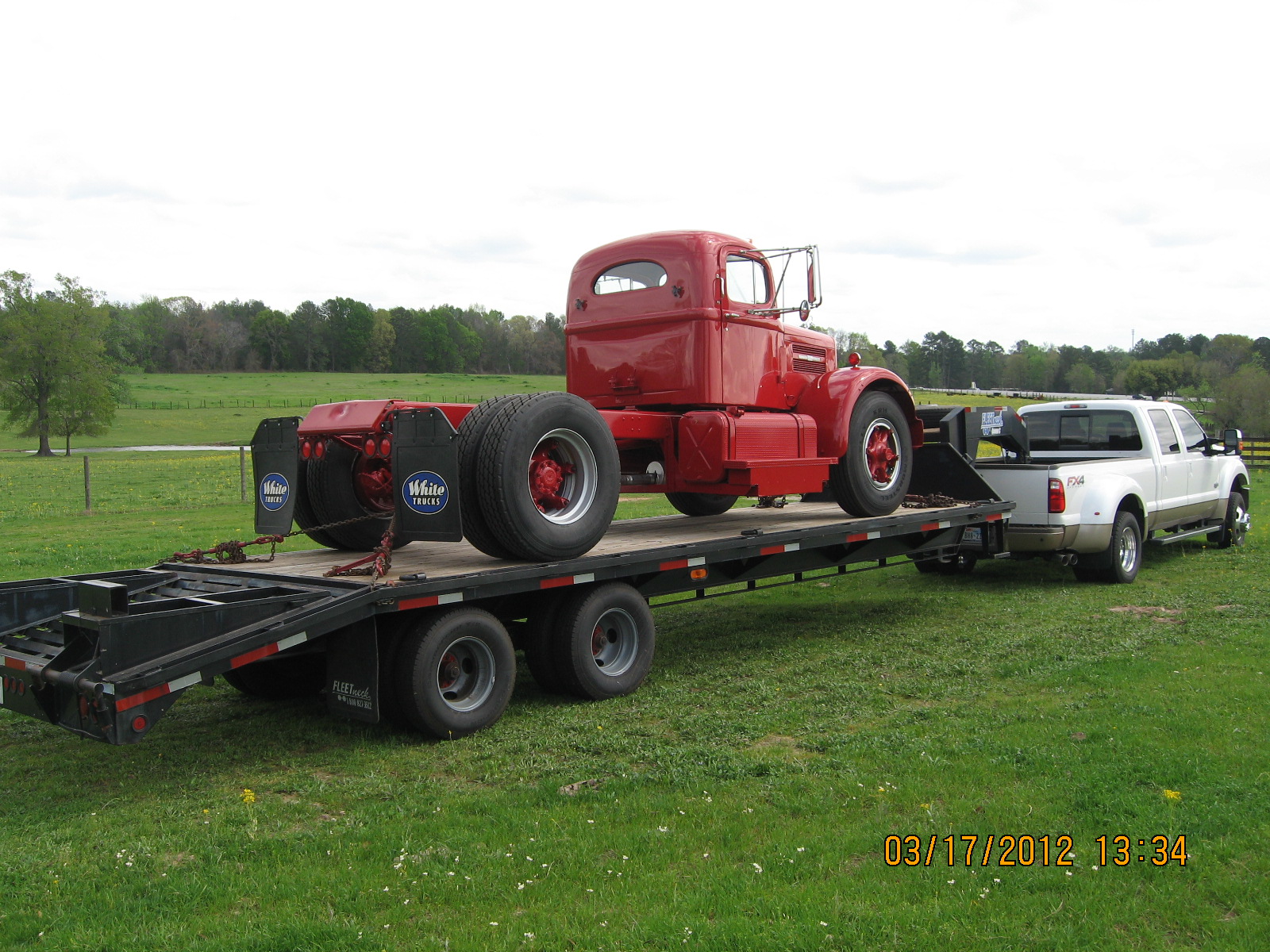

I have three trailers that need repainting. My 20' low boy gooseneck, my 12ft utility, and my 16ft utility. All the paint on them is badly deteriorated... Funny timing, I just looked on craigslist last night and found two different people that sand blast and paint in my area. I emailed them last night.
I used to do sandblasting and painting 25 years ago (a lot of horse trailers), but do not have a place where I can blast and paint anymore. 25 years ago I used PPG DP40 two part epoxy primer. It has a metal etching chemical built into the paint. I am not sure if this is still the best epoxy primer? of if there is now a better primer? Anyway, I intend to have the trailers blasted and epoxy primed then painted with a nice single stage automotive acrylic enamel with hardner in it to match my truck.
I am not impressed with Valspar.. so far the spray can Valspar- new kubota orange fades very quickly to a pink color...I am not sure about their implement paint, is it really epoxy? I will have to check next time I am in Tractor Supply.
