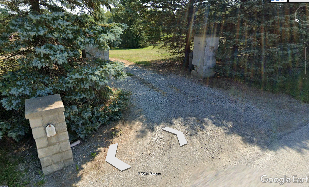

If it involves a 90° turn a BP of equal length will do it in a tighter area. If its a 180° turn the GN will win with the ability to jacknife.
Its not even a debate. There is only one right answer.

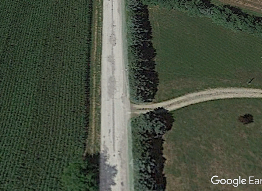

This is a driveway I CANNOT get a GN into. The drive is too narrow and the road isnt wide enough to not have the GN axles stay on the drive. And its a 3' deep ditch on the opposite side and its a narrow country road
While challenging, this driveway is doable with a BP due to its nature to follow the tow vehicle better rather than cut corners and end up wrapped around a concrete pillar.
Its clear you dont believe me, thats fine. You are entitled to your incorrect opinion.
